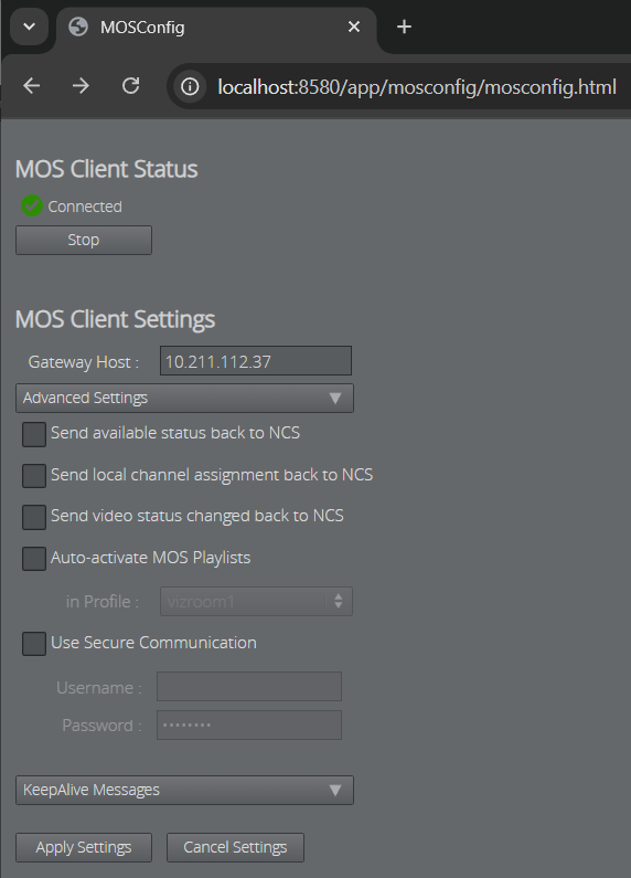

On the Control Station which runs the Media Sequencer, open the following page in a Web Browser: http://localhost:8580/app/mosconfig/mosconfig.html.

MOS Client Status
In this scenario, the MOS client is the Media Sequencer. The MOS client must be configured to communicate via the MOS protocol with a Gateway.
  • MOS Client Status shows whether the Media Sequencer is able to connect to the Gateway.
  • You can also Start and Stop the local client.

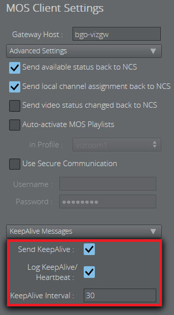

  • KeepAlive Messages: Maintains the connection and prevents firewalls from closing idle connections. A drop-down menu in which internal keepAlive can be configured. If enabled, the Media Sequencer sends periodically keepAlive messages to the connected Gateway.

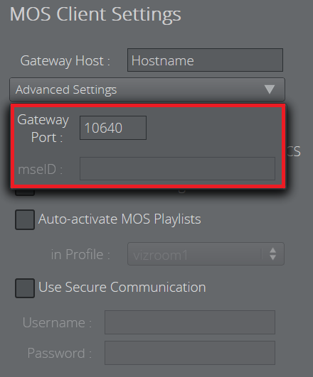

Connecting a MOS client to the Gateway over TCP uses port 10640 by default. This could be changed using the Advanced Settings drop-down menu, as shown below.

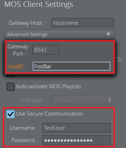

Since MOS version 4.0.0, it is possible to connect a MOS client to the Gateway using a websocket secure connection. For this, User Secure Communication must be activated. This setting additionally requires a username and a password for establishing a connection, which can be entered in the two corresponding input fields below.
As shown in the Advanced Settings drop-down menu, port 8543 is used by default for websocket secure connections. This setting, however, can be overwritten using the corresponding text field. Such secure connections, furthermore, require a unique MSE ID. By default, the hostname of the machine on which the MOS client runs is used, but the same Advanced Settings drop-down menu could be used to also overwrite this default setting.
KeepAlive Messages
This drop-down menu can be used to configure internal keepAlive, which are periodically sent from the Media Sequencer to the Gateway. These messages help maintain the connection and prevent firewalls from closing idle connections. The following options are available:
  • Send KeepAlive: Enables or disables the sending of keepAlive messages.
  • Log KeepAlive/Heartbeat: Enables logging of keepAlive and Heartbeat message.
  • KeepAlive Interval: Specifies the interval (in seconds) between keepAlive messages.
These settings help ensure active connections and provide monitoring capabilities for message activity.
