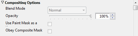

Each layer provides compositing options to allow you to specify how the layer is combined with the other layers in the project, and its opacity.
  1. Select the layer in the Layers list, and click the Properties tab to display the Properties panel for the layer.
  2. Click the right arrow button to the left of the Compositing Options heading to display the compositing options for the layer:
Blend Mode specifies how the layer is combined with the other layers, and can be one of:
Normal, Add, Subtract, Difference, Multiply, Darken Only, Burn, Color Burn, Screen, Lighten Only, Dodge, Color Dodge, Hue, Saturation, Value, Color, Overlay, Soft Light, Hard Light, Pin Light, Exclusion, or Negation.
The Opacity determines the layer opacity, and can be animated.
Use Paint Mask as a Key (image layers only) and Obey Composite Mask are equivalent to the same options in the Composite Mask dialog box; see below.

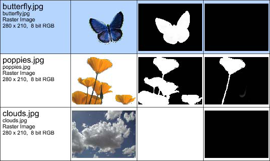

To Make an Image Go behind Selected Features in a Scene
The following example illustrates one of the most powerful uses of layer compositing to control how one image interacts with components of another image. In this example, we use composite masks to make a butterfly go behind the front most poppy in an image of several poppies.
In this example, both the images have alpha channels, to allow a background image to show through. The first step is to create a mask defining the foreground image; in this case the front most poppy:
This can be done using the mask extract tools on the Mask panel, followed by painting on the mask using the brushes on the Brushes panel.
  1. Load the butterfly image, and create a mask for the butterfly.
  2. Position the butterfly layer above the poppies image.
  3. Load the clouds image, and move it to the bottom of the Layers list. The composite image reflects the order of the individual images in the Layers list:
    You can view the components of the project in the Content Manager:
  4. Click the mask icon, to the right of the layer name on the poppies image layer in the Layers list, and select Create new Composite mask:
  5. Likewise, click the mask icon for the butterfly layer and select Obey the Composite Mask:
The composite mask is a copy of the mask on the poppies layer. This can then be used to protect the front most poppy from change by layers above. Since the butterfly is composited obeying the composite mask, the effect is that the area of the butterfly corresponding to the front most poppy is masked out, so the butterfly appears to go behind the poppy:
The Composite Mask options can be animated, so a butterfly could be made to fly behind the poppy in one part of the movie, and in front of the poppy in another part of the movie.
