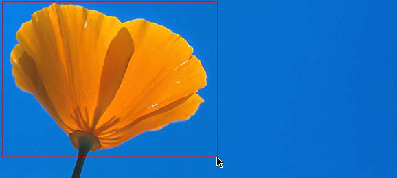

  4. Drag to draw a rectangle defining the size of the cutout you want to create:

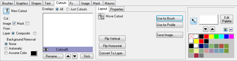

    The cutout is displayed in the Overlay list on the Cutouts panel:

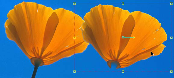

  5. You can then drag the cutout to displace it from the original image, or display it on another layer:

  4. Drag to draw a rectangle defining the size of the cutout you want to create, enclosing the image:
    The Move Cutout tool is automatically selected so you can drag the cutout to see it independently of the original image:
    The cutout is available to any other layers in the project:

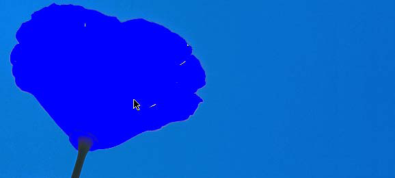

    Display Mask is automatically selected in the paint controls to show the mask when you create it.
  2. Click the feature you want to mask. If necessary, adjust the Tolerance control and click again with the Magic Wand tool until the feature is completely masked:
  3. On the Cutouts panel select Cut: Image and Cut: Mask.
  4. Select the New Cutout tool.
