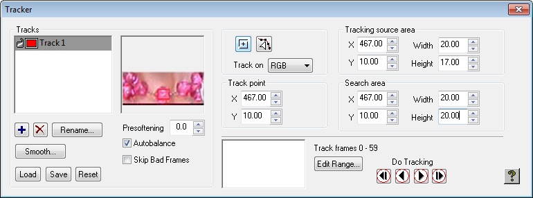

To Create a Track
  1. Click the + button to create a new track, and select it in the Tracks list.
  2. Click the Edit Tracks button to indicate which feature of the image you want to track:

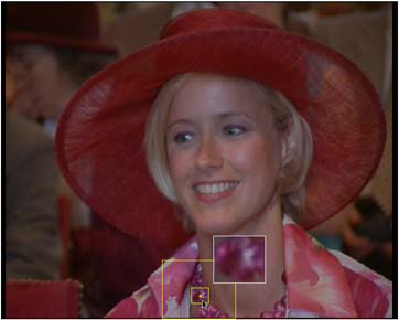

    Two concentric squares are drawn in the Viewer with a + at their center.
  3. Move the mouse pointer over the center square until it changes to a move symbol and drag the squares over the feature you want to track.
  4. The center square acts as a magnifying glass to help you locate the feature accurately:
  5. If necessary move the central + to the precise position you want to track. This is the pin position that determines the precise offset generated by the track. Usually, you leave this at the center of the inner square. The outer square determines the search area that the tracking tool scans at each frame when looking for the feature you have specified. Its size should be sufficient to cover the maximum movement in any direction from any frame in the sequence to the next frame. It does not need to cover the area occupied by the feature of interest throughout the whole sequence.
  6. Adjust the Presoften value to blur the image before matching the target; this helps tracking if the image is noisy, or includes a random feature such the rain.

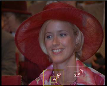

  1. Click the Track Next Frame button to step forward a frame at a time, tracking the feature.
  2. Click the Track Forward button to start automatically tracking the feature from the current frame.
As tracking proceeds the Tracker dialog box plots a graph showing the quality of the track:
Higher values indicate a good match.
The tracking paths are shown in the Viewer as a white line with red dots at each track position:
