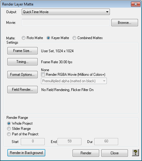

To Render the Keyer Matte
  • Click the Render Matte... button in the paint controls.
This is equivalent to the Render Matte... command on the Layer menu, and displays the Render Layer Matte dialog box to allow you to render the Keyer matte and/or the roto matte as a separate movie.

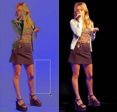

  5. Select the Pick Background tool and drag to define a rectangle enclosing the blue-screen background:
When you release the mouse button the keyed image is displayed.
You can refine the keyed area by clicking or dragging with the Pick Background tool to increase the areas of background removed, or by clicking or dragging with the Pick Foreground tool to reduce the areas of background removed.
Alternatively you can adjust the key using the color, chrominance, or luminance sliders.

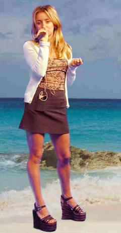

You can then superimpose the subject onto an alternative background:
