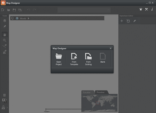

To Create a Map Template
  1. Start the Map Designer.
  2. Select one of the following options:
    • Open Project: Opens an existing project.
    • From Template: Starts a new project based on a selection of default stylesheets.
    • From Existing: Starts a new project based on an existing project.
    • Blank: Starts a new project.
