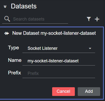

  1. Create a new dataset of type Socket Listener, specifying a name and (optionally) a prefix to use to identify the dataset and its values:

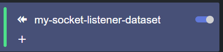

  2. Click Add. The dataset is added to the list, and it has an initial OK status as its default protocol is UDP, for which is impossible to establish whether a connection to the socket has been made. However, in case another existing dataset is using the same default port (6000), then the newly added dataset is in an initial ERROR state.

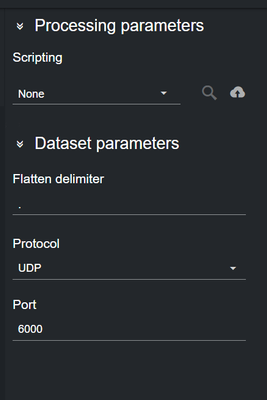

  3. You can now configure the dataset in the Dataset parameters section panel by double clicking a row. Here you can specify a Protocol and a Port to start receiving data.

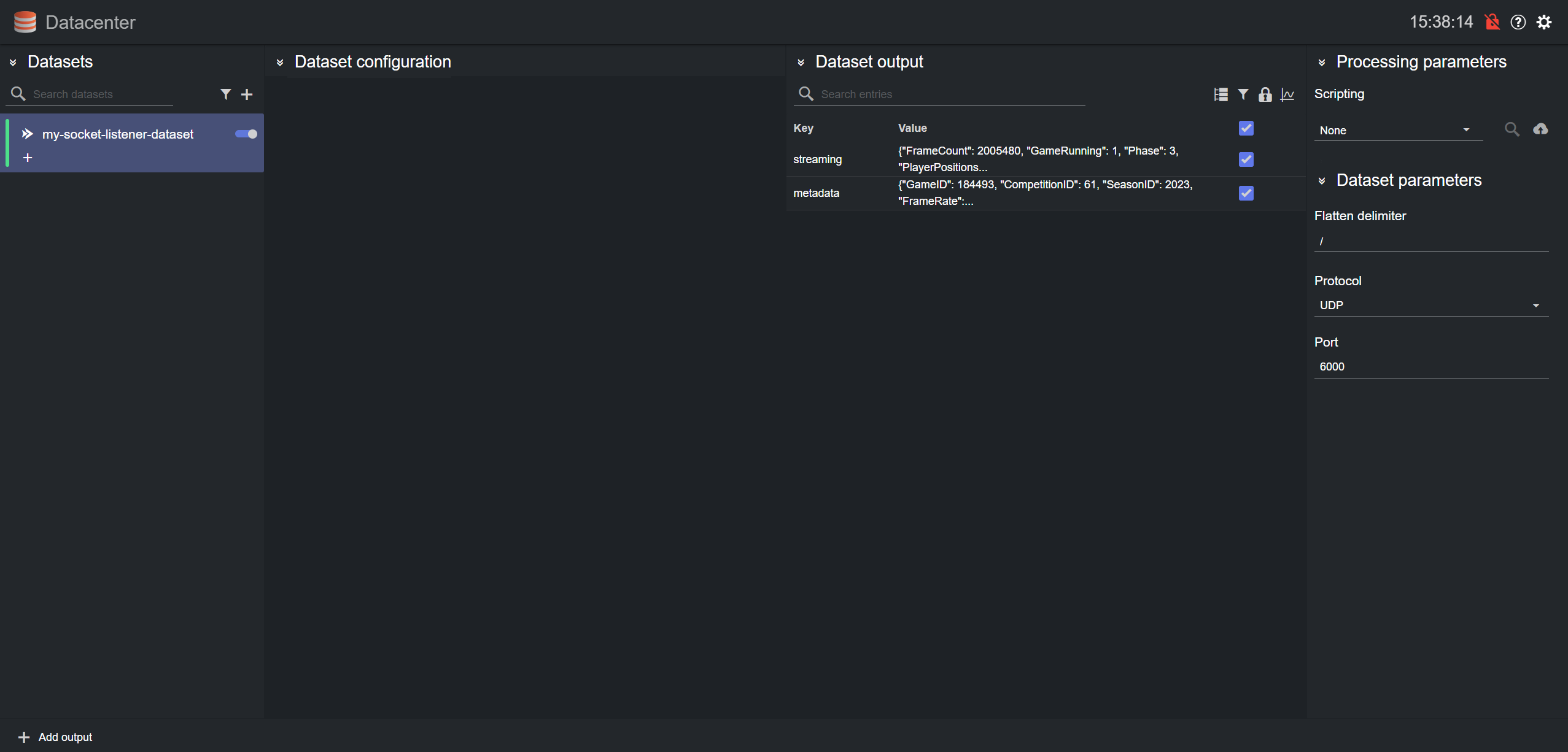

  5. Given that the dataset is in an OK state, as soon as Datacenter receives data, the corresponding entries are added to the Dataset Entries table.
Please refer to the Filtering and Manipulating a Dataset Entries page to learn how to enable, disable and edit the entries added.
