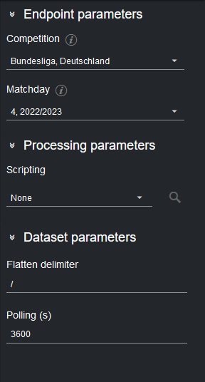

Once an endpoint is added to a dataset, you can select the endpoint card. This reveals the Endpoint parameters panel on the right side, where its properties can be entered. You can now edit the endpoint configuration (Competition and Matchday, as shown in the image below):
To change the polling rate (how often the Sportec Solutions remote host is polled for data, in s) for the dataset, select a card from the list and edit the Polling field in the Dataset parameters on the right-most column.

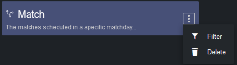

Filtering a Dataset
Values read from a file into a dataset can be filtered via the Filtering tool. To do so, select the dataset card, click on the hamburger menu and then press the Filter button.

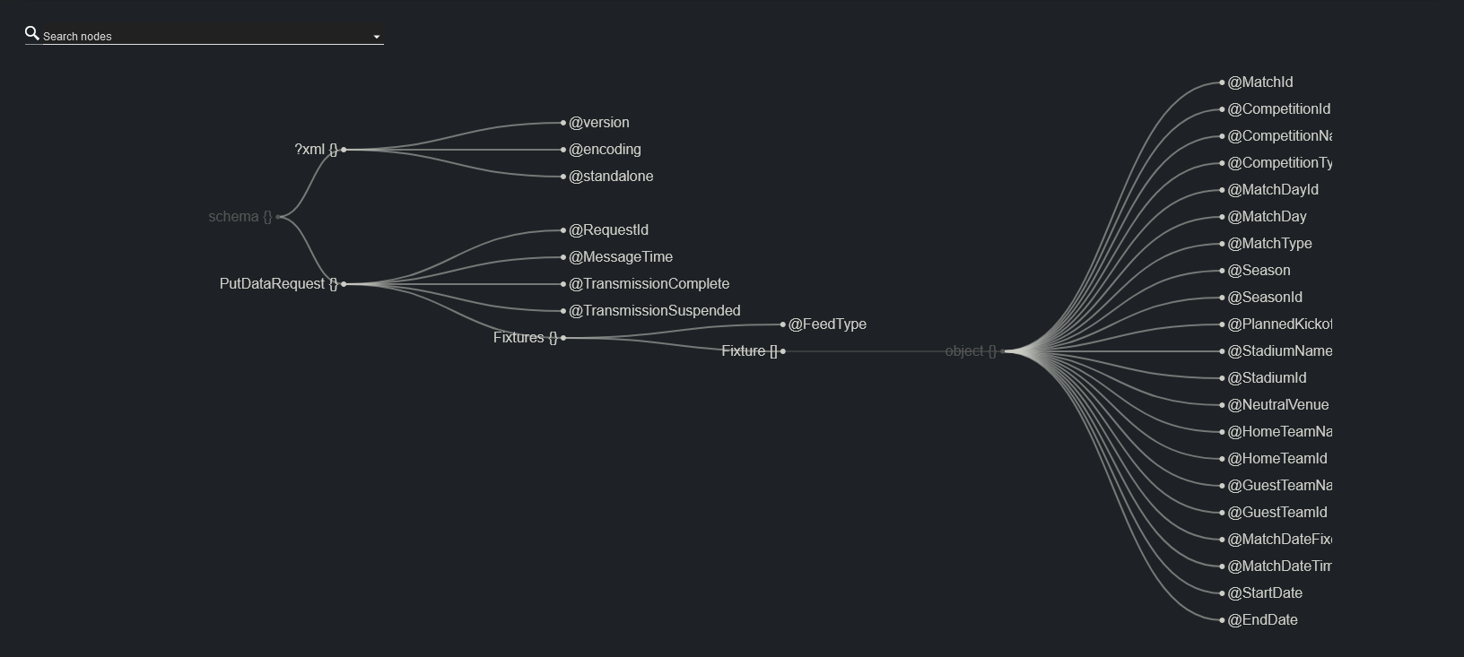

A dialog visualizing the file's payload schema opens, where you can filter the source data.
