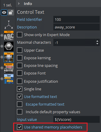

To enable live data input from Datacenter:
  1. Open the scene in Viz Artist.
  2. Locate the control plugin for the field that should receive live input.

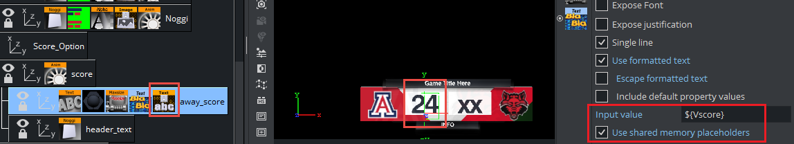

  3. Check Use shared memory placeholders. Note that this enables listening for shared memory in the System (Global) memory map.
  4. Set the Input value field to the key of the Datacenter dataset entry that should update this object, using the ${KEY_NAME} syntax (in the example above the value would be updated with a dataset entry with key Vscore).
  5. Save the scene.

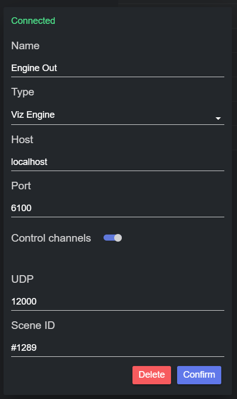

Control channels communication must be enabled on each Viz Engine output that uses it. To do so, click on the output you want to send data to and enable the Control channels toggle.
Scene ID Fetching: Make sure the scene is loaded in Viz Artist before connecting to Viz Engine, as the Output automatically fetches the Scene ID of the main scene. Should there be an error reported in the Scene ID field, or should you change the scene in Viz Artist after having connected to it, please temporarily disable and re-enable the output to force a new scene ID fetch.

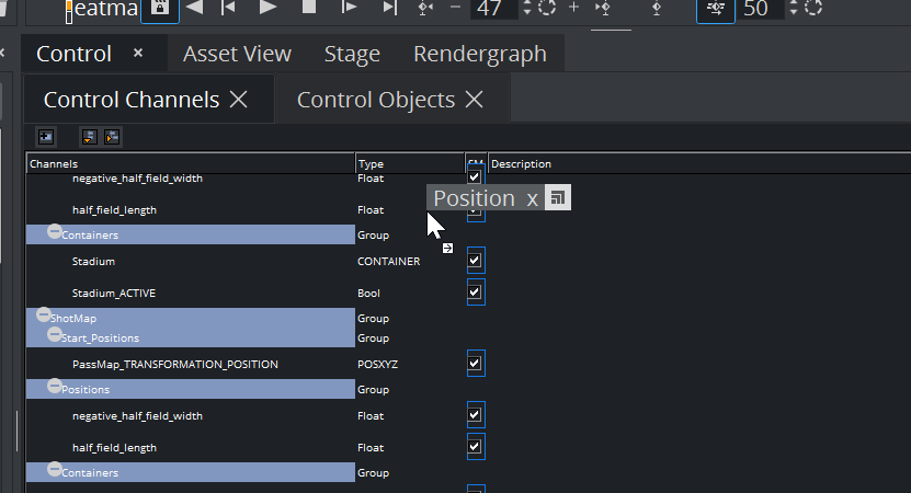

Then, to enable live data input from Datacenter:
  2. Locate the container that should receive live input, and the container field that should be updated with data from the Datacenter.

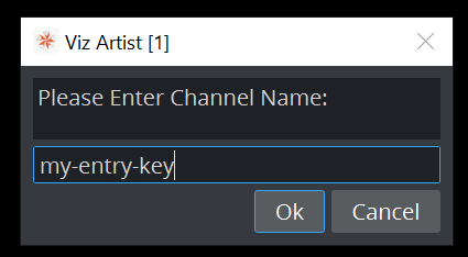

  3. Drag the field in the Control Channels panel of Viz Artist.
  4. In the dialog that appears, set the Control Channel name to the key of the dataset entry that should update this object (in the example below the value would be updated with a dataset entry with key my-entry-key).
  5. Make sure to enable the control channel by clicking on the SM column.

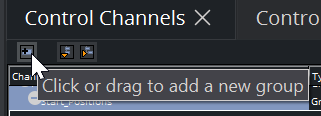

Control Channel Groups: Control channels in Viz Engine can be organized in Groups. Groups can be created using the image-20241004-102713.png icon in the Control channels panels.
To access a control channel inside a group one must use the '.' delimiter. For example, the my-entry-key channel in the example below can be accessed using the following SHM key: Containers.my-entry-key.
This property is particularly useful when flattening data in a Datacenter dataset. By setting the flattening delimiter to '.', one can organize the control channels to reflect the flattened data structure.
