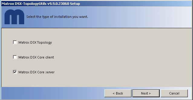

Steps for Installing the Server Machine
Obtain the dongle and the licenses file from Matrox.
Install DSX-TopologyUtils.exe application.
Choose Matrox DSX Core server during installation.

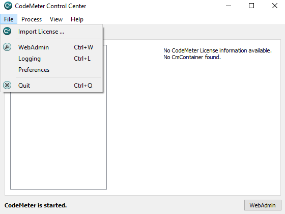

After installation, the CodeMeter Control Center is installed and located in the taskbar.
Import the licenses provided by Matrox using the application.

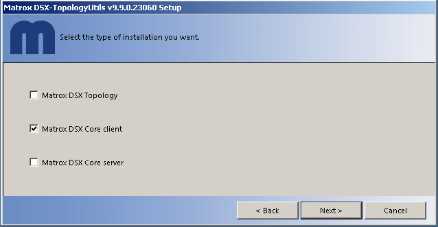

Steps for Installing the Client Machine
Install DSX-TopologyUtils.exe application which usually ships with DSX.utils.exe.
Warning: DSX.utils.exe must be uninstalled first before installing DSX-TopologyUtils.exe!
Choose Matrox DSX Core client during installation.

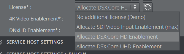

The DSX core licenses need to be acquired by Channel Recorder. This can be either a HD or a UHD license.

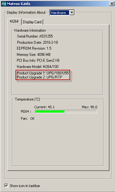

M264
For recording, the board needs the upgrades UPG/100/U55 and UPG/RTP.

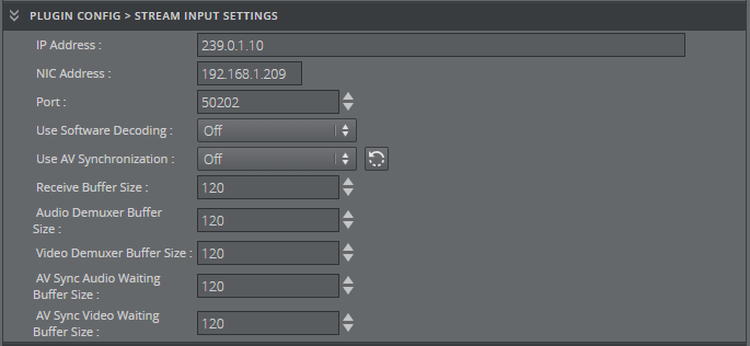

Configuring Channel Recorder
When using M264 with another Matrox board, the board must be chosen in the configuration by specifying its serial number.
The most important parameters for receiving RTP/H264 streams are the IP Address, NIC Address and Port. The connector setting still needs to be specified. Any value without space will do.
