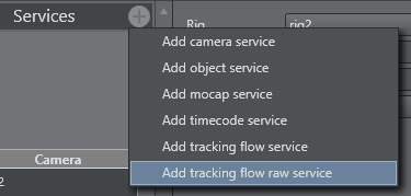

To Activate Monitoring

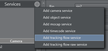

To be able to see the tracking data values in the Data Flow Inspector, a service must be set up which forwards the packages.

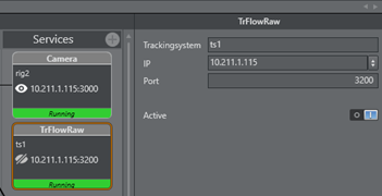

Raw Data
A new tracking flow raw service needs to be added.
Trackingsystem: Name of the tracking system node which should be monitored.
IP: IP address of the machine where the data flow inspector is running (typically the local machine address).
Port: Default Port is set to 3200.
Active: Turns service on or off.

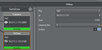

Rig Data (Final Transformation)
A new tracking flow service needs to be added.
Rig: Name of the rig node which should be monitored.
Port: Default Port is set to 3100, can be changed in the Data Flow Inspector.
Camera No.: Camera ID of the virtual camera.

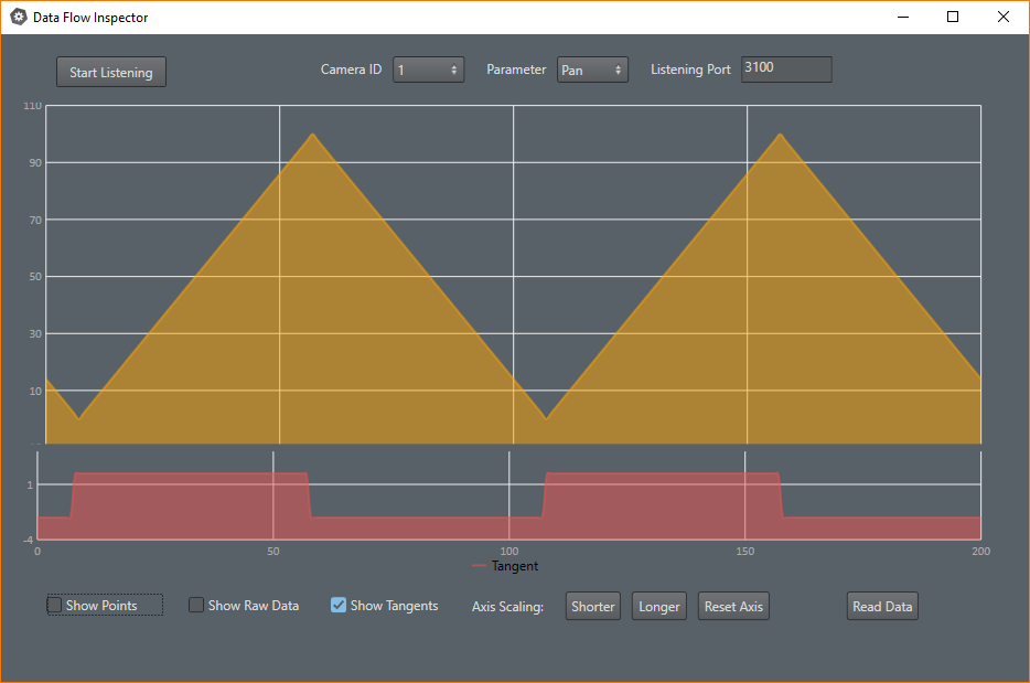

After the services are running the Data Flow Inspector can be started.
Start Listening: Starts receiving incoming tracking data. As soon as data is detected, it is added to the graph.
Stop Listening: Stops receiving data.
Camera ID: Sets the ID for the virtual camera used for receiving data. This especially is needed when multiple data packages are send to the same recipient.

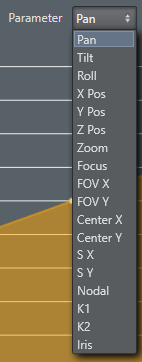

Parameter: Defines which parameter of the tracking data should be prompted on the graph.
Tracking Flow Inspector supports 18 different parameters sent from Tracking Hub to Engines.
Information: Raw data values do not support all 18 parameters. Available options are: Pan, Tilt, Roll, PosX, PosY, PosZ, Zoom and Focus.

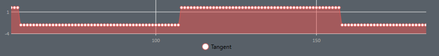

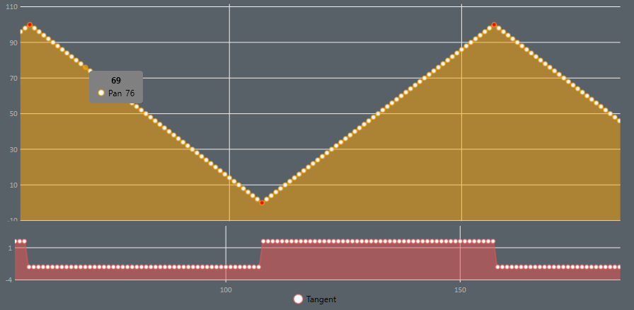

Tangent Curve
The tangent curve represents the slope between every point. Strong changes within this curve indicate that the difference between points is high and therefore probably not following smooth and realistic values. This curve can be enabled/disabled on the bottom menu.
Below is an example of tracking data coming in in a perfect ramp, the tangent clearly shows the change in direction of the tracking data values.
Axis Scaling
The scaling of the axis can be changed to give a better overview of the currently represented data. the button menu at the bottom defines the amount of data packets recorded by the graph at a time.
By default, 200 packets (data values) are represented in the graph.
Shorter: Decreases axis scaling range.
Longer: Increases axis scaling range.
Reset Axis: Resets the axis scaling range to default (200 packets).

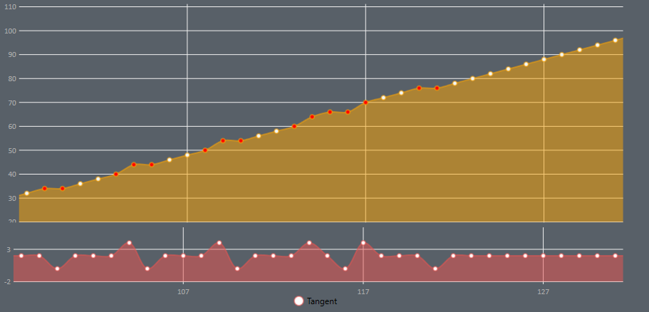

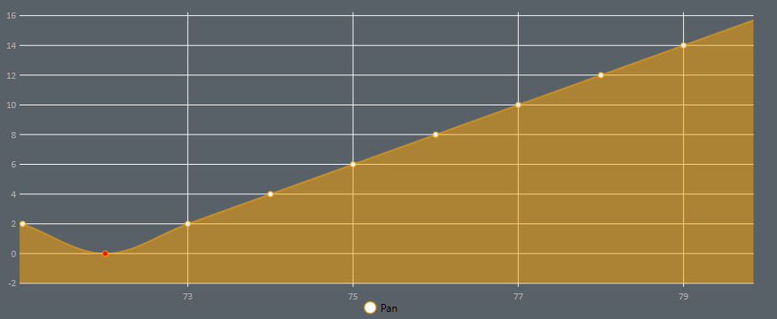

Show Points: Draws the points onto the graph for reading the precise value. Having to many points drawn (longer axis range) results in slowing down the graph.
Red Points do indicate possible errors in the data. This means that the average difference between two following points is probably too high.
Warning: Red points are intended as a help and do not show definite errors. While a strong change in direction between points is highly unlikely, it is no guarantee that the packet is actually wrong.
