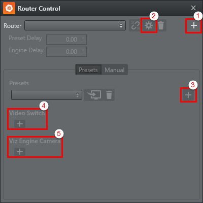

To Add a Router Control Preset
  1. Open the Tools menu and select Router Control.
  2. In the dialogue window that opens, select a Model and enter a Name for the router, then click Add. The selected model defines the communication protocol which is used, and is not vendor dependent. The available protocols are:
    • Black Magic (network)
    • Nevion MRP (network)
    • Nevion NCB (serial)
  3. Click the plus icon (+) in the upper right corner to add a router (1). If a router has been added to the system previously, it can be reused by selecting it from the Router drop-down list.
  4. Click the cogwheel icon to configure the connection settings and AB mode for the router (2).

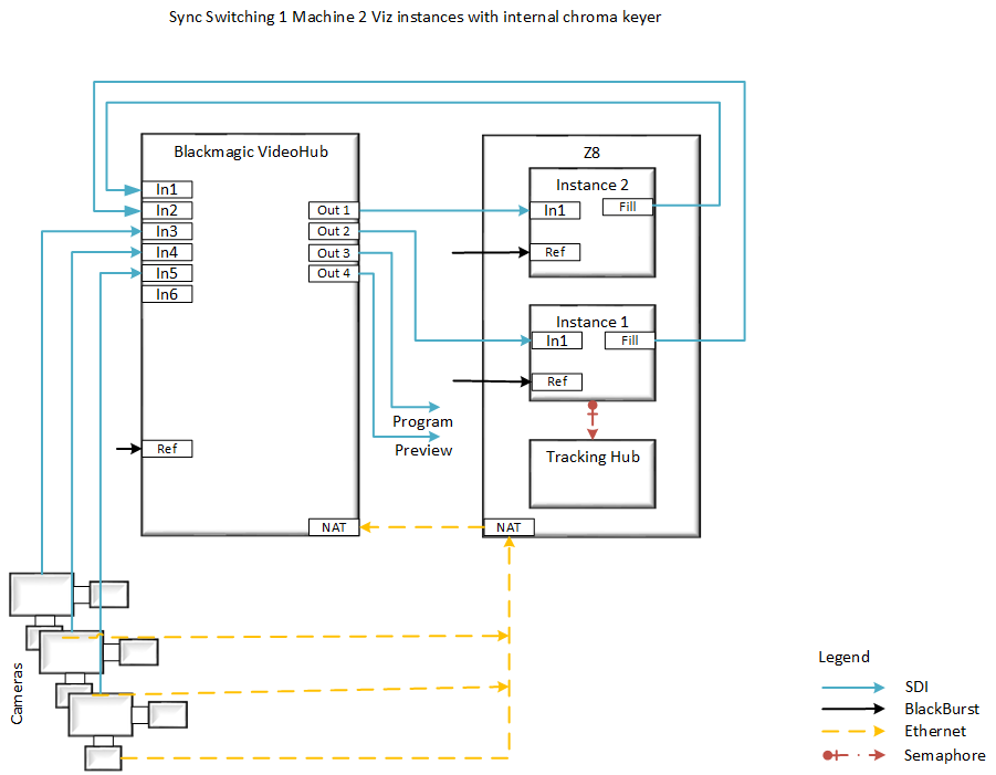

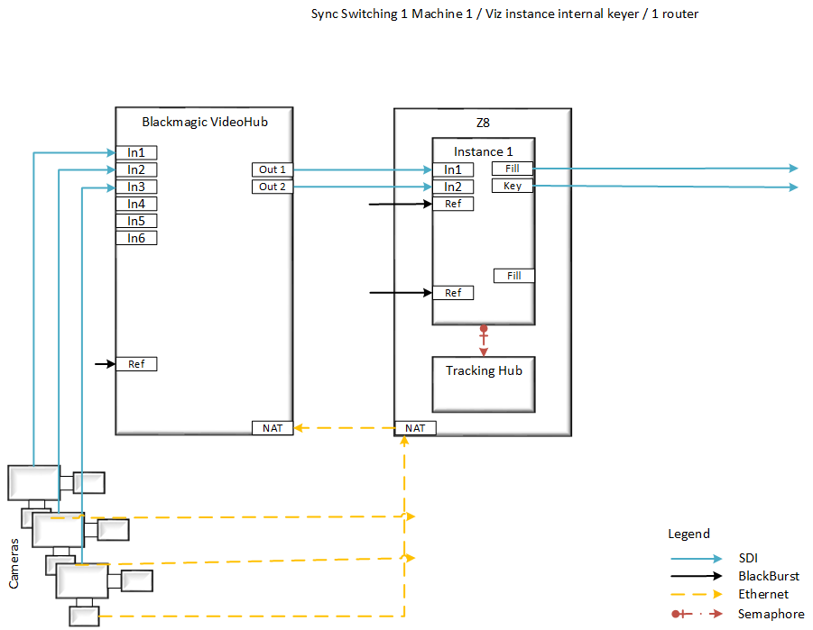

    • No Mode selection: If no mode is selected, Tracking Hub changes the switch points on the router with no internal logic. The following diagram shows a "one machine with two Engine instances and internal keyer" solution which implements a program / preview setup. The two instances hold the same scene. When switching a camera is intended, first the camera on the engine and the video going into the preview engine is switched. When all signals are stable and the camera is switched, the roles of the Engines are modified by changing the signals on Out 3 and Out 4. Therefore, the preview and program role of the Engines change with every switch.
    • AB Mode: AB mode is used to deal with situations with unreliable router switching times. When running in AB mode, two SDI cables are connected from the router to the Viz Engine inputs. Upon switching, the router first switches the signal to the unused line. If the signal is valid, the command to switch the input and camera is sent to the Engine. This way, the output from Viz Engine is not interrupted even if the router switching has a slight delay. This mode can be used, when the video is whether linear keyed from the background or chroma keyed with one of the internal Chroma Keyers of Viz.

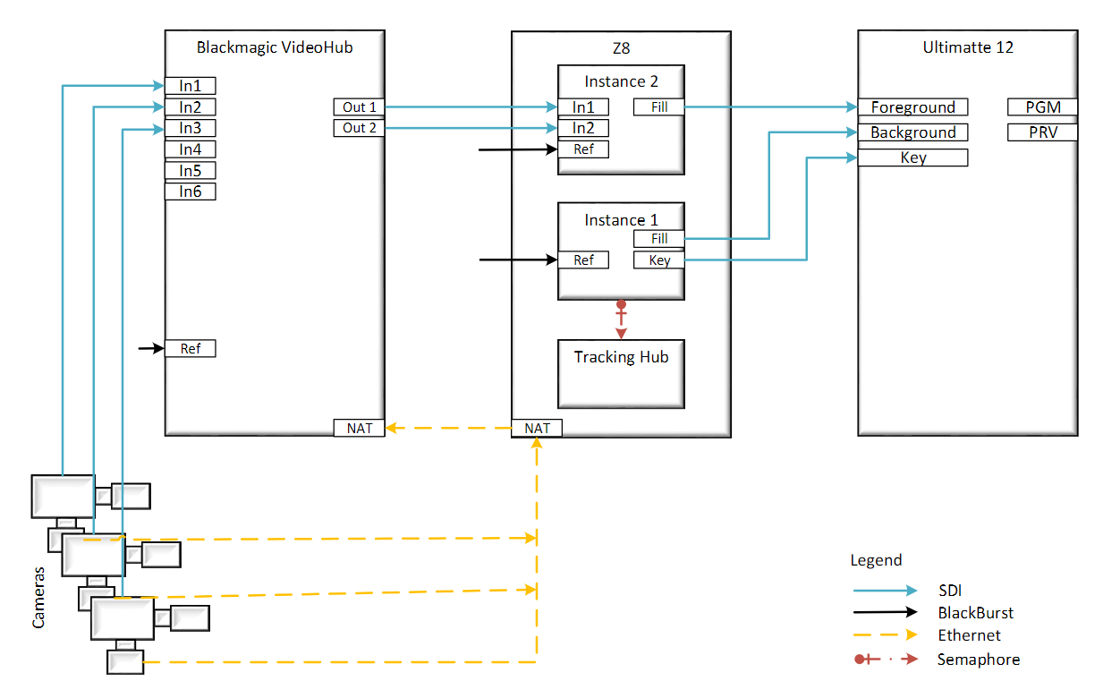

    • Dual Engine: Dual Engine mode is used, when ONE and only ONE physical Engine machine should handle multiple cameras with a switcher. In the last few years, it became more difficult to find cheap routers which are able to switch with predictable timing. The method described here makes it possible to use the already implemented A/B mode in Tracking Hub with an external keyer, like the Ultimatte 12. The goal is to create a low cost virtual set with an arbitrary number of cameras with a one machine solution.
      On this machine (preferably a Z8 with an x.mio3 and two graphics adapters) a dual Engine is installed with a Tracking Hub. Let’s also assume, that a BlackMagic Video Hub (or any other cheap router) and an Ultimatte 12 are present. In this scenario, the Video Hub is connected via Ethernet to the VSS machine. In Tracking Hub, a new switching method is added to the existing A/B mode. In this mode, the user can enter the IP and port of the first and second instance of the Engines. The router is managed by the selected protocol driver.
      When selecting this mode, the following steps occur:
      Tracking Hub takes over instance two and generates a basic scene with two inputs by using the command interface. Using this method ensures that instance two, which is responsible for the synchronized switching, is in place and ready. Tracking Hub also checks if the instance is present and On Air, that all inputs are enabled and that the sync source is set and the instance is locked.
      Tracking Hub contacts the video hub and make sure that it is reacting.
      Then the user is able to enter any amount of presets in the matrix controls of Tracking Hub. Switching can, like before, happen by GPI, commands or any future interface.
      In case of switching the following occurs:
      Status: Tracking Hub knows the actual status of the active output of instance two. There is always an active and inactive input present on instance two.
      When a new camera is activated by a preset, Tracking Hub commands the router to switch this video feed to the inactive input of instance two. After that Tracking Hub waits a defined (by user) timespan, until the signal is stable switched and valid on the Matrox input. If necessary, Tracking Hub can check if everything is OK at the Engine by command interface, and no error messages are coming in.
      After that period, Tracking Hub triggers a synchronized command to instance one and instance two (with the necessary delays) to switch camera on one and video on instance two.
      This workflow can then be repeated an unlimited number of times.

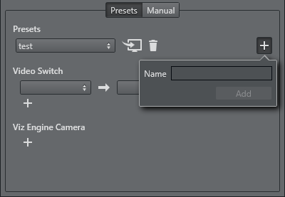

  6. Next, click the plus icon (+) to the right in the Preset section to add a preset (3). Enter a Name and click Add.

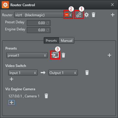

A router connection with a preset has now been configured, and the Router Control window should look like this:
Click the Connect button (1) to connect to the configured router. If there is a connection problem, this is indicated by a red warning box in the Router drop-down list (2). To issue the take command to the router and Engine, click the Take button (3).

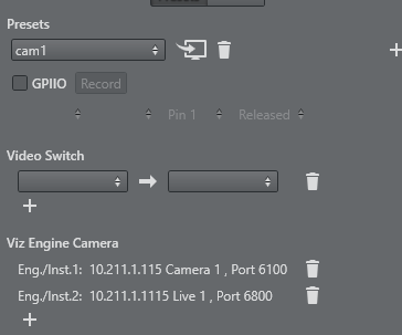

When using DualEngine mode:
The first Engine is the Renderer, and the Engine camera is switched on this instance. The second Engine is the Video instance, and the video is switched on that. In the picture above you can see, that Engine one is Titled as Camera Nr. while Engine two is marked as Live Nr.. In Dual Engine mode, it only makes sense to configure two Engines. Please note that in the Engine instance settings, the field Port has been added!
By default the port for instance one is: 6100 and the port for instance two is: 6800. But this settings can differ from installation to installation. Please check the Engine configuration for the correct port settings.

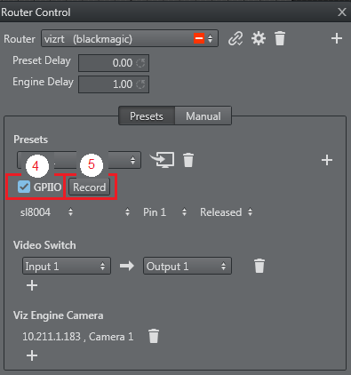

GPI IO Device Switching
In addition to the standard configuration, you can add a GPI IO device for switching (4). You can select this device if it was detected during startup. This detection is done automatically.
To configure the device, you have two options:
  • Manual: Select the device, the port (not available for all devices), and the pin. In addition, you can select if the switching should react on pressing or releasing the button.
  • Automatic: Click Record (5) and then select the button on the GPI IO device. The button is recorded and connected to the actual preset.
