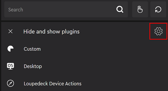

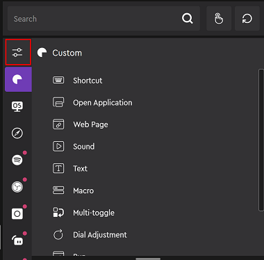

After installation, go to the Plugins Settings menu.
Click on the gearbox to open the Add-on Manager window.

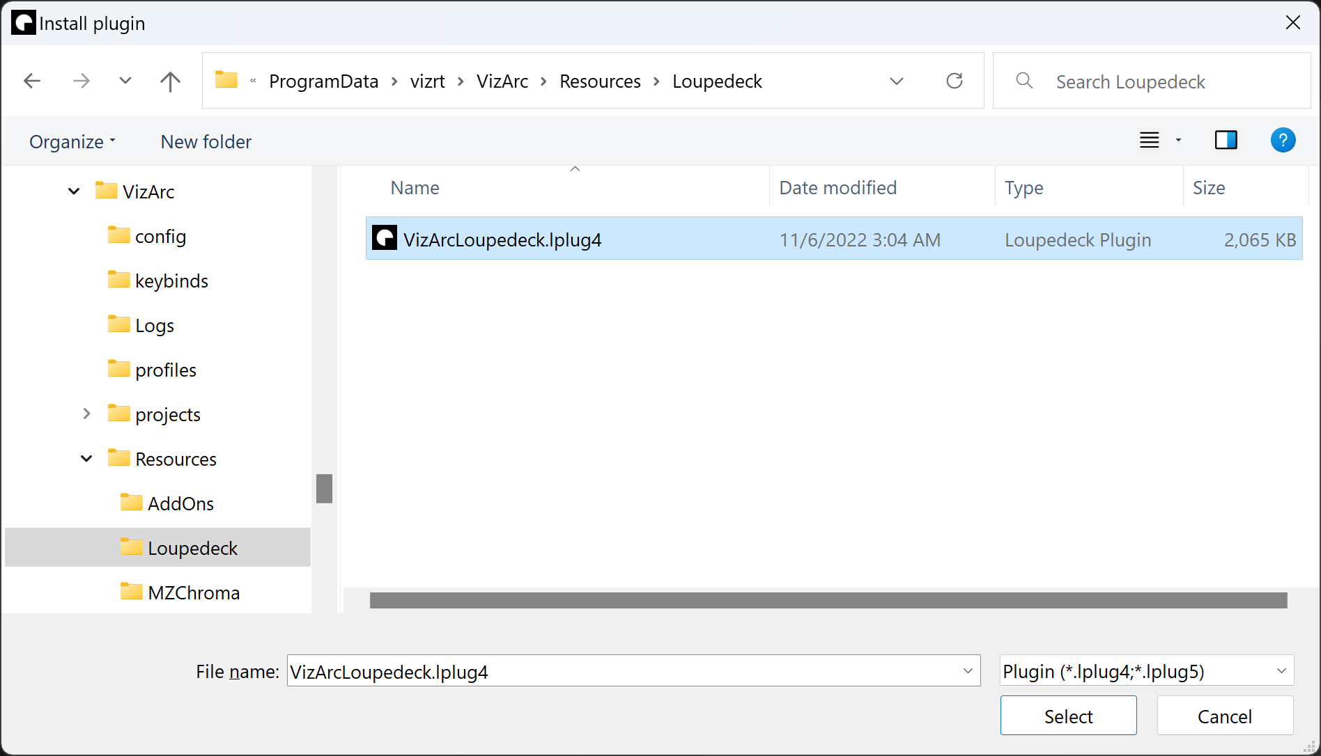

Select Install plugin from file.
Browse for the Viz Arc plug-in contained in the file VizArcLoupedeck.lplug4, which can be found in C:\ProgramData\vizrt\VizArc\Resources\Loupedeck after Viz Arc installation.

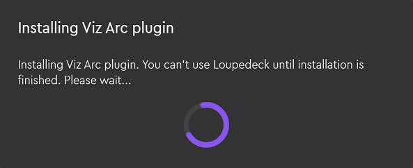

Wait for the installation to complete.
Confirm the successful installation.

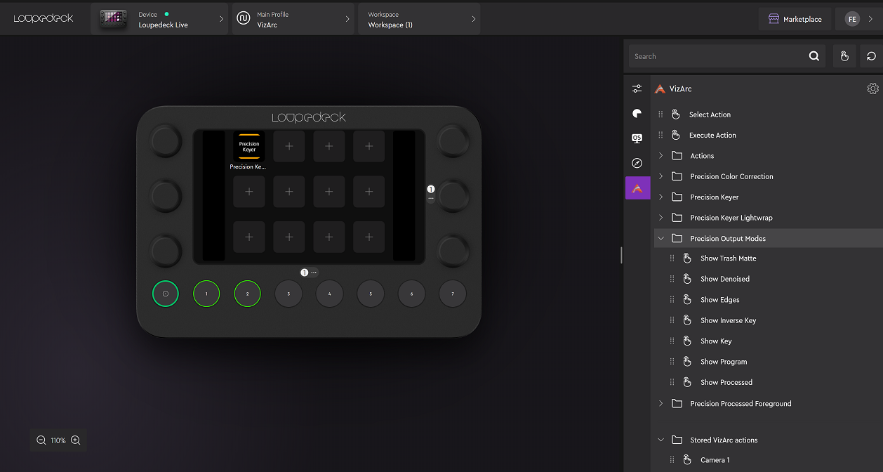

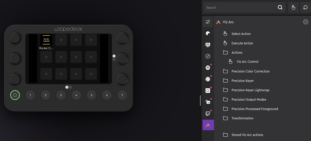

On the main page you can now find the Viz Arc plug-in. Select it and expand the Actions folder and drag the Viz Arc Control button to any of the free buttons in the Loupedeck device area.
