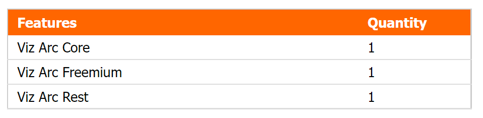

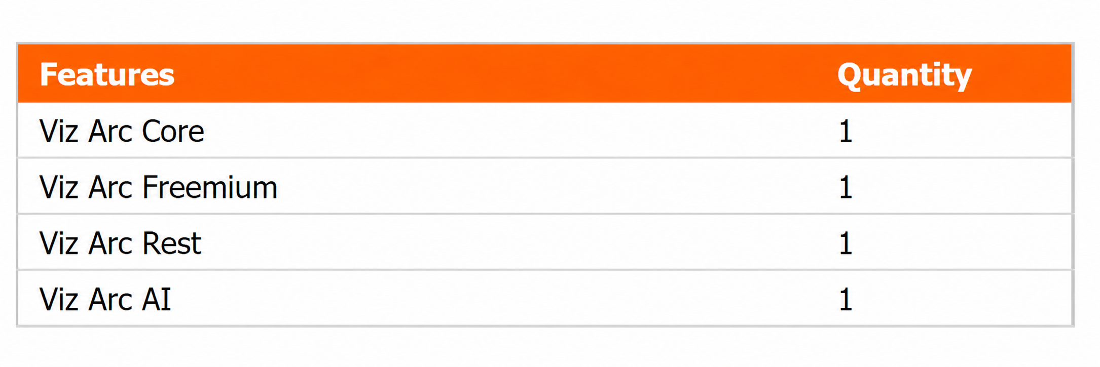

There are three types of licenses available for Viz Arc:
Viz Arc Core
This is the standard license, allowing you to work unlimited with Viz Arc.
Viz Arc Freemium
This license allows you to work with Viz Arc, but does not allow you to save or load actions other than the Chroma Key Action. The license is intended to be used by users that need to control the internal Precision Keyer of the Viz Engine.
Viz Arc AI
This license allows you to use the AI feature in Viz Arc. It needs to be coupled with either the Core or the Freemium license.
Note: Without a valid AI license:
  • The AI Prompt panel is hidden in the Template Designer.
  • MCP Server tools return a license required message.
Viz Arc REST
This license is not mandatory for the standard operations of Viz Arc. It is intended for users that need to trigger actions from external applications like Viz Pilot or Viz Mosart. It is required by the Viz Arc REST service that is an additional package included in the bundle installer. The service runs independently from any opened Viz Arc instance and allows the user to trigger actions from any project at any time.

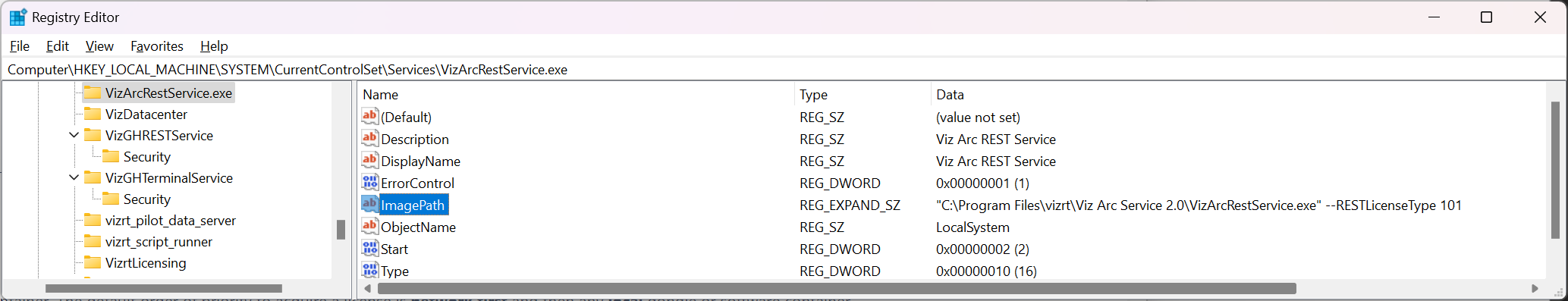

By default, the REST server tries to acquire a license based on the Viz Arc's desktop application license selection (if a local license is configured, the REST service looks for a local license as well). The license location for the REST server can be forced using  a command line switch --RESTLicenseType. Valid values are:
  • 0 = Network - Local
  • 1 = Local - Network
  • 2 = Network
  • 3 = Local
  • 101 = Network - Local v3
  • 102 = Local - Network v3
  • 103 = Network v3
  • 104 = Local v3
The switch can be added to the registry entry under Computer\HKEY_LOCAL_MACHINE\SYSTEM\CurrentControlSet\Services\VizArcRestService.exe:
The sample above forces the usage of a v3 license giving precedence to a network license over a local license.

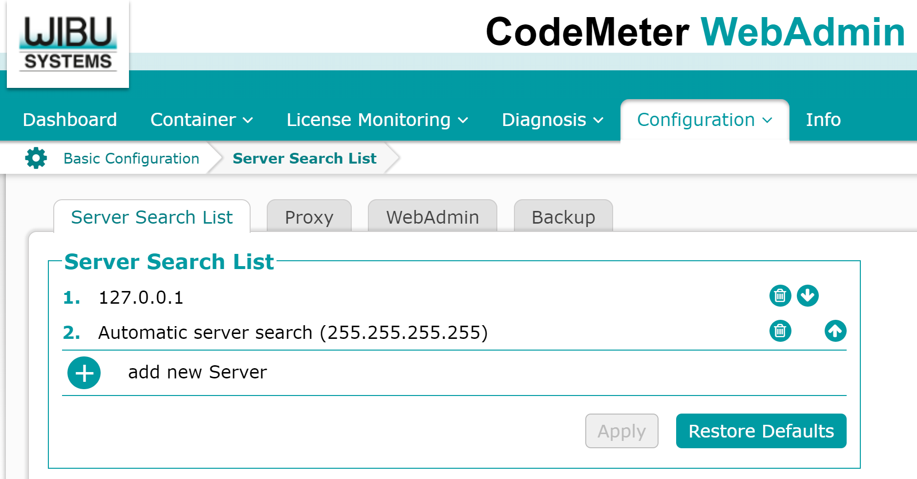

License Locations
Licenses can be either on the network, on a WIBU dongle or in a software container. The default order of priority to acquire a license is network first and then any local dongle or software container.
If you need to explicitly disable any network license location, you need to configure the loopback device 127.0.0.1 as your only source in the WIBU Server Search List.
Information: This setting might impact other locally installed software packages like the Viz Engine that might require a network license.

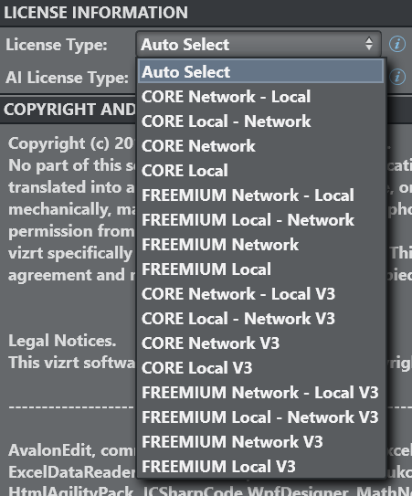

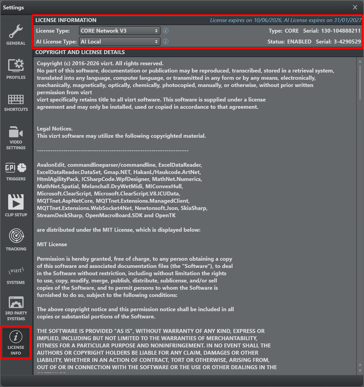

License Configuration
The type of license to acquire can be configured in the configuration panel under LICENSE INFO.
Use the License Type dropdown to select the license type and location preference.
  • Auto Select: Selects the most powerful license that can be acquired (thus first CORE and the FREEMIUM) automatically, searching first for a license on the network and then locally.
  • CORE Network - Local: Forces the allocation of a a CORE license, searching first on the network and then locally.
  • CORE Local - Network: Forces the allocation of a a CORE license, searching first locally and then on the network.
  • CORE Network: Forces the allocation of a a CORE license over the network.
  • CORE Local: Forces the allocation of a a CORE license locally.
  • FREEMIUM Network - Local: Forces the allocation of a a FREEMIUM license, searching first on the network and then locally.
  • FREEMIUM Local - Network: Forces the allocation of a a FREEMIUM license, searching first locally and then on the network.
  • FREEMIUM Network: Forces the allocation of a a FREEMIUM license over the network.
  • FREEMIUM Local: Forces the allocation of a a FREEMIUM license locally.
All the above licenses options exist also as V3 variation, for the case the Version 3 license needs to be used.

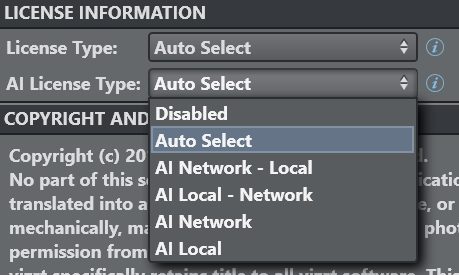

The AI license can be sourced from a different location and can be configured selecting the respective item from the AI License Type dropdown:
  • Disabled: Disable the AI feature altogether
  • Auto Select: Automatically search and select the AI license, searching first for a license on the network and then locally.
  • AI Network - Local: Forces the allocation of a a AI license, searching first on the network and then locally.
  • AI Local - Network: Forces the allocation of a a AI license, searching first locally and then on the network.
  • AI Network: Forces the allocation of a a AI license over the network.
  • AI Local: Forces the allocation of a a AI license locally.
