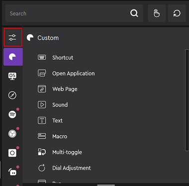

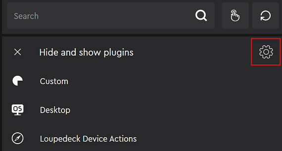

  • After installation, go to the Plugins Settings menu.

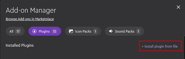

  • Click on the gearbox to open the Add-on Manager window.

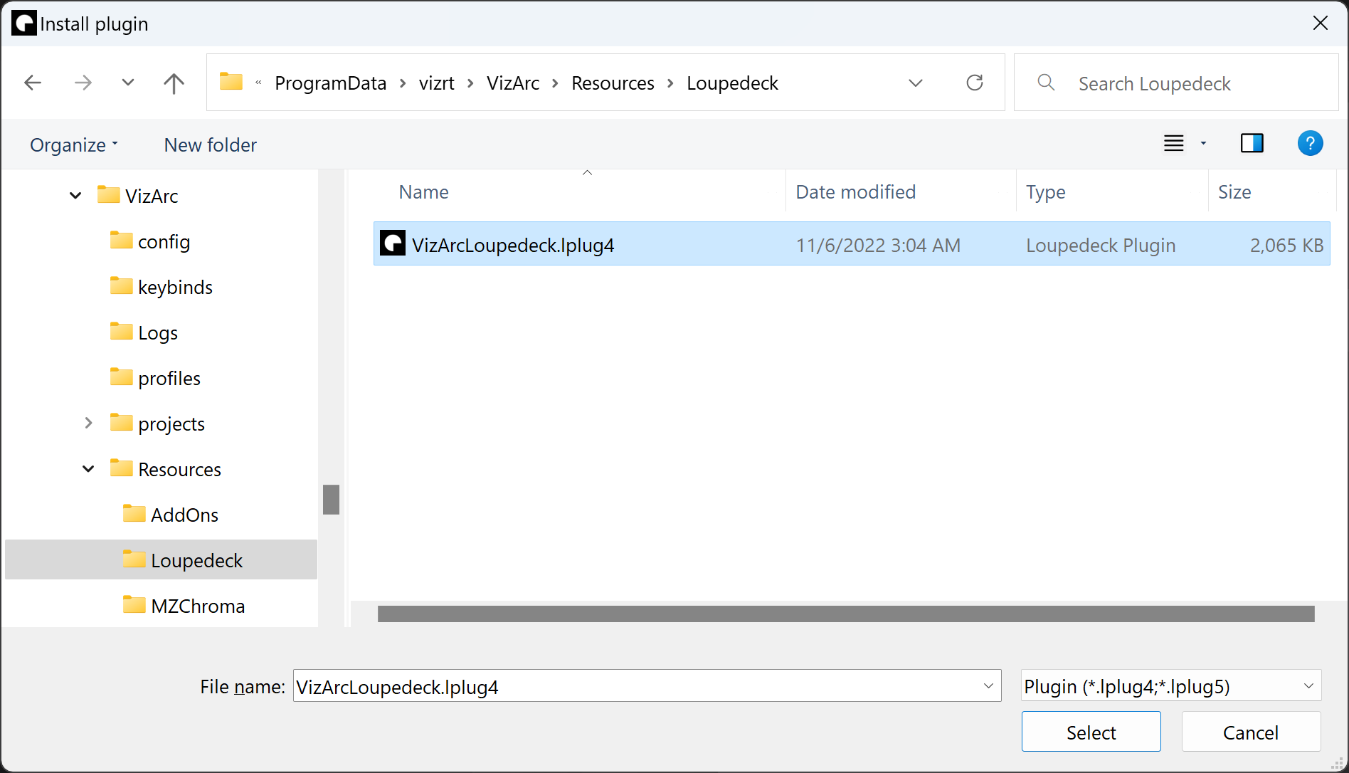

  • Select Install plugin from file.
  • Browse for the Viz Arc plug-in contained in the file VizArcLoupedeck.lplug4, which can be found in C:\ProgramData\vizrt\VizArc\Resources\Loupedeck after Viz Arc installation.

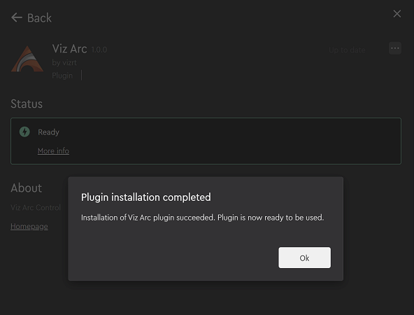

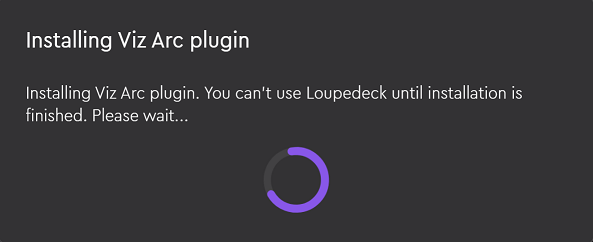

  • Wait for the installation to complete.
  • Confirm the successful installation.

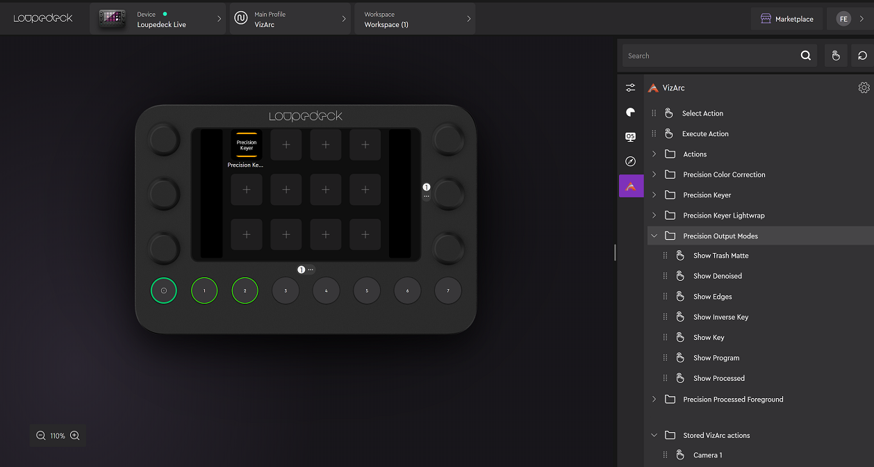

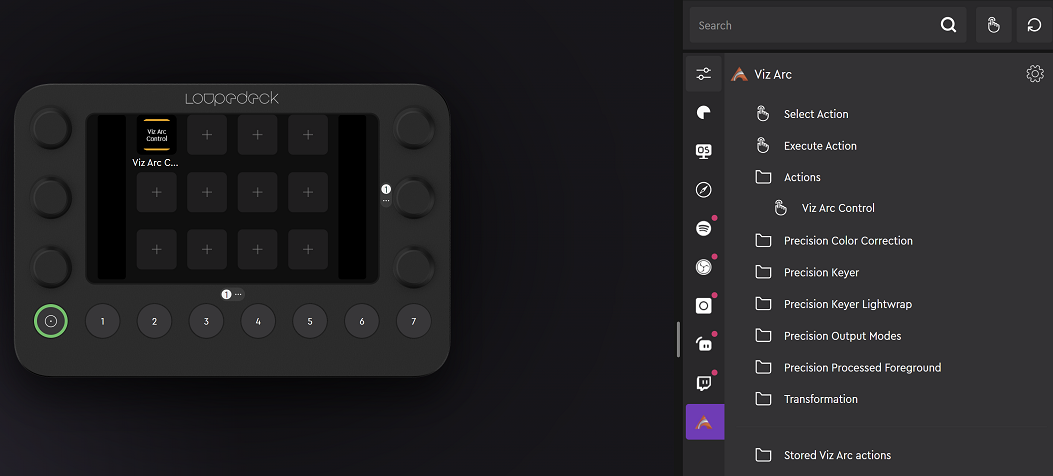

  • On the main page you can now find the Viz Arc plug-in. Select it and expand the Actions folder and drag the Viz Arc Control button to any of the free buttons in the Loupedeck device area.
