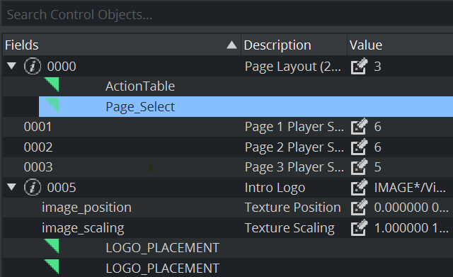

The Control Objects panel is used to show the control parameters for control applications like Viz Trio or Viz Pilot.
Control Object Parameters

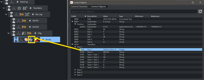

Control Objects are defined by adding certain plug-ins, so called Control Objects to containers. These plug-ins expose certain functionality to Control Applications like Viz Trio or Viz Pilot. Every Control plug-in must have a Control Object plug-in in the upper hierarchy of the scene tree.
Information: The green triangle indicates that this property has the same field identifier used on more plug-ins. Clicking on the entry automatically jumps to the related container.
Fields: A unique field identifier of this property. This is shown in the control applications. The following characters are allowed to guarantee compatibility with other control applications:
- , _ , .
0 - 9
a - z
A - Z
Description: Enter a description in the plug-in Properties panel.
Value: The editable plug-in value. This value is then overwritten by the operator in the control room.
Type: The type of Control Object.
Minimum and Maximum values: Used for Integer and Float values.

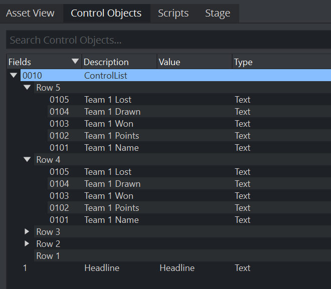

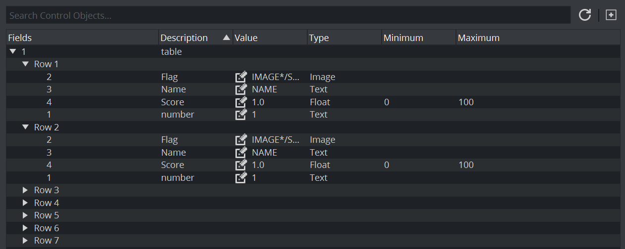

ControlList structures are shown as expandable groups within the editor:
