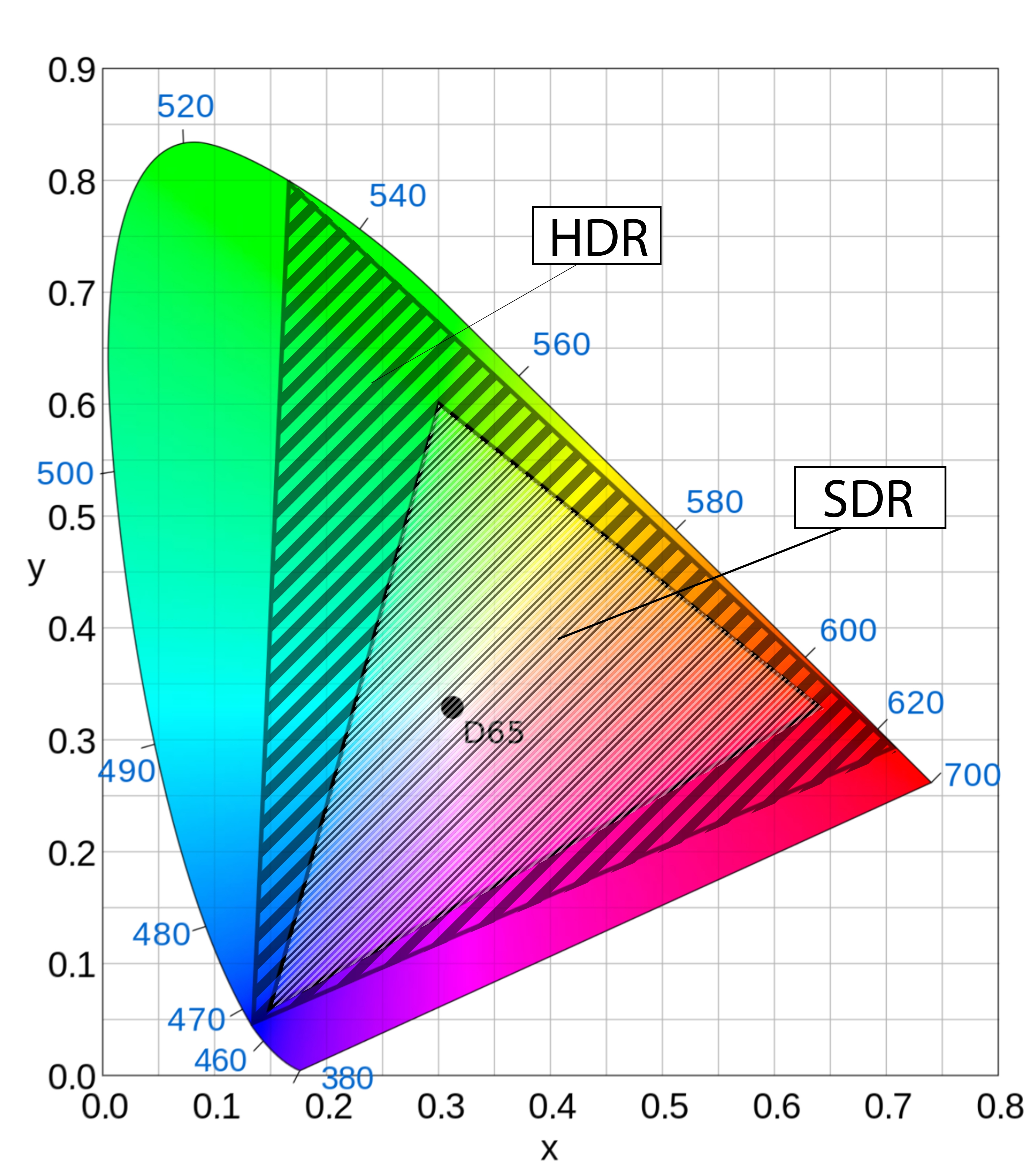

Color Spaces, Brightness and Contrast
Color values within the inner triangle, are within the SDR color space. Other colors are represented in the HDR color space. | A color space defines the range of colors that can be displayed. The human eye is capable of recognizing many more colors than common displays or TV screen can produce. Traditionally a television monitor is capable of displaying a certain, limited range of colors, also known as Standard Definition Range SDR (BT 709) color space. The SDR color space is represented as the smaller rectangle in the image on the left. In comparison to SDR, the High Definition Range or HDR, is capable of representing a much higher range of details, colors and brightness. As of the larger color spaces, HDR is able to display a much higher contrast. With more distinct differences between darker and lighter areas, resulting in a more vibrant and realistic output. It comes with much finer details, and subtler gradations of brightness levels. High Definition requires more color depth, therefore, representing a color requires 10 bit instead of 8 bit per channel, to avoid any banding in gradients. HDR capable devices are able to display brighter pixels than standard monitors. A typical HDR capable monitor can display a peak brightness of 1000 nits and more, whereas SDR is not able to show more than 100 nits. These higher brightness levels allow a greater detail in highlights and shadows. The maximum level of brightness shown in HDR ranges from 0 (complete black) to 100 (brightest white). |

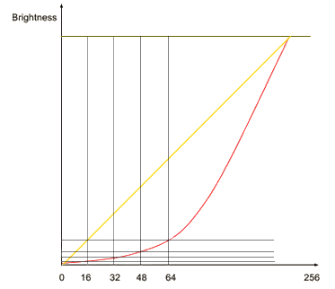

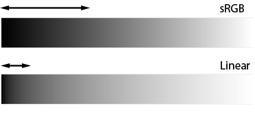

Linear and sRGB Color Spaces
The human eye is more sensitive to light in lower intensities, then to higher ones. If we use a linear gradient (bottom) from black to white, the eye perceives more dark shades than light ones. In mathematical terms, human eyes have a roughly logarithmic response to light. This means that representing colors linearly encodes more different bright colors that we can actually distinguish, but not enough dark colors to prevent banding. The simplest solution, using more bits to increase the number of distinct color levels, is inefficient in terms of data size. Therefore, most common color encoding systems use non-linear brightness levels like gamma curves. They redistribute available code points to match human perception. Smaller differences in the dark areas are encoded at the cost of larger gaps in the bright areas. |
