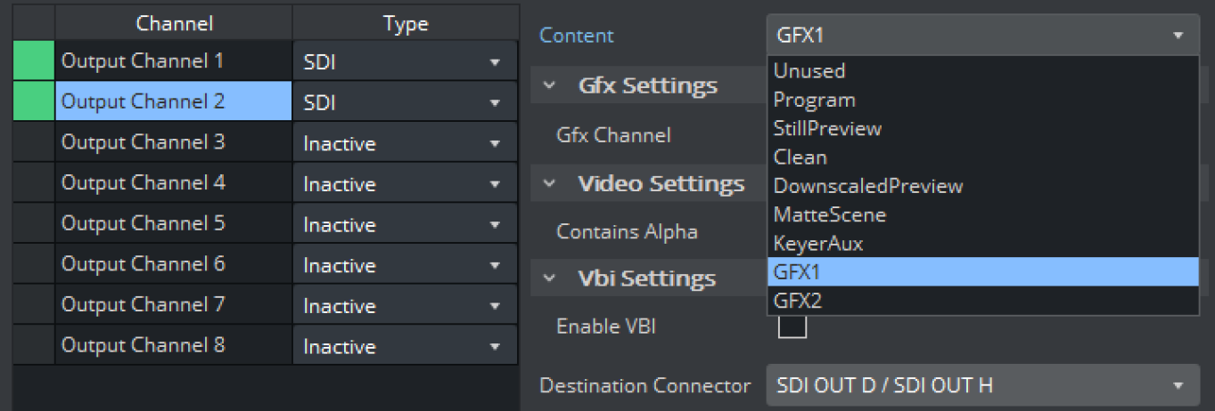

For SDI/IP workflows:
Map one or more SDI/IP outputs to a connector.
Choose your type of output (Program, StillPreview, Matte, etc, or one of two available graphics outputs):
Configure GFX channels to default (
port 55000).

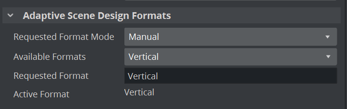

On the first GFX channel, choose the first format to output. There are several options available:
Manual: Renders a given format.
Inherit from Main Scene: Uses the format of the GFX Channel Master scene.
Use Aspect Ratio: Selects the format automatically based on the width/height and therefore the aspect ratio of the scene). The first matching format is applied. Only works for DVE.
(for example, Vertical)
Enable the NDI Aux Mode in the Aux tab.
Do the same for GFX Channel 2, choose for example, horizontal as format.

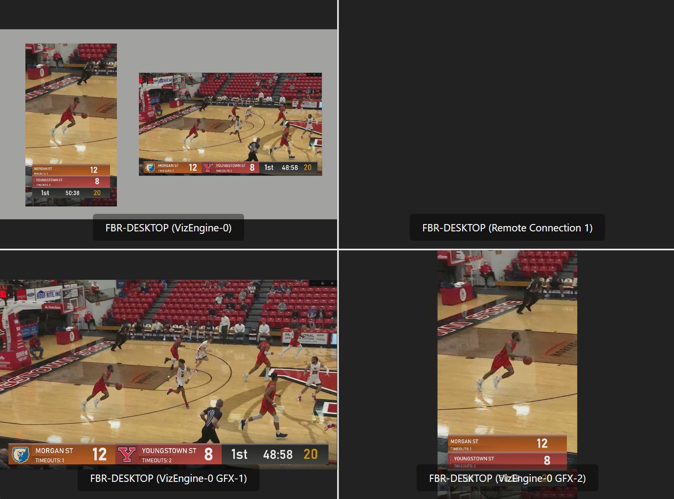

Viz Engine now serves three different NDI streams:
The master GFX scene, named VizEngine-0.
The content of GFX channel 1 in vertical format, named VizEngine-0 GFX-1.
The content of GFX channel 2 in horizontal format, named VizEngine-0 GFX-2.
