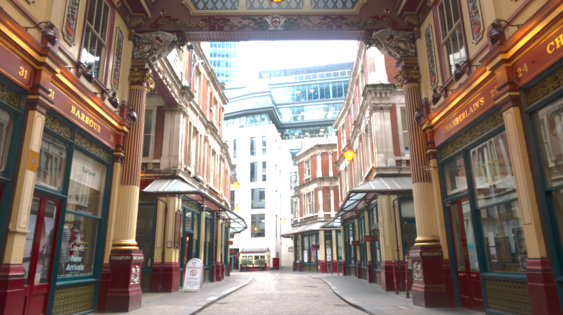

The neutral tonemapper keeps neutral colors up to a certain maximum and only maps highlights into sRGB color space. This allows to keep all neutral colors, but clamps overshooting shadows and highlights.

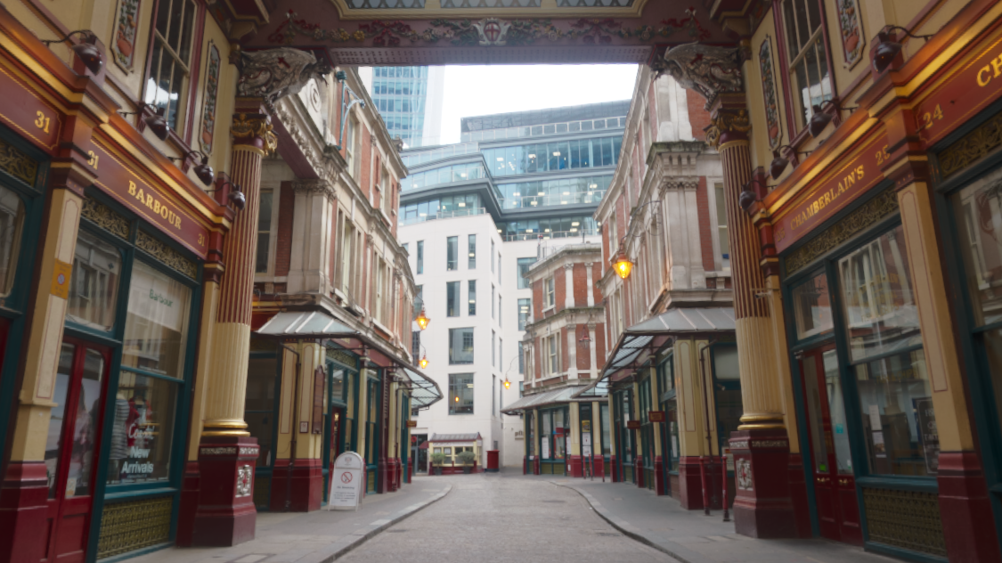

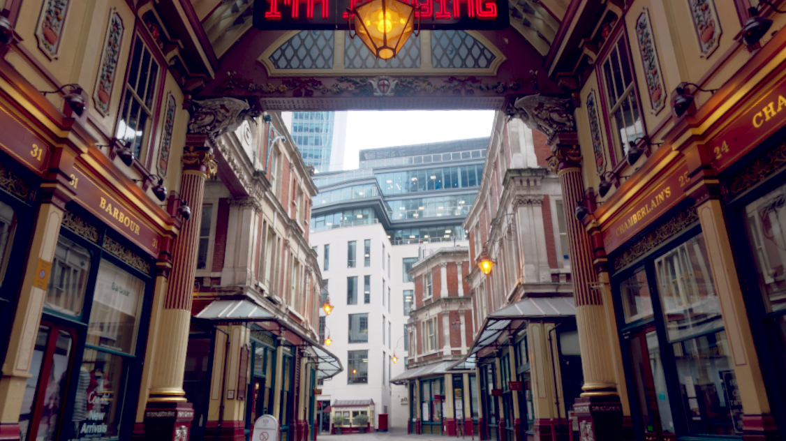

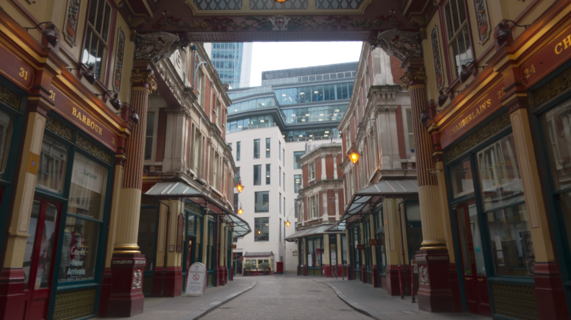

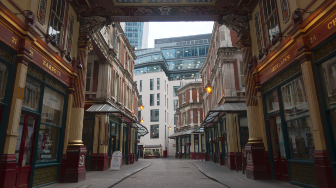

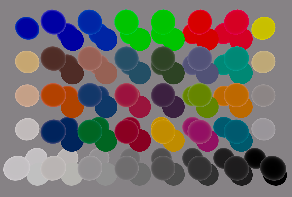

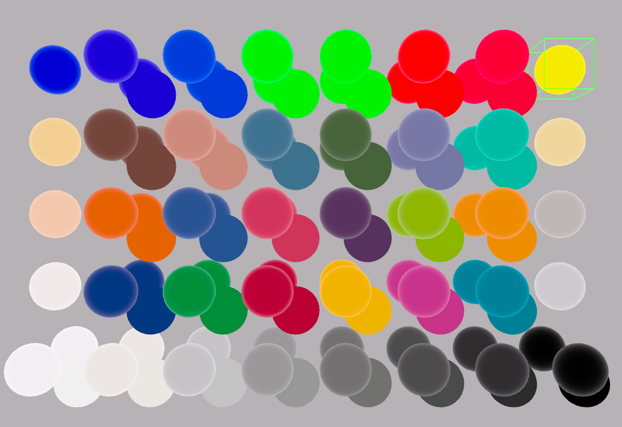

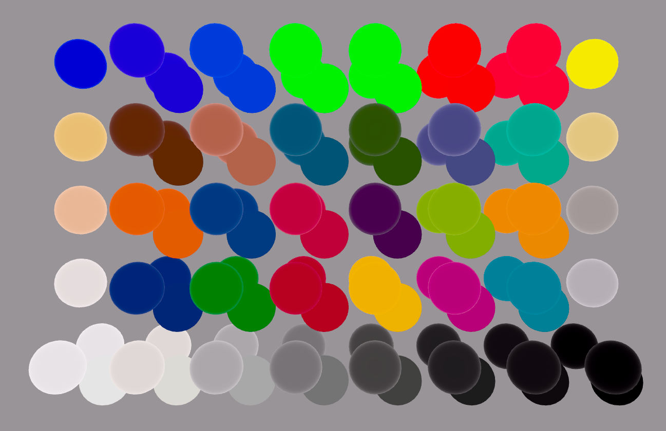

No tonemapping applied | Filmic Tonemapper | Neutral Tonemapper (Note color changes only on outer spheres) |
The neutral Tonemapper should be used if your colors match a given Corporate design.
Filmic Tonemapper
The filmic tonemapping operator proposed by John Hable is used.

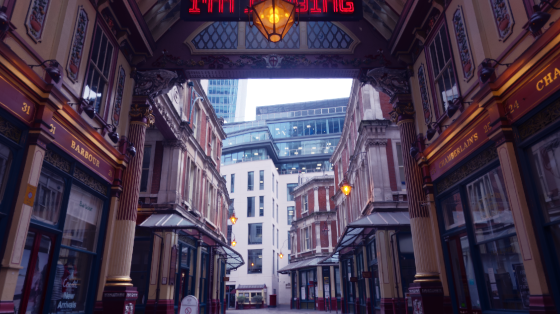

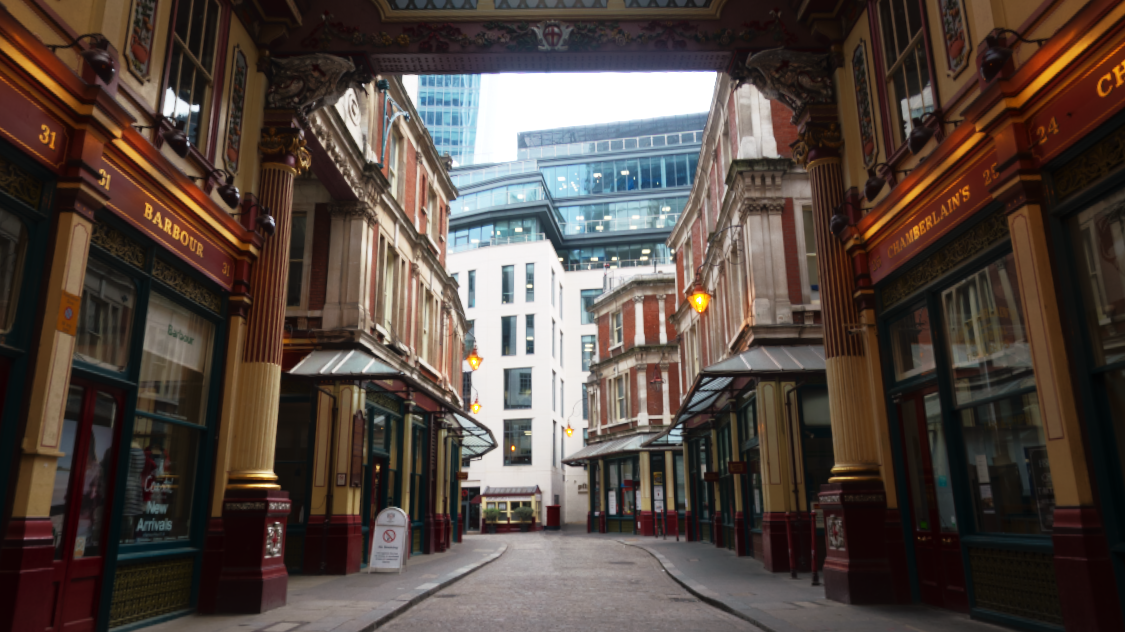

Examples
Screenshot | Information |
Tonemapping Disabled | |
Tonemapping Enabled Default values. | |
Tonemapping Enabled Adjusted values compared to the default ones, to have a slightly improved saturation. |

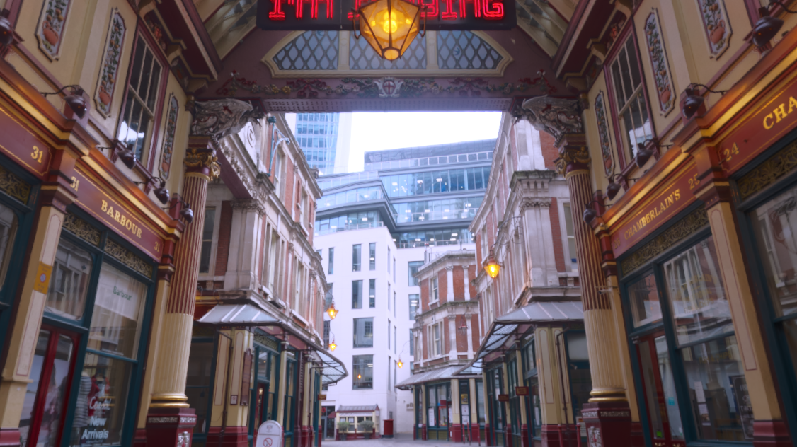

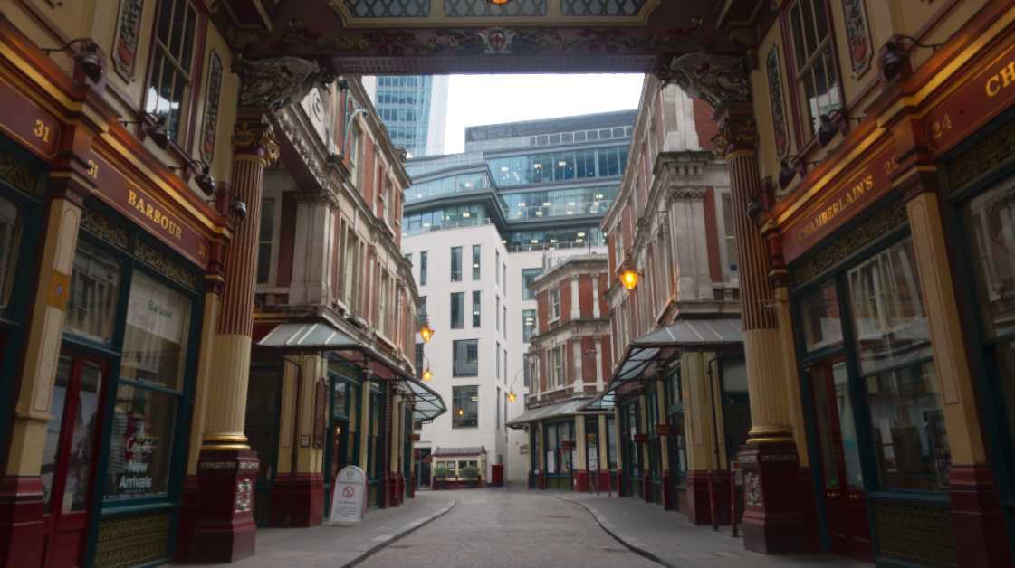

Examples
Screenshot | Description |
Default Settings
for red, green and blue channels. | |
Adjusted | |
Adjusted | |
Adjusted |
