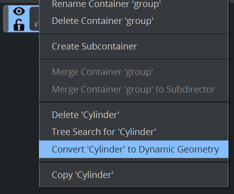

Right click on a container holding a basic geometry and choose Convert n to Dynamic Geometry.
Once the geometry has been converted, the Icon of the geometry changes to indicate a Dynamic Geometry. Clicking on this Geometry Icon shows you a list of a Generator and one or more Modifiers.

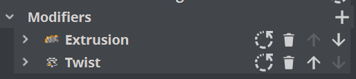

A node modifier takes the node data of the generator or the previous node and transforms it into a new one. Therefore, the order of the applied node modifiers matters. For example, if you first twist a geometry and extrude it afterwards, the result looks different.
Add a new modifier by clicking on the icon inside the modifier accordion and the list of available modifiers are shown.
: Replace a modifier.
: Remove a modifier by clicking on the trashcan icon.
: Change the sequence by clicking on the arrow icons, as the order matters.

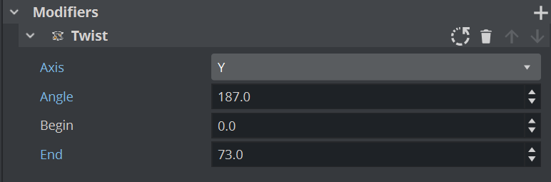

The Twist modifier allows to add a twist effect to any geometry. As more vertices are available on the geometry, the better the result is.
You should always try to increase the number of vertices on the base geometry by increasing the tessellation value.
The Twist modifier allows to rotate on X,Y or Z-Axis.
The Angle is applied between the Begin and End property.

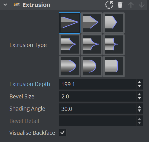

Extrusion Modifier
The Extrusion modifier can be used to turn any 2D object (like a rectangle or circle) into a 3D object.
Modify the length of your extrusion using the Extrusion Depth parameter.
Start at the end of the extrusion effect can be changed by using the Bevel Size option. Depending which Extrusion Type you have chosen, the effect of the bevel looks different.
Some Extrusion types also allow to modify the Detail of the bevel effect or the Shading Angle.
Visualize Backface turns off the additional vertices; however, as all these calculations are performed on the GPU, this might only be needed in some rare use cases.

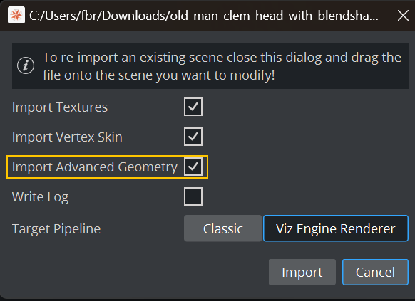

To import an .FBX file with blendshapes, make sure to check the option Import Advanced Geometry in the import dialog box:
Information: Only .FBX files can be imported as Blendshapes.

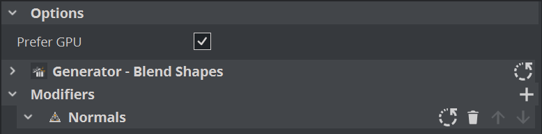

Once the model is imported, it is shown as Dynamic Geometry and the Blend Shapes Generator as well as the Normals Modifier is applied. The Prefer GPU option should always be kept unless there is a reason to move the calculation to the other (slower) CPU.

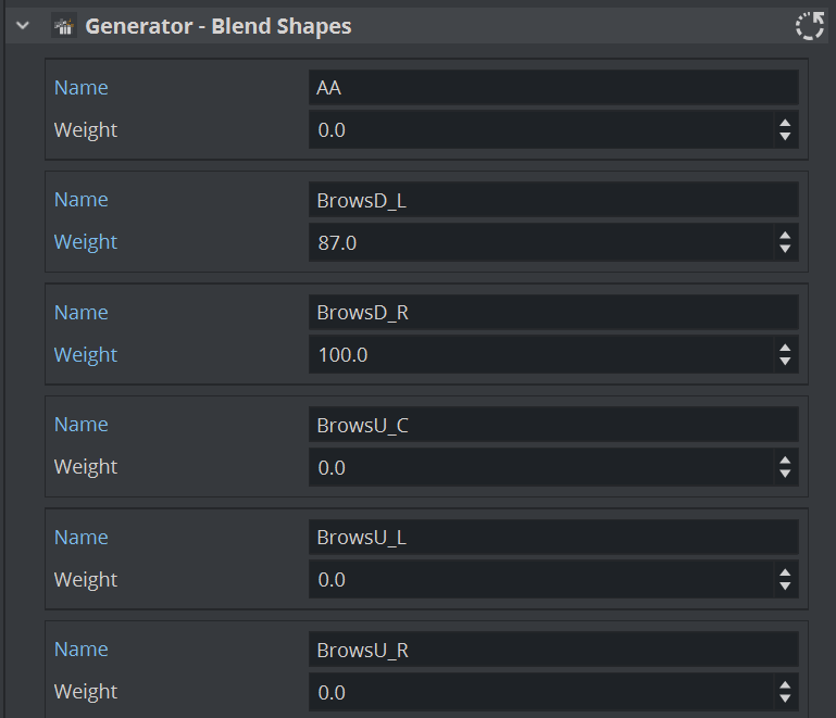

The Generator node now displays a list of all Blendmodes within the model as well as a modifier to each expression to control the strength of it:
The names of the expressions varies from model to model, however Apples AR Kit defines 52 sets of expressions (for faces).
The weight can be set from a value between 0 and 100 and mixes the shapes into a new expression.
