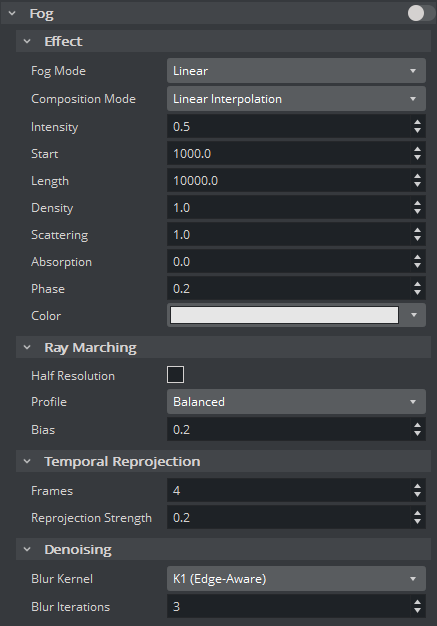

Fog Parameters
Effect
  • Fog Mode: Sets how the transmittance through the fog is calculated.
    • Linear: Linearly proportional to the distance from the camera.
    • Exponential: Exponentially proportional to the distance from the camera. This makes the decay faster than Linear Mode.
    • Exponential^2: Exponentially proportional to the squared distance from the camera. This makes the decay faster than Exponential Mode.
  • Composition Mode: Sets how the effect is composed to the main scene color. The following options are available:
    • Linear Interpolation: Composes by performing linear interpolation between scene the scene color and the fog color.
    • Multiply: Composes by dimming the scene according to how dense the fog is, with respect to the fog color.
  • Intensity: Sets the intensity of the effect applied to the scene.
  • Start: Sets the distance where the fog starts from the camera.
  • Length: Sets the length of the fog from the camera. Only available for Linear Fog Mode.
Information: In other Fog Modes, the length is assumed to be the camera’s far plane. See Rendering Properties to customize the camera’s clipping planes.
  • Density: Sets the fog particles density.
  • Scattering: Sets how much light is scattered on fog particles. This is the antecedent of the scattering-to-absorption ratio.
  • Absorption: Sets how much light is absorbed by fog particles. This is the consequent of the scattering-to-absorption ratio.
  • Phase: Sets how the light is scattered on fog particles. The negative value means the light is likely to be reflected, while the positive value means the light is likely to be transmitted.
  • Color: Sets the color of the fog particles.
Ray Marching
  • Half Resolution: Sets whether ray marching is performed in half resolution. This speeds up the computation at the cost of the quality.
  • Profile: Sets what ray marching prioritizes. The options are Performance, Balanced, and Quality.
  • Bias: Sets the bias of ray marching. 0 means to evenly sample along the ray, while 1 means to mostly sample near the camera. This could also reduce noise when the farthest point in the scene is deterministic.
Temporal Reprojection
  • Frames: Determines the number of frames used to accumulate the effect (higher values can cause ghosting for moving objects/camera).
  • Reprojection Strength: Controls how strong the rays are reprojected for moving objects.
Denoising
  • Blur Kernel: Controls the quality of denoising.
  • Blur Iterations: Controls how strong the effect gets denoised.

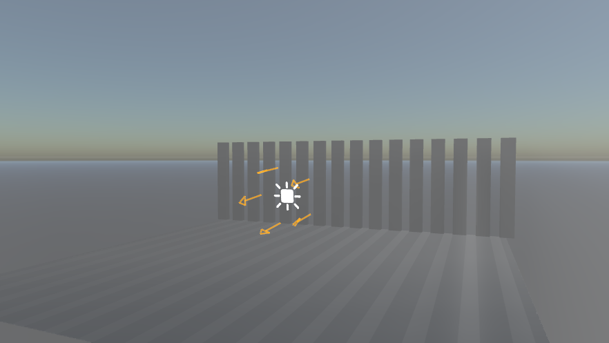

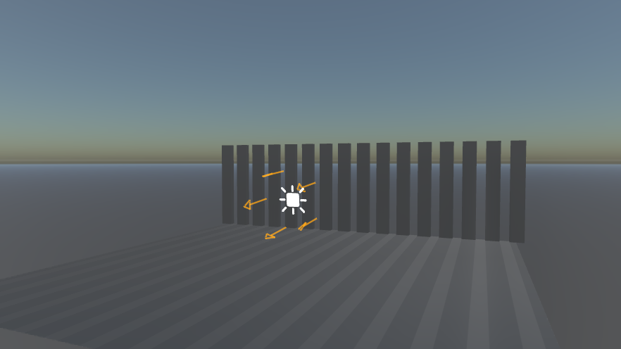

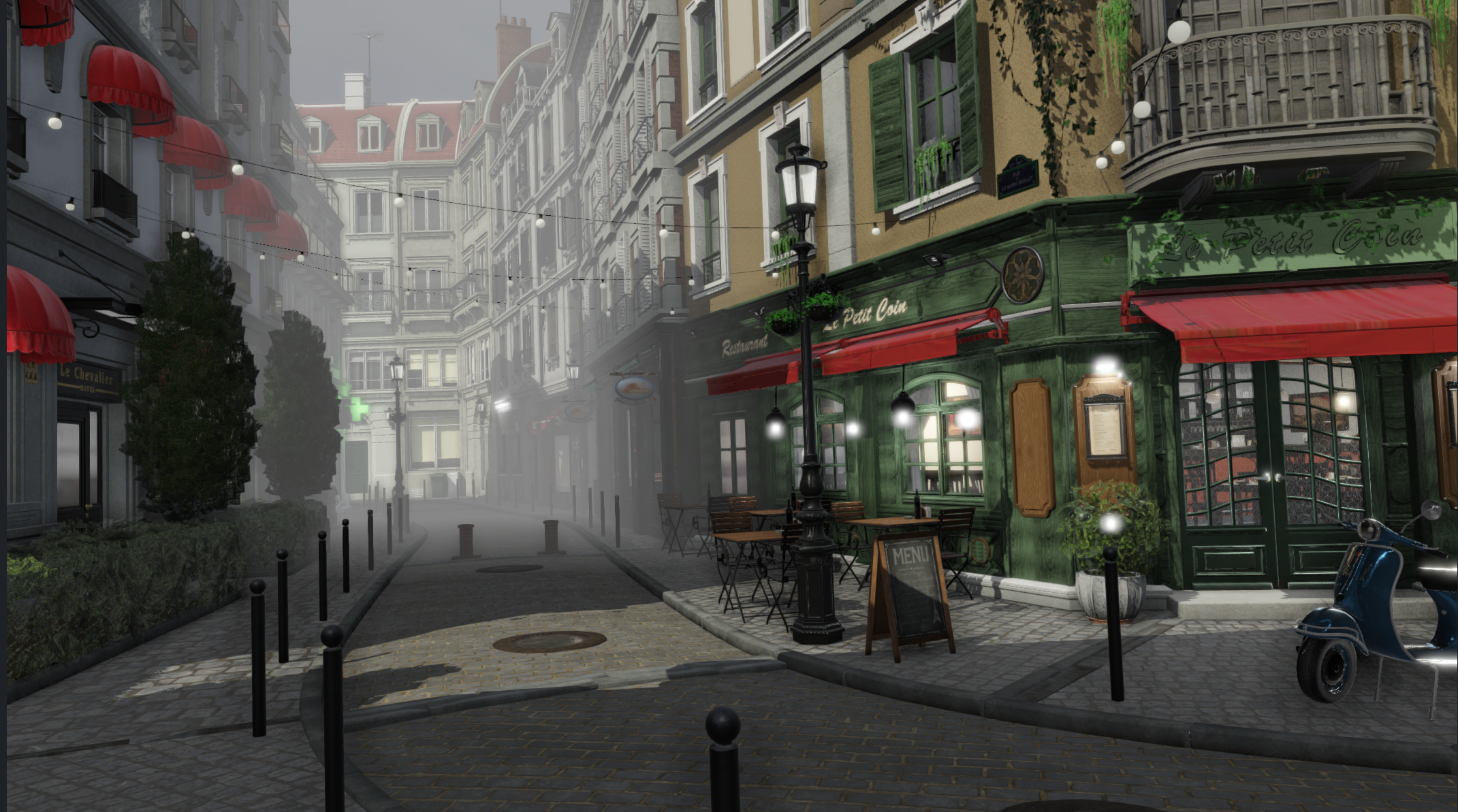

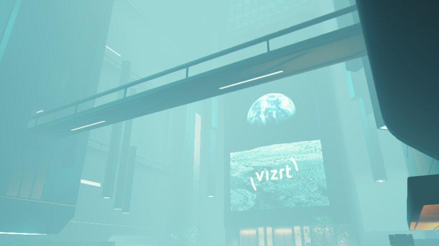

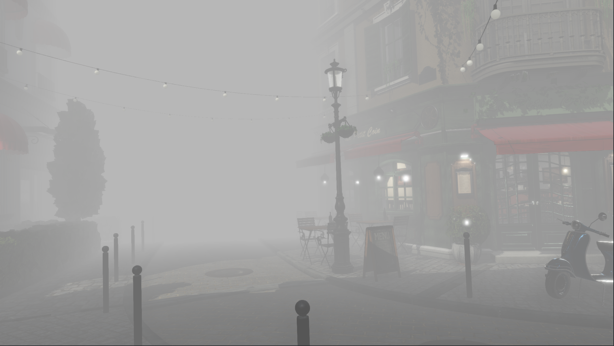

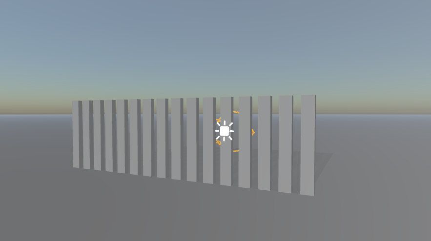

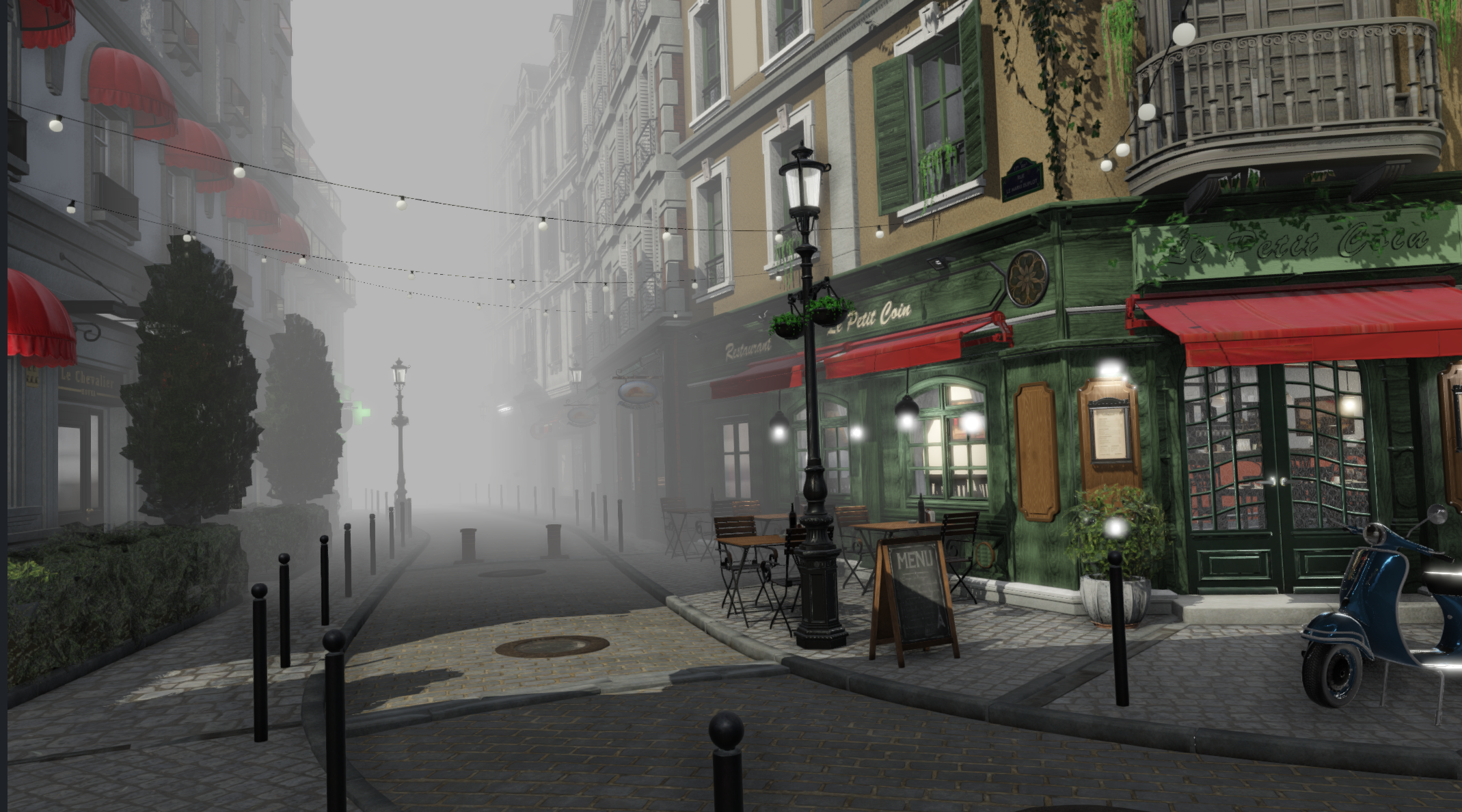

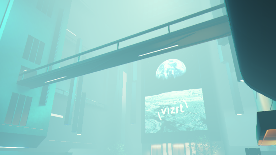

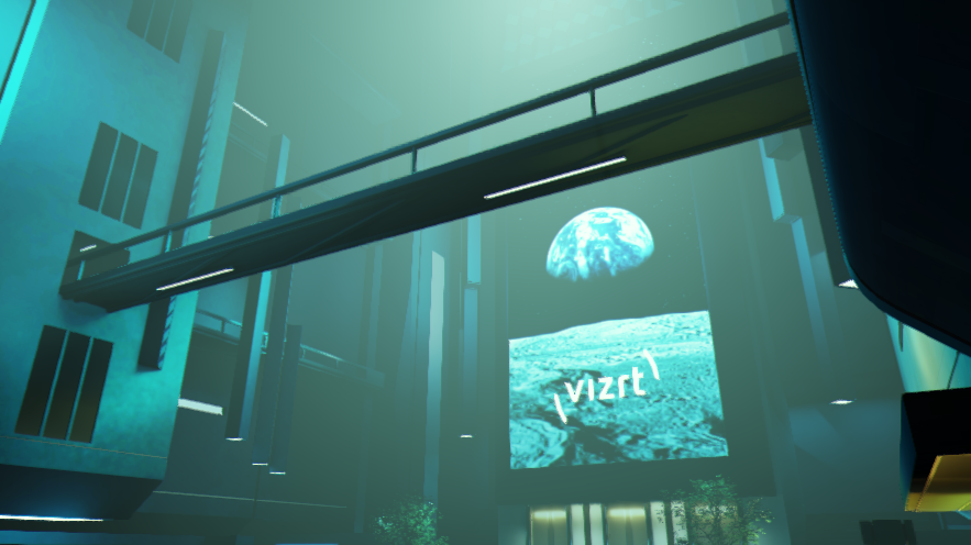

Examples
Screenshot
Fog Settings
Intensity = 1.0
Start = 0
Density = 0.0
Intensity = 0.4
Start = 250
Density = 0.0
Intensity = 1.0
Start = 170
Density = 100.0

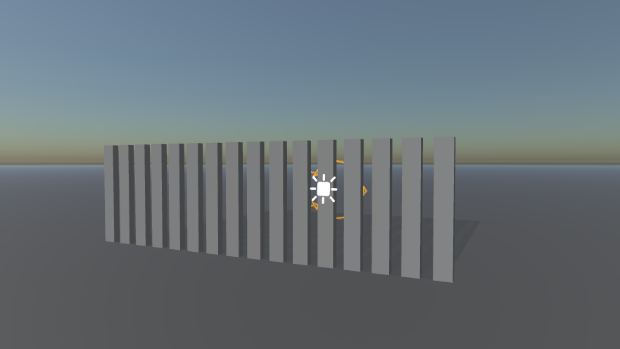

Composition Mode = Linear Interpolation
Light = Off
Light = On
Composition Mode = Multiply
Light = On
Phase = 0.2
(Notice the light direction)
Phase = -0.2
Phase = -0.2
Phase = 0.2
