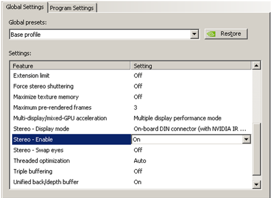

To Set Up a 3D Working Environment
In the Windows video board 3D settings, Set Stereo - Enable to
On.Select the appropriate Stereo - Display mode for each stereo device.
Note: For NVIDIA’s 3D Vision, this is ‘On-board DIN connector’.
In Camera settings (see the Configuring Viz section of the Viz Engine Administrator Guide) set Stereo Mode to Quad Buffered.
