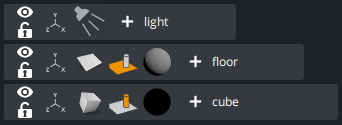

  1. Start with the following scene setup:
    1. A light to cast a volume.
    2. A floor to receive shadow with an arbitrary material.
    3. A geometry to cast shadow and occlude some part of the volume, with an arbitrary material as well.

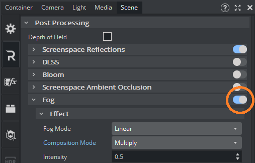

  1. Go to Properties panel > Scene > Rendering > Post Processing > Fog and enable the fog effect.
Tip: Setting Fog’s Composition Mode to Multiply is recommended for volumetric lighting.

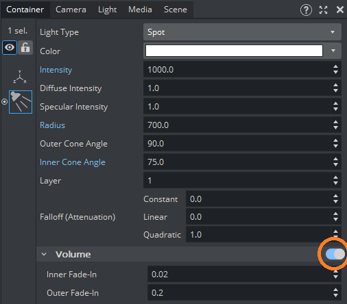

  1. In the light properties, find the Volume group and enable it. This allows the light to cast its volume with respect to the fog effect properties.

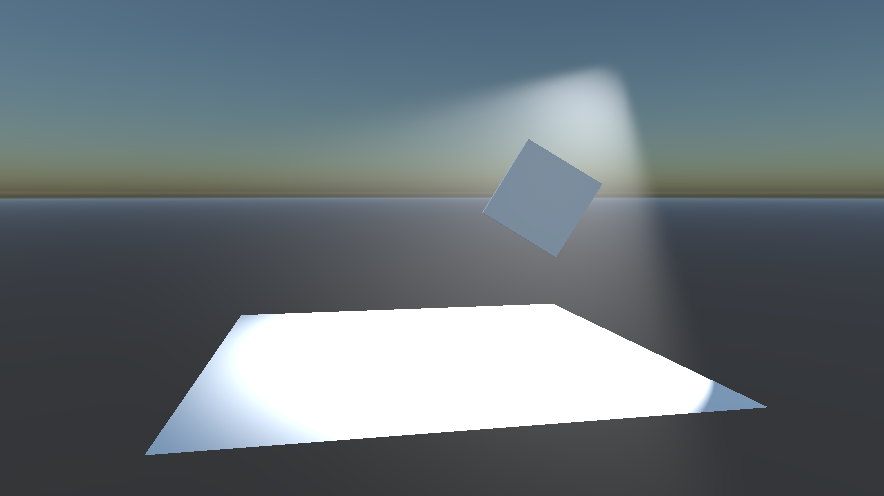

Tip: Apart from customizing Fog effect, the volume intensity of a particular light mainly depends on Light’s Intensity. In addition, Light’s Falloff (Attenuation) could slow down the volume fade-out, giving the volume a more solid appearance.
  1. Now the light volume appears in the scene when Post Processing effects are activated for Scene Editor.

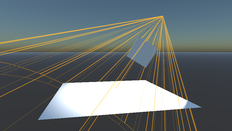

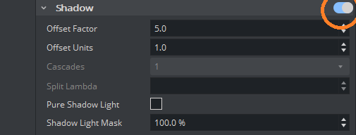

  2. In the same light properties, find the Shadow group and enable it.

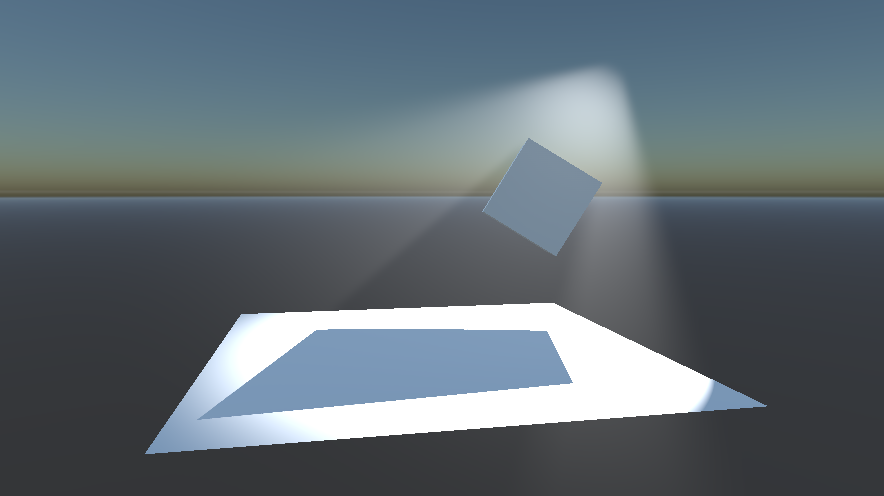

  3. Now the geometry occludes the volume and creates a light shaft.
