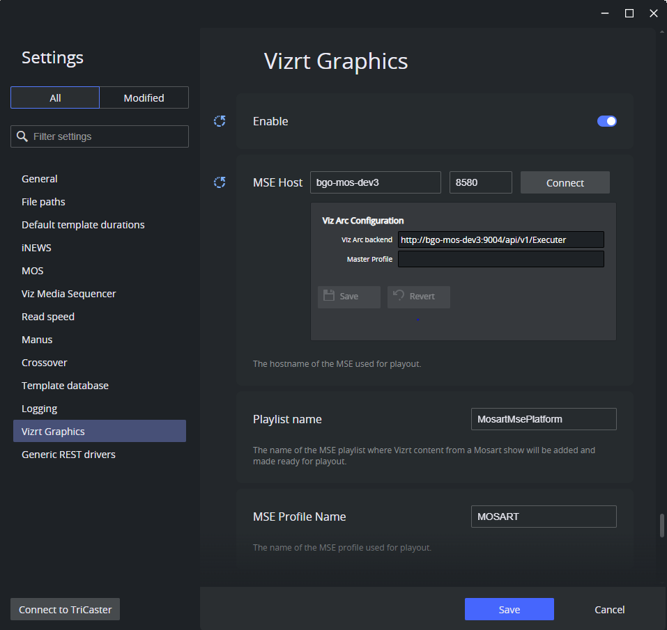

To configure Vizrt graphics
  1. Open the Settings menu, as described in Viz Mosart Central Settings.
  2. In the left panel, select Vizrt Graphics.

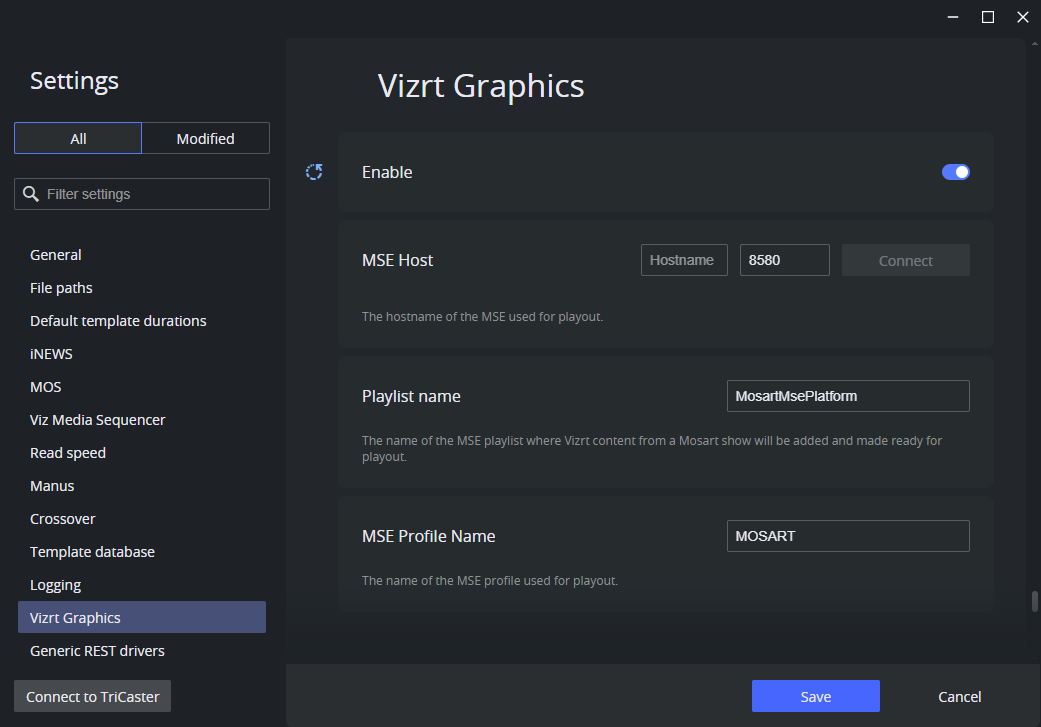

  3. In the panel to the right, select Enable.
  4. In the MSE Host section provide:
    1. Host name
    2. Port number (default 8580).
  5. Click Connect.
    On successful connection to MSE, a page served by Media Sequencer is displayed, just below the host and port fields.
  6. In the section Viz Arc Configuration:
    1. Enter a value for Viz Arc backend, as a URL, in the form: http://<Viz Arc REST service hostname>:<Viz Arc REST service port>/api/v1/Executer. (default Viz Arc REST service port is 9004. See the Viz Arc User Guide).
    2. The Master profile is defined in Viz Arc. Here is an example for Viz Arc 1.8.
      A profile is used to configure the different groups (channels) of either the Viz or Unreal Engines available for user control.
  7. Click Save to save to the MSE (or Revert to undo your changes).
Note: These settings are saved on the Media Sequencer side (not Viz Mosart)
  1. Enter a value for the MSE Playlist name.
    This is where the Viz content playout elements added in a Viz Mosart show, planned in an NRCS, will be added to be handled through the Vizrt Graphics driver.
    This value is case sensitive. Default: MosartMsePlaylist
  2. Enter the MSE Profile name.
    This is used for playing out elements. The selected profile must first be created and activated, using a profile editor available in either Viz Trio, Viz Pilot (Director) or Viz Multiplay.
    This value is case sensitive. Default: MOSART.
  3. Click Save to apply the setting.
    There is no need to restart the Manus Administrator.

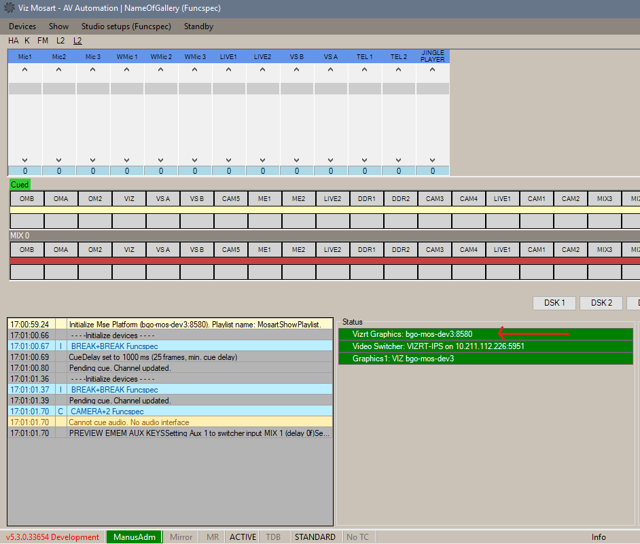

With the settings applied, the MSE connection status that employs the Vizrt Graphics driver is shown in Viz Mosart AV Automation's Status panel (see red arrow):
