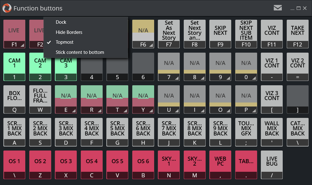

  • You can control some visual aspects of the display when the window is detached from the GUI. Right-click to open a context menu.
    • Dock: Return floating window to GUI layout.
    • Hide Borders: Provides a clearer view without any distracted items. Useful when using a dedicated screen for Function buttons.
    • Topmost: Keeps the Function buttons window above all other windows on your screen.
    • Stick content to bottom: Controls the vertical alignment of the panel.

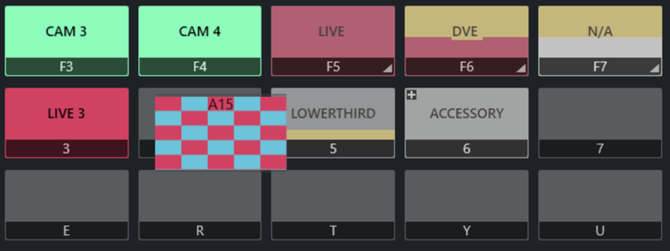

Luminosity
A dimmed button is non-operational. This button status means that Viz Mosart is awaiting NRCS content (not yet received).
For example, in the large screenshot above, LIVE (button F5) is dimmed (compare with the active LIVE 1, 2 and 3).

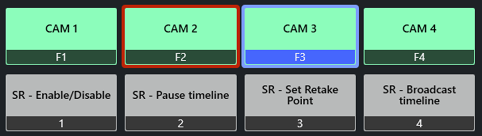

Color-coding also indicates status:
  • Red border: Template is on-air.
  • Red border, label highlighted: Button is selected, template is on-air.
  • Blue border, label highlighted: The button is selected.
In the illustration above:
  • CAM 2 is on-air
  • CAM 3 is selected (button F3 highlighted).

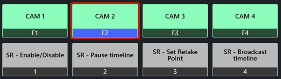

  • CAM 2 is both on-air and selected.

Audio icon: The audio symbol in the upper left corner of a button indicates that this an Audio template.
Accessory icon: The 'plus' symbol in the upper left corner of a button indicates that this an Accessory template.

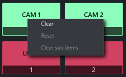

Context Menu
Right-clicking over a keyboard shortcut displays a context menu.
Note: Importing an existing keyboard shortcuts file into a newer version of Viz Mosart may give unexpected operational behavior.
It is highly recommended to verify keyboard-driven operations after an upgrade, and as necessary, redefine the shortcuts, before going on-air.
The availability and actions of this menu depend on preferences set in the Keyboard Shortcuts menu (Tools > Keyboard shortcuts editor)
  • Clear: Remove the session-based (show-based) button definition from this Viz Mosart session.
    This option is only available for buttons that have not been hard-defined from the Keyboard Shortcuts menu.
    Buttons that are not hard-defined appear as grey/dark grey in the UI. A light grey box can be populated with a session-based button definition (for example by drag and dropping a template or lower third from the Assets panel, see the screenshot below).
    These session-based button definitions disappear when the UI is restarted.
  • Reset: Temporarily remove the wording on a button, to discourage selecting the defined operation (for example a camera number).
    This does not clear the operation definition, which will still be executed if the button is pressed. Restart the UI to display the button text again.

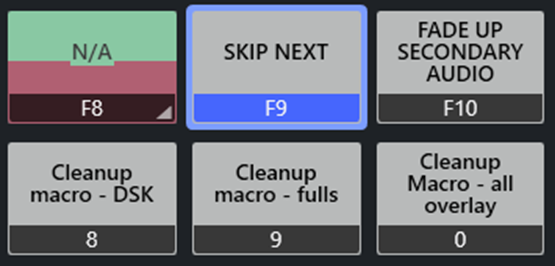

Administration status
In the Viz Mosart UI menu Tools > Keyboard shortcuts editor,
Blue border: The button is being worked on using the Keyboard Shortcuts Editor.
  • SKIP NEXT (F9) has been selected in the Keyboard Shortcuts Editor.
