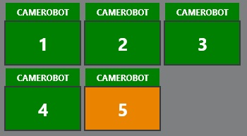

The Viz Mosart UI includes a selectable control panel that displays the status of allocated robotic cameras.
By pressing the button for a camera robot, you can change its operational mode.

Operational Status
The state of the camera robot is indicated by the button color
GREEN: Camera robot is in operation and controllable from Viz Mosart.
ORANGE: Camera robot set in stand-by (disabled), and no longer controlled by Viz Mosart.
LIGHT GRAY: The camera robot has not been allocated to this Viz Mosart setup by the Mosart Media Router (MMR).
RED: Error communicating with the camera robot. The camera robot is inactive and not controllable from Viz Mosart.
To change camera robot operation mode
You can change the operation mode for the camera robots by pressing the button for the camera robot.
  • Pressing a green button places the selected active camera robot into standby, the button color changes to orange.
  • Pressing an orange button when the camera robot is connected, switches the selected camera robot from standby to active, the button color changes to green. If the camera robot is not connected, the button color changes to red.
  • Pressing a red button switches the selected camera robot from inactive to standby, the button color changes to orange.
