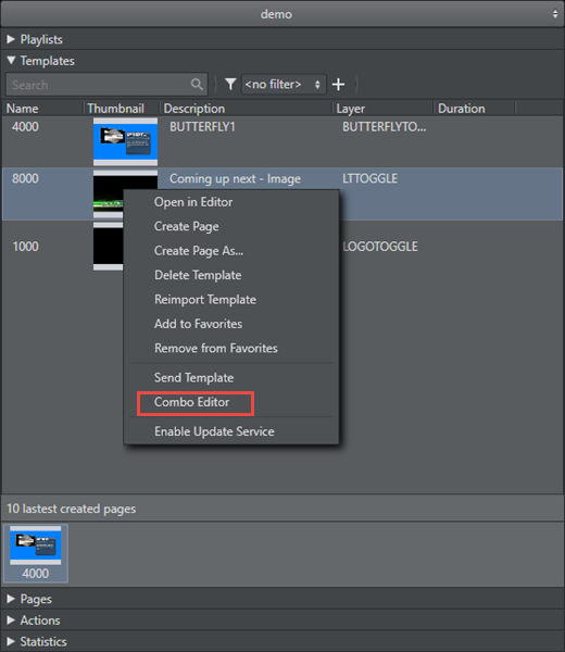

  1. Right-click a template in the Templates and Pages drop-down menu and select Combo Editor:

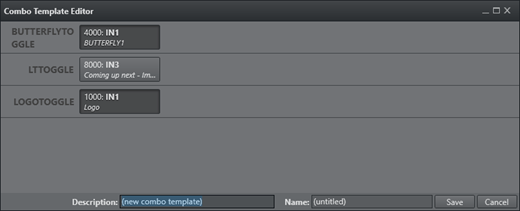

    The Combo Template Editor is shown. For each TL layer (in the example screenshot below: logo_zehd, music_name, etc) the various states that can be selected will be shown as selectable boxes.
  1. In the Combo Template Editor, select the TL state that should be activated when pages based on the TL template are shown On Air. Selected states are highlighted in orange.
  2. Give the new combo template a text description and a unique name.
  3. Press Save.
