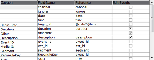

Mapping Table
The mapping table for *.lst and *.rcv files must be as follows:
Caption | Field Name | Reference |
channel | channel | |
ignore | ignore | |
date | date | |
Begin Time | begin_at | time |
Duration | duration | duration |
Offset | timecode | |
Description | description | description |
Event ID | event_id | event_id |
Media ID | trigger_id | trigger_id |
Segment | segment | segment |
ReconcileKey | ReconcileKey | event_id |
SOM | SOM | SOM |
Effect1 | effect1 | effect1 |
Effect2 | effect2 | effect2 |
Effect3 | effect3 | effect3 |
secondary_page | secondary_page | |
secondary_timecode | secondary_timecode | |
secondary_event_id | secondary_event_id | |
secondary_ext_id | secondary_ext_id | |
event_type | event_type | |
overlay_type | overlay_type |
Build Unique Instructions in case of Duplicate Reconcile Keys in LST
In case of duplicate reconcile keys in the LST file, you can generate a unique instruction by using combination mapping. For combination mapping, you must use concatenation of the fields as textFieldName
To configure this navigate to Multichannel > Settings > Channel Settings > Mapping Settings
Sample mapping settings can be found at <Multichannel installation directory>\SampleContent\LST\LST_Combination_Mapping_Settings.xmlIn the screenshot above we have defined a new unique instruction named TimeAndRKey which concatenates fields time and ReconcileKey.
