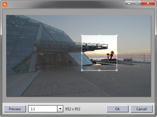

Menu Bar
Preview: Opens a preview window to display the selected crop.
Target Ratio: Select a ratio from the drop-down list and then select a crop in the edit area. (Manual ratio, Original ratio, 4:3, 16:9, 1:1).
Selection Size: Displays the pixel dimensions of the selected crop.
OK: Use the selected crop.
Cancel: Resets editing and closes the Crop Service window.
Edit Area
Drag the anchored frame to move the selected crop area.
Resize the anchored frame to change the selected crop area.
Cropping an Image with Crop Service
If AlwaysUseCropTool or DestHeight and DestWidth are set in the template, Crop Service will open automatically when an image is dragged to the image placeholder.
Select the desired area
Optional: Click Preview to preview the selection
Click OK to confirm the selection
