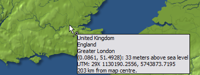

To Add a Country or Region from the Map to the Details List
Click the Browse Map (image-20240927-120700.png) tool.
As you move the pointer over the map, the name of each country and region is displayed:

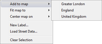

Click the map with the right mouse button and point to Add to map on the context menu, and click the feature you want to add:
