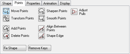

The options on the Points panel allow you to adjust individual points on a shape, and provides the following options:
  • Move Points: Allows you to move points, or adjust their tangent handles.
  • Transform Points: Lets you rotate one or more selected points as a unit.
  • Add Points: Allows you to add points to a shape outline.
  • Delete Points: Click a point to delete it from the shape outline.
  • Sharpen Points: Click a point to convert a curve point to an angle point.
  • Smooth Points: Click a point to convert an angle point to a smooth curve point.
  • Align Between Points: Click two points to align intermediate points into a straight line.
  • Shape Edge: Allows you to soften the edge of a shape.
  • Adjust Pulls: Allows you to adjust each point by pulling each point’s handle.
  • Fix Shape: Adds a keyframe (for example, to an animated path).
  • Remove Keys: Removes a keyframe. Use Next Shape and Prev Shape keys to jump between the keyframes.

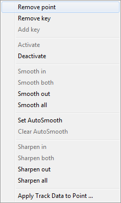

When any of the tools on the Points panel are selected you can also right-click and select an option from the appearing context menu:
To Activate or Deactivate a Point
  1. Select a shape from the Layers list.
  2. Select the Contents tab and then the Points tab.
  3. Select the Move Points tool.
  4. Right-click and from the appearing context menu click Deactivate or Activate on the pop-up menu. A deactivated point is stored with the shape, but does not affect the shape.
