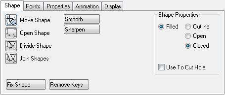

The options on the Shape panel allow you to edit the entire shape:
It provides the following options:
  • Move Shape: Allows you to move, stretch, or rotate a shape.
  • Open Shape: Opens a shape at a selected segment or point.
  • Divide Shape: Divides a shape into two shapes.
  • Join Shapes: Joins two shapes.
  • Smooth: Converts all the points on a shape from corner points to curve points.
  • Sharpen: Converts all the points on a shape from curve points to corner points.
  • Filled/Outline: Specifies whether the shape is filled.
  • Open/Closed: Specifies whether the segment between the endpoints should be drawn.
  • Use To Cut Hole: Makes the shape cut a hole in shapes below it in the Shapes list.
  • Fix Shape: Adds a keyframe (for example, to an animated path).
  • Remove Keys: Removes a keyframe. Use Next Shape and Prev Shape keys to jump between the keyframes.
