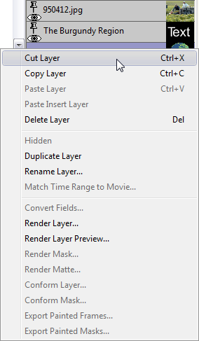

To Cut or Copy a Layer
Either:
Select the layer.
On the Edit menu, click Cut or Copy, or click the Cut Selection or Copy Selection button on the toolbar.
Or:
Right-click the layer and from the appearing context menu select Cut Layer or Copy Layer.
To Paste a Layer
Either:
Select the layer.
On the Edit menu, click Paste or Paste Insert, or click the Paste button in the toolbar.
Or:
Click the layer with the right mouse button, and click Paste Layer or Paste Insert Layer on the pop-up menu.
Paste Layer: Adds the layer to the top of the Layers list.
Paste Insert Layer: Adds the layer above the currently selected layer.
To Delete a Layer
Either select the layer, then in the Edit menu, click Delete Selection , or click the Delete Selection button in the toolbar. Alternatively, you can click the layer with the right mouse button, and click Delete Layer on the pop-up menu.
To Duplicate a Layer
Hold down CTRL and drag the layer you want to duplicate to the appropriate position in the Layers list.

To Rename a Layer
Either:
Select the layer.
On the Layer menu, click Rename.
Or:
Right-click the layer and from the appearing context menu click Rename Layer. The above dialog box allows you to enter a new name for the layer.
Then enter the name and click OK.
