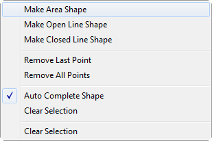

To Complete the Shape to Make an Area Shape
Either click the Area button in the floating Shape palette or right-click and select Make Area Shape from the appearing context menu:
  • The shape is closed and displayed, drawn with the current area style:
To Complete the Shape to Make a Line Shape
Either click again on the last point you drew, or:
  • Click the Closed Line or Open Line button in the floating Shape palette, or
  • Right-click the shape and select Make Open Line Shape or Make Closed Line Shape from the appearing context menu. The shape is drawn with the current line style:
