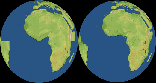

An essential setting for 3D globe building in Viz Artist is To Set the Map Projection to an equidistant cylindrical projection (also known as equi-rectangular or geographic projection). When using the map on a 3D globe in Viz Artist, it gives a more correct representation of the world.
Note: In Viz Artist, vertex mapping should be used when creating 3D globes.
Distorted Projection
Using the wrong projection within Viz Artist (for example, with the Map Tiler plug-in to build a 3D globe) produces a distorted projection.
