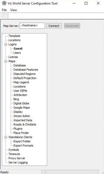

User Interface
The server configuration window has two panes, the left pane displays the configuration sections and the right pane displays the parameters of the selected section.
Before using the configuration tool, a connection to the server must be established. When a connection is established, the Connect button is disabled and the Disconnect button is enabled. The right pane is populated with the parameters of the selected section.
When connected, the main configuration window appears as follows:

To Connect to the Server
Enter the server name or IP address in the Map Server field, and click Connect.

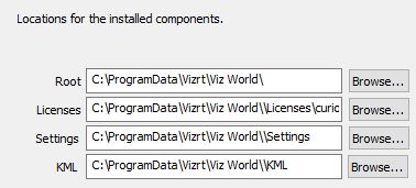

Locations
The Locations section defines the path to the required software components.
  • Root: Defines the installation folder.
  • Licenses: Defines the license file(s) folder.
  • Settings: Defines the path to the settings folder.

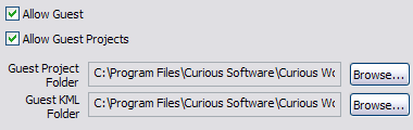

The Logins > Users section displays the users configured on the server. Viz World Clients use the pre-defined Guest user to log on to the server.
The Logins > Guest screen is used to set some of the guest user permissions.
Note: Users are added and removed from Viz World Classic only.
  • Allow <user name>: Allows the user to connect to the server when running WME or Viz.
  • Allow <user name> Projects: Allows the user to access projects defined in the <user name> Project Folder.
  • <user name> Project Folder: Defines the path to a folder containing the user’s projects.

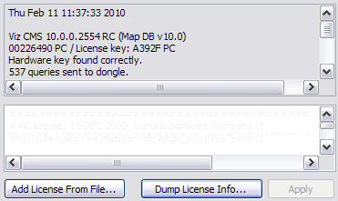

License
The License section displays information about the current server license and enables the user to load other license files.
Note: If the license is not valid, the server will not start.
  • Add License From File: Opens a file browser that enables the user to load additional license features from a different license file and to add it to the system. After a new license file is added, the Apply button is enabled.
  • Dump License Info: Saves the license information, that is displayed in the text box, to a file.
  • Apply: Applies the new license information to the system’s license file.
To Manually Add a License File
Locate the License file (*.lic), copy and paste it into the Licenses folder:
  • 32-bit: C:\ProgramData\Curious Software\Curious World Maps\Licenses
  • 64-bit: C:\ProgramData\vizrt\Viz World\Licenses
To Add a License File Using the Maps Server Configuration Tool
  1. Start the server configuration tool.
  2. Select the License section.
  3. Click the Add License From File ... button.
  4. Locate and select the file and click Open to add the new license file. The license becomes visible in the Edit License window.
  5. Click Restart to start the server with the new license.

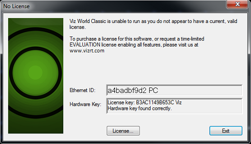

To Add a License File Using Viz World Classic
When starting Viz World Classic without a license, a window appears informing that a valid license cannot be found.
  1. Start the Viz World Classic application.
  2. Click the License button to open the Software License window.
  3. Click the Edit License File ... button to open the Edit License window.
  4. Click the Add License from a File... button to browse for the License file (*.lic).
  5. Select the License file and click Open. The license becomes visible in the Edit License window.
  6. Click OK to save the License. The license is saved in the License folder.
  7. Exit the application and run the Viz World Server.

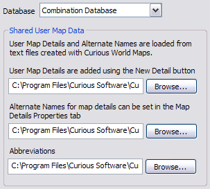

Database
  • Database: Selects the database type. It only displays location entries that are visible in the map area.
  • Shared User Map Data: Defines the source of data used by the database.

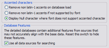

Database Features
  • Accented characters: Handles accent characters in labels such as ~ in España.
  • DataBase Features: Defines whether the WME search tool uses additional databases in the system or only the Viz World database.

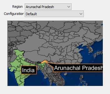

Disputed Regions
  • Region: Displays a list of the disputed regions defined in the system. Select one of the disputed regions to be configured.
  • Configuration: Displays a list of region and border options related to the selected disputed region in the Region parameter. Select an option from the list and the graphic display changes according to the selected option.

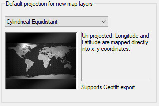

Default Projection
Sets the default projection for when a client opens a template that does not have a map layer. The following options can be set:
  • Globe: Sets a globe projection.
  • Cylindrical Equidistant: Sets an unprojected map. Longitude and latitude are mapped directly into X and Y coordinates.

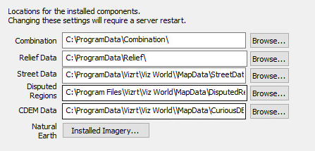

Locations
The Locations parameters define the path to folders containing relevant data for the specified parameters.

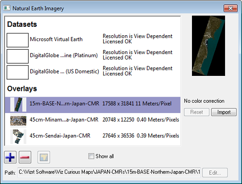

The Natural Earth option can be used to add, remove, and color correct global and/or local CMR (Curious Multi-Resolution) imagery. Global imagery is what is typically used as base maps, whereas local imagery is more detailed imagery of local places (for example, coastal areas and cities).

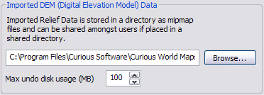

User DEMs
The User DEMs (Digital Elevation Models) define the path to a folder containing elevation data.

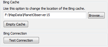

Bing
Bing Maps Platform (previously known as Virtual Earth) is a set of images (satellite and others) stored on Microsoft’s Bing Maps Platform servers. The images can be used by Viz World Classic but requires a credit mark (Attribution image) to be displayed on the screen.
  • Bing Cache: Defines a cache folder for the images retrieved from the Bing Maps Platform server.
  • Empty Cache: Deletes all files from the cache folder.
  • Bing Connection: Allows you to test that the Bing Maps Platform server is online.
Note: Microsoft Bing requires an internet connection and does not work without a license.

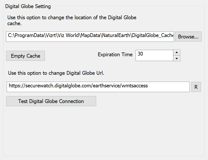

Digital Globe
  • Digital Globe cache: Sets the location of the Digital Globe cache. For reference, see the Bing section.
  • Digital Globe URL: Displays the URL of Digital Globe endpoint.
Note: Digital Globe requires an internet connection and a license. If used without a license a watermark appears.

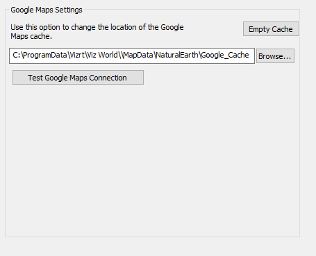

Google Maps
  • Empty Cache: Clears the cache.
  • Cache location: Sets the location of the Google Maps cache. For reference, see the Bing section.
  • Test Google Maps Connection: Tests the connection.
Note: Google Maps requires an internet connection and a license.

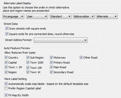

Display
  • Alternate Label Display: Sets a custom language and defines the labels’ source priority, affecting the list of label options displayed to the user. For creating multi-language files and using them see the Map Name Editor and the Using the Map Name Editor sections.
  • Street Data: Defines the visual properties of street edges when drawn on the maps.
  • Auto Feature Preview: Defines what features are shown in Viz World’s Map Editor (WME) when pressing the auto features button.
  • More Label Settings
    • Prefer Region Capital Label: When turned On the auto-features force the type of feature to Region Capital instead of based on the default feature size (for example, Town 1K, Town 1M).
    • Automatically scale map labels: When this option is checked, changing the size of a project or TPL label styles also scales the labels proportionally.
Note: This only applies to label styles created in Viz World Classic and used with the Map Editor Classic.
  • Fit Map by Width

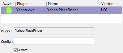

Plug-ins
A list of plug-ins that are used for searching the web (not the Viz World database).

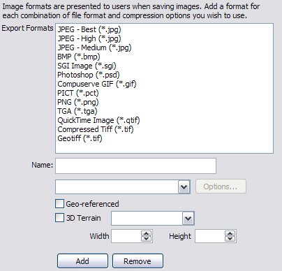

Standalone Clients
A standalone client is an application running WME on machines without a Viz installation.
  • Export Folder: Defines the save path for standalone client applications.
  • Export Formats: Image formats are presented to users when saving images. Add a format for each combination of file format and compression options you wish to use. The Options button allows you to set color (black and white, grayscale, 256 colors, etc.), and filter options.

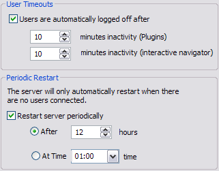

Timeouts
This section is used to set server timeout values.
  • User Timeouts: Sets the timeout values for clients logged onto the server:
    • Minutes Inactivity (Plugins): Sets the timeout for client connections when the WME is opened through the CMWClient plug-in. If no map requests are sent to the server during the period of time (in minutes) specified in this parameter, the server disconnects the client.
    • Minutes Inactivity (Interactive Navigator): Sets the timeout for client connections when an interactive Navigator scene is used. If no map requests are sent to the server during the period of time (in minutes) specified in this parameter, the server disconnects the client.
  • Periodic Restart: Enables automatic restarts of the server. It is mainly targeted at 24/7 stations, where Viz Engines are up and constantly requesting maps. The Automatic restart enables the server to restart at the specified time or after a defined period of time, disconnecting all clients and clearing used memory. This is important when the server is used heavily and a lot of maps are generated.
    • Restart server periodically: Sets the server to restart periodically based on the After or At Time parameters.
    • After: Sets the amount of time (hours) for how long the servers should be running before the server should be automatically restarted.
    • At Time: Sets the time for when the server should be restarted.
