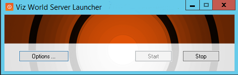

Server Launcher
Viz World Server Launcher is a tool used to start, stop and configure the Viz World Server and Server Allocator. In addition, it also starts a process that generates thumbnails of map templates used by the Viz World Client’s Map Designer tool.
Using Server Launcher
The Server Launcher is an application installed as part of the Viz World Server, and can be found on the programs menu. The Server Launcher is run as a service by default.
When the Server Launcher is configured, the Server Allocator distributes client requests between the registered servers and server machines, balancing server loads and the number of client requests. When configured in a complex environment, multiple map servers with multiple Server Allocators can be used to allow full redundancy and optimal resource distribution.
Starting a single instance of the maps server can be done from the program menu or by using the desktop icon.
Starting the Server Allocator, in order to setup a redundant system and/or configure more than one instance of the map server on one server, is done using the Server Launcher.
When the Server Launcher is running, it typically floats on top of the desktop, but it can be minimized to the tray.

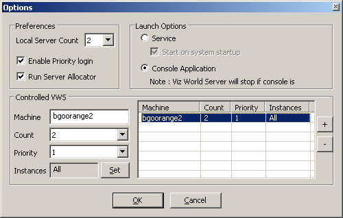

Server Launcher Configuration
Viz World Server is configured using the Server Launcher.
Click the Server Launcher’s Options button in order to configure the map server.
  • Preferences: Allows the user to set the local server count and enable the Server Allocator.
    • Local Server Count: Defines the number of server instances that run on the machine simultaneously. Default value is 1. When setting the number of instances for each machine, machine hardware should be considered. Every server instance requires physical memory (RAM) and makes intense use of the CPU. Do not abuse this parameter, since client and server performance are affected.
    • Enable Priority Login: Enables Viz World Server to prioritize its inbound client connections. Viz’ configuration interface allows you to prioritize client connections from Viz Artist and On Air Viz Engines used for preview and program output. Viz Engines must be in On Air mode for them to be prioritized. For the Map Editor, you can set it from the Context Menu. For more information on how to set priorities see the Maps Configuration section.
    • Run Server Allocator: When disabled (not selected), the Server Allocator do not run on the machine. When enabled (selected), the Server Allocator runs and uses the parameters defined in the Server Launcher’s Options window. Default mode is disabled. Server Allocator does not require any license and can be run on any machine.
Important! If the Server Allocator is enabled, even for just one machine, the machine must be defined in the Controlled WoS list.
  • Launch Options: Allows the user to run Viz World Server and the Server Launcher as a service, or in console mode. If run as a service, the system can automatically start all server instances when the machine starts without the need to login. If run in console mode, all instances must be manually started.
  • Controlled WoS: When enabled (see Run Server Allocator), the Controlled WoS settings allows the user to configure the controlled WoS instances.
    • Machine: Sets the name of a machine running Viz World Server.
    • Count: Sets the number of instances running on the machine. Default is 1.
    • Priority: Sets the machine’s priority. If more than one machine is defined, the priority must be set for each machine.
    • Instances: Sets the number of instances that are controlled by the machine. If the machine has more than one instance running, it is possible to open the Instance Control (click Set) To Set the Controlled Instances.
Note: When the Server Allocator allocates a server to a client, it passes this name to the client, hence, its hostname/IP address must be accessible to all clients.

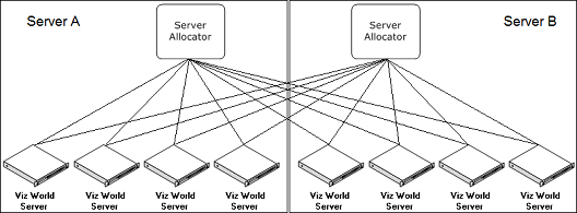

Multiple Server Allocator Configuration: Classic Redundancy
Having multiple servers, where in each there is a Server Allocator running that controls all WoS instances of all machines.
This configuration guarantees most redundancy as each Server Allocator is updated with the current status of all WoS servers, and in case of a failure in one of the machines, other Server Allocators can provide redirection to any available WoS.
The maximum number of server instances that can be run per machine is four. Each server instance should have 4 GB of memory and two CPUs. So on a machine with four dual CPUs and 16 GB of memory, you can run the maximum of four server instances.
The above diagram describes a system with two machines running a Server Allocator and four map server instances on each machine. If the client is configured with both machine names, full redundancy within the system is accomplished.
