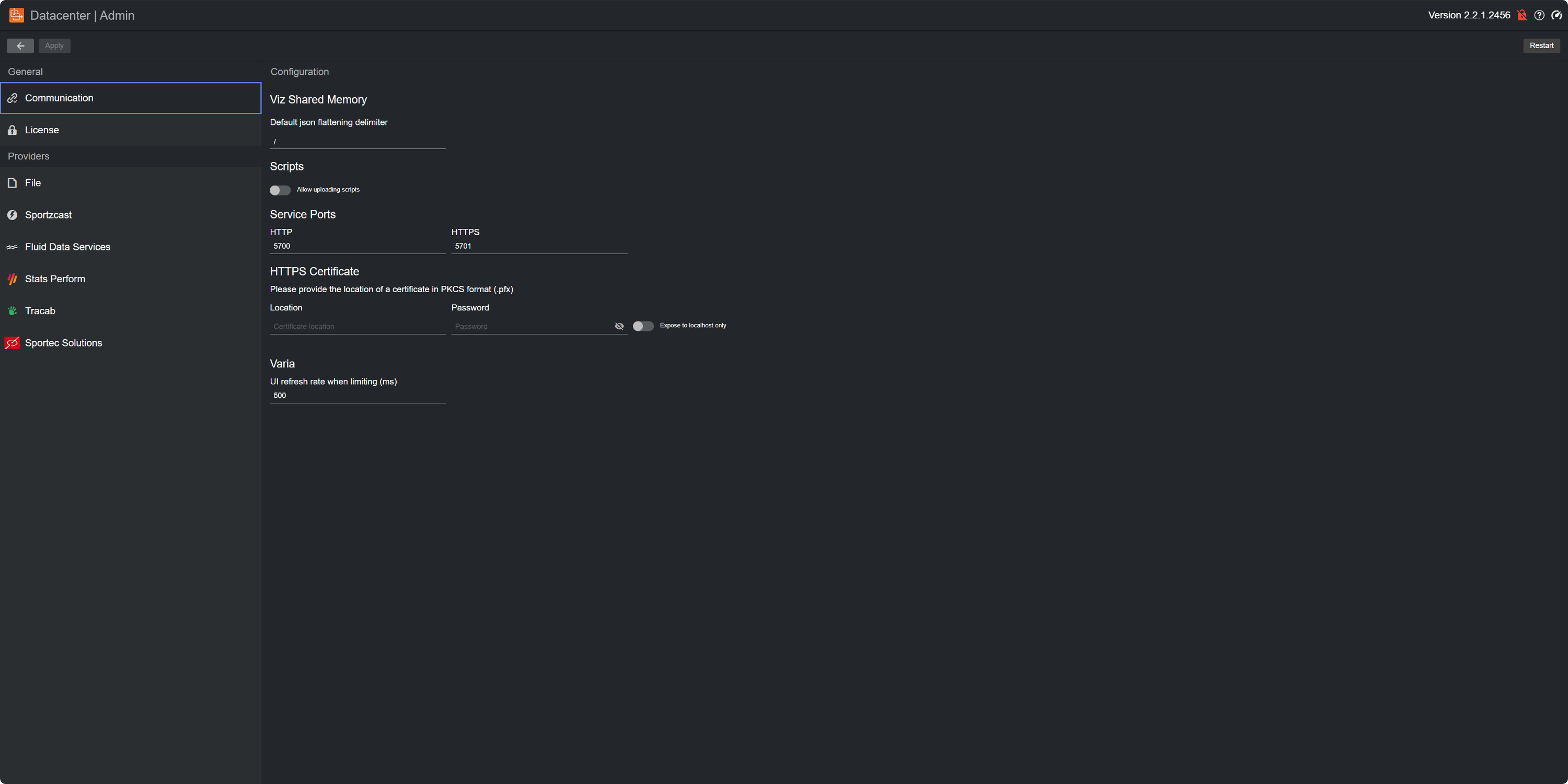

The General configuration page is where you can configure settings related to the Datacenter service:

Communication
Under communication you can configure the shared memory and your HTTPS certificate.
Viz Shared Memory
The json flattening delimiter specifies the delimiter to use when flattening an incoming JSON payload. The default value is \.
Note: The character \ cannot be used in SHM keys used on Viz Engine with control channels. When control channels are used, nested channels in your scene can be accessed via the . character. Therefore, it can be used as a delimiter to map to control channels in the scene.

Service Ports
By default, Datacenter uses ports 5700 and 5701 for HTTP and HTTPS communication, respectively. Should any of these ports be unavailable for the system, they can be changed in the dedicated text input field.

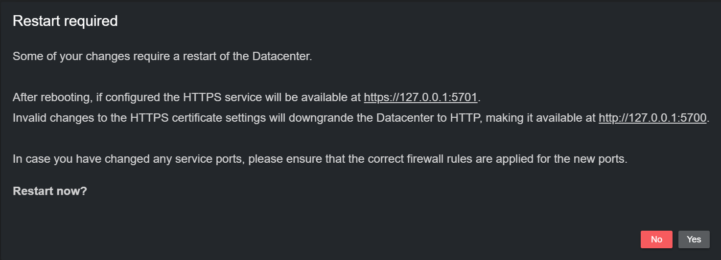

After clicking the Apply button, a dialog prompts you to confirm whether you want to restart the service using the newly configured ports. Please note the new addresses.
Firewall Exceptions: By default, the Datacenter installer, installs firewall rules for ports 5700 and 5701. When changing the service ports, you must ensure that correct firewall rules are applied for them, otherwise Datacenter may be unreachable.

A dialog prompts you to confirm whether you want to restart the service, as it is required to upgrade to HTTPS.

Set the UI refresh rate when limiting (ms) to the desired milliseconds to control the slowing-down factor of the UI refresh rate when running in limited refresh rate mode (the Application Bar shows the speedometer icon in yellow Documentation - Page 1 (6).jpeg).

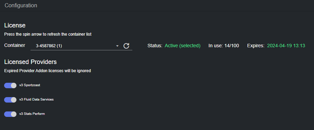

License
In this section you can configure the license to use with Datacenter, as well as the licensed providers. Without a valid Datacenter Core V3 license, no outputs can be configured, nor datasets created, thus no data is streamed out of Datacenter. Additionally, certain providers require specific addons license.

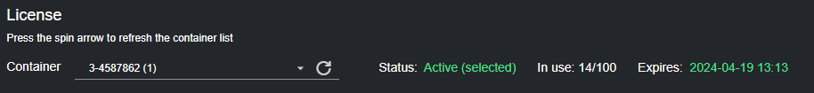

Datacenter requires a WIBU based software license. The CodeMeter license service checks for available licenses and presents the relevant license containers in a dropdown menu next to the License label.
When selecting a license from the list, its information is shown on the right. Additionally, the available (and not expired) Providers license addons on the container, are listed as toggles.
If you do not see the container you wish to use, click the refresh button image-2023-8-14_15-50-46.png to trigger a new scan of available licenses.
The currently selected container is listed as Active (selected) in the information line. The available containers and expiration date are also shown in the same line. If the license is not expired, its expiration date is shown in green:
Conversely, expired licenses list their expiration date in red. Similarly, licenses that are not selected, are listed as Inactive (not selected).
After choosing a container, please allow the software to fetch the licensed providers addons, and then select the ones you want to use from the list of toggle buttons that appears next to the Licensed Providers label. When done, click on Apply changes.
