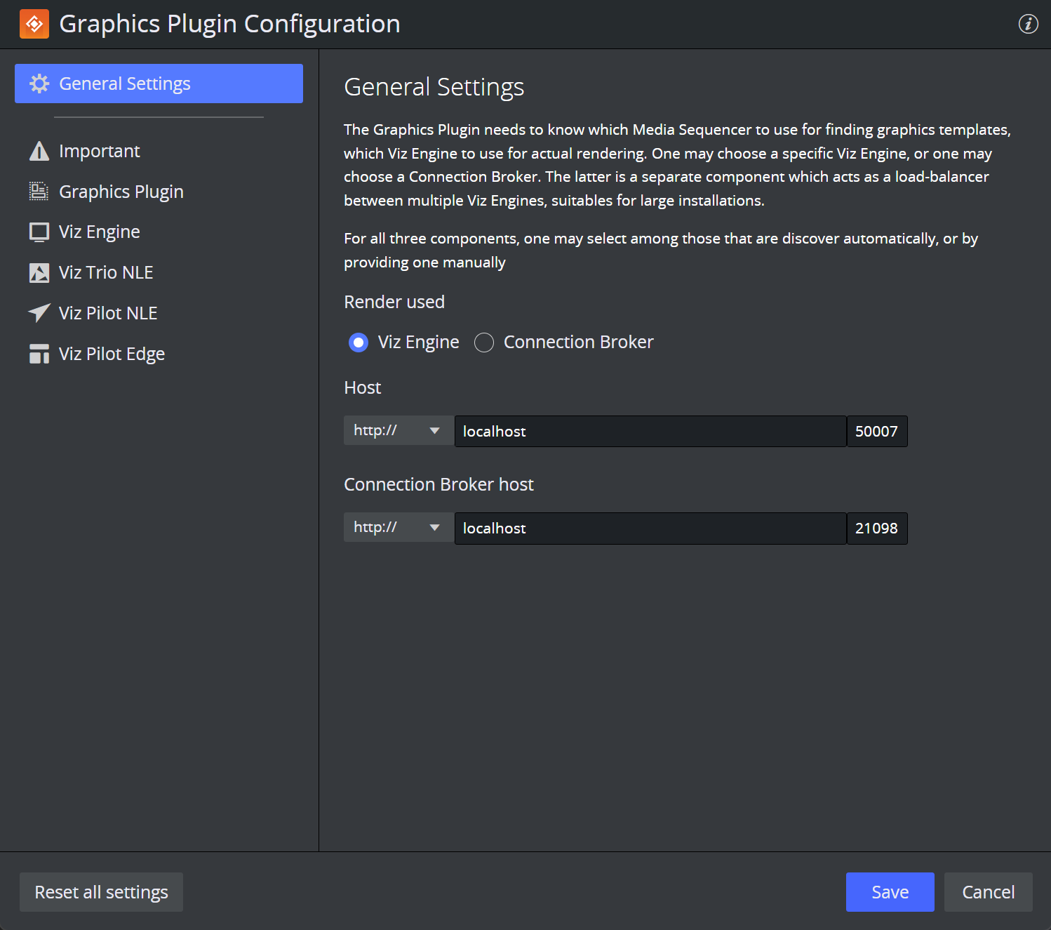

The General Settings section is selected by default with the following settings:
Render used:
Viz Engine or Connection Broker: Specify one for rendering.
Info: Connection Broker is a separate component that acts as a load-balancer for multiple Viz Engines. It is suitable for big installations.
A description of configurable settings below the General Settings section, follows:

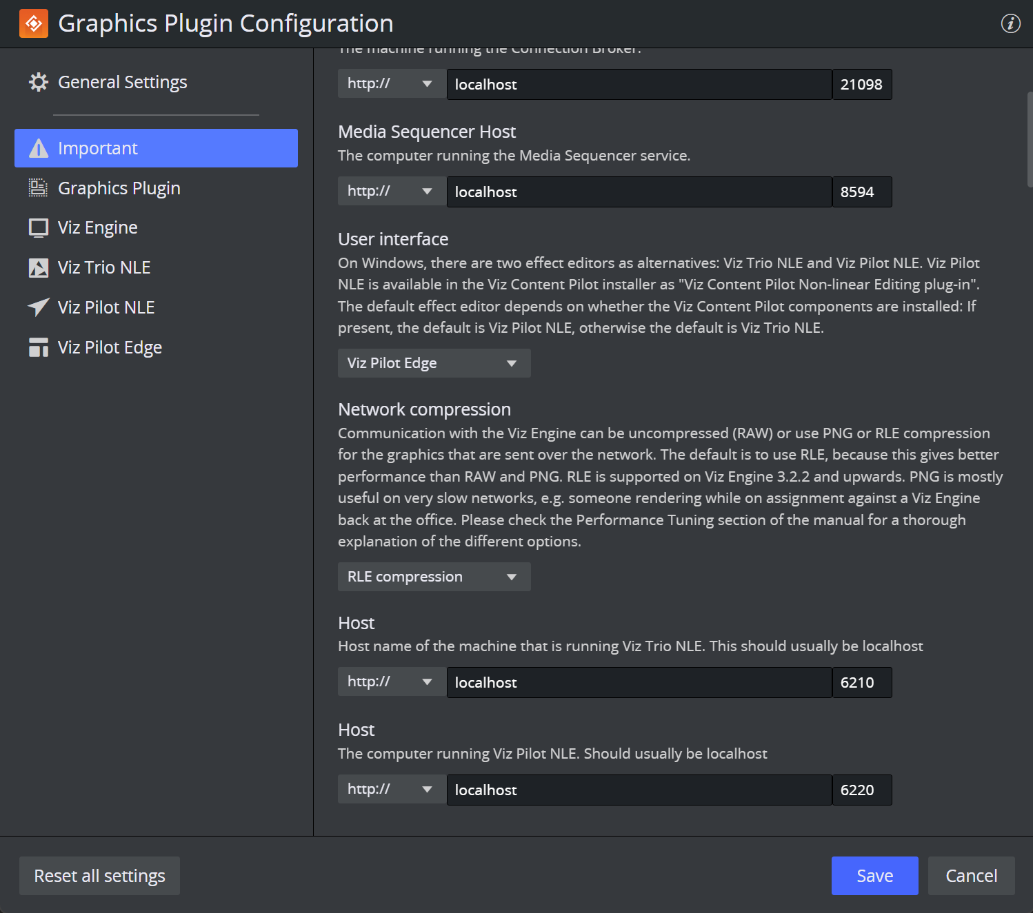

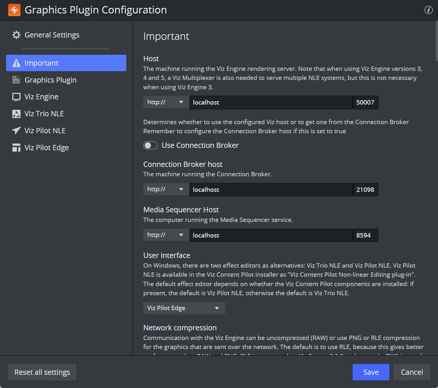

Shows the most important settings needed to run Graphics Plugin:
Host Viz Engine: Sets the hostname or IP address of the Viz Engine renderer.
Use Connection Broker: See Connection Broker in the Graphics Plugin Administrator Guide.
Connection Broker host: Sets the host of the computer running the connection broker.
Media Sequencer Host: Sets the host of the computer running the Media Sequencer service.
User Interface: See User Interface.
Network compression: See Network compression under Viz Engine.
Viz Trio NLE Host: Defines the hostname of the machine running the Viz Trio NLE. Typically localhost.
Viz Pilot NLE Host: Defines the hostname of the machine running the Viz Pilot NLE. Typically localhost.

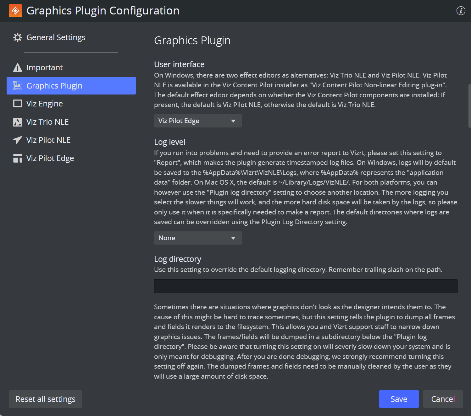

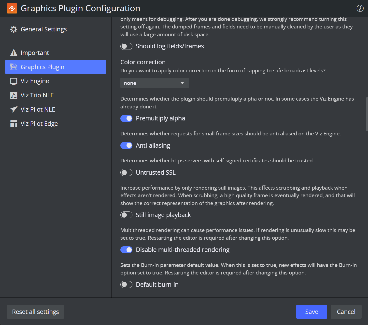

Graphics Plugin
User Interface: Sets the interface to use for selecting graphics templates.
Templates using the same scene but opened from Viz Trio, Viz Pilot or Viz Pilot Edge are different entities. Once an editor is set and used to add a graphic effect to the timeline, the effect is also bound to that editor. To create an effect with a template from another editor, the old effect must first be deleted, a new editor configured, and then a new effect created.Log Level: Set the log level to provide an error report to Vizrt. Only do so when you need to make a report, as this slows down the plugin. See the Log Files section in the Graphics Plugin Administrator Guide for more information on log file locations.
None: Logs errors only, which is the default behavior.
Report: Generates dated log files. In almost every case, the log files include enough information to allow Vizrt to identify the issue.
Extreme: Generates a very large amount of logging information.
Log directory: Use this setting to override the default logging directory. See the Log Files section in the Graphics Plugin Administrator Guide for more information on logging.

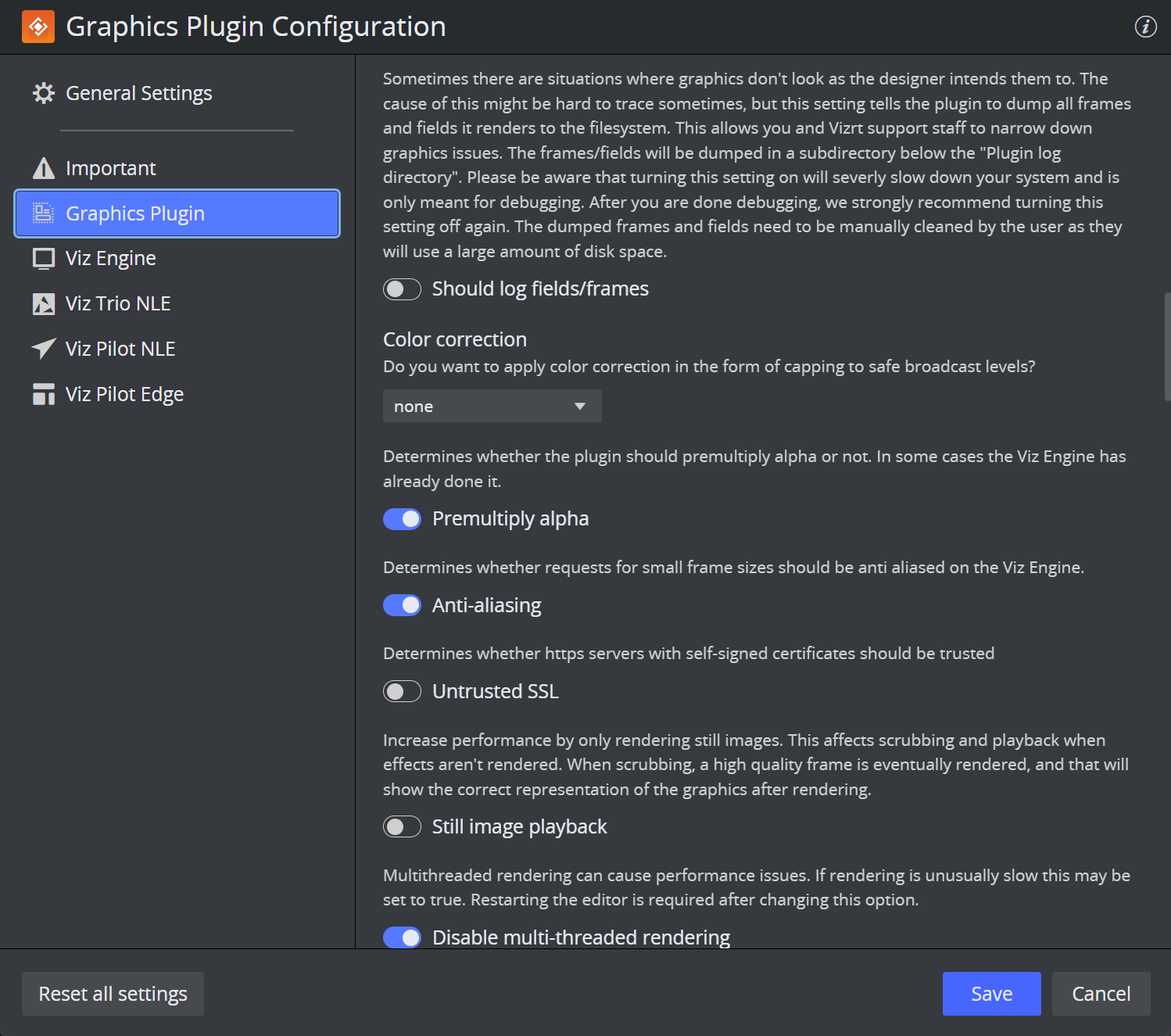

Should log fields/frames: Enables the plugin to dump all frames and fields it renders to the file system, allowing the user and Vizrt support to identify issues related to the graphics. Files are dumped in a sub-directory of the Log directory.
Color correction: Enables broadcast-safe colors. Set cap-601 to cap high and low values directly to get 16-235. Set linear-cap-601 to perform a linear recalculation of the data to 16-235. The default value is None.
Note: The background videos (or images) should also be at safe levels to prevent darkening on semi-transparent pixels.
Premultiply alpha: Configures whether the plugin pre-multiplies alpha when rendering. In some cases, the Viz Engine has already multiplied the color channels with the alpha channel.
Anti-aliasing: Controls whether requests for small frame sizes should be anti-aliased on Viz Engine.
Untrusted SSL: Controls whether HTTPS servers with self-signed certificates should be trusted.
Still image playback: Only renders still images to increase performance when low-quality frames are requested, affecting scrubbing and playback. A high-quality frame is rendered upon scrubbing, which shows the correct representation of the graphics after rendering.
Disable multi-threaded rendering: Causes performance issues when too many threads try to render at the same time. If rendering is unusually slow, this may be set to true. You must restart the NLE application after changing this setting.
Note: The option to Disable multi-threaded rendering is only available for Adobe Premiere Pro and Avid Media Composer.
Default burn-in: Default state of the Burn-in option on new effects.
Note: The option Default burn-in is only applicable to Avid Media Composer.

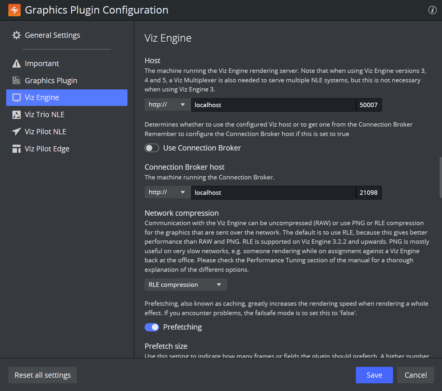

Viz Engine
The Viz Engine Settings view is shown below:

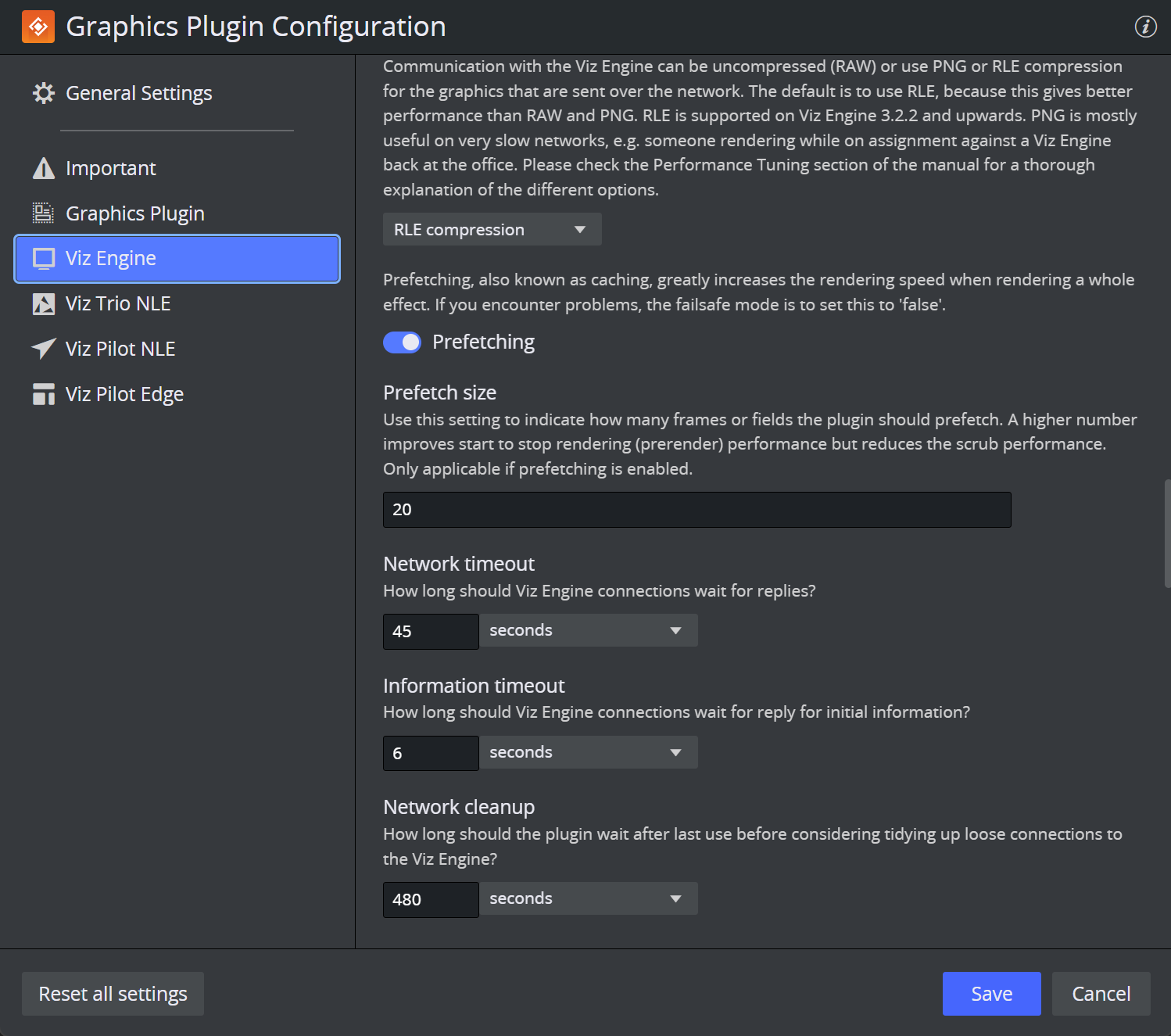

Host: Sets the hostname or IP address of the Viz Engine renderer.
Use Connection Broker: Enables Graphics Plugin to connect to the Connection Broker for graphics rendering.
Connection Broker host: Sets the hostname or IP address of the Connection Broker.
Network compression: Sets the compression level. It is recommended to use no compression on gigabit networks, and compressed formats on slower networks (e.g. 100mbit). The default value is RLE.
No Compression: Sends all frames across the network uncompressed (for gigabit networks).
PNG (Portable Network Graphics): A lossless compression format.
RLE (Run-length Encoding): A lossless compression format. RLE is only supported by Viz Engine 3.2.2. and later versions (see the Software Requirements section on the Graphics Plugin Administrator Guide).
Prefetching: Prefetching, also known as caching, greatly increases the rendering speed when using start to stop rendering, like Pinnacle's yellow slices, or Avid's pre-render effect mode.
Failsafe mode is off.
Default value is on.Prefetch size: Use this setting to indicate how many frames or fields the plugin should pre-fetch. A higher number improves start to stop rendering (pre-render) performance but reduces the scrub performance. Note that this option is only available if pre-fetching is enabled. Prefetch values above 50 are ignored. Default value is 20.
Network timeout: Controls how long Viz Engine connections wait for replies. Unless network measurements for Viz Engine have been performed, this setting should not be changed. Default value is 45 sec.
Information timeout: Controls how long Viz Engine waits for a reply for initial information. This setting should not be changed unless network measurements of Viz Engine have been performed.
Network cleanup: Controls how long the plugin waits after last use before cleaning up loose connections to Viz Engine. This should not be changed unless the actual use of the plugin has been measured. Default value is 8 mins.

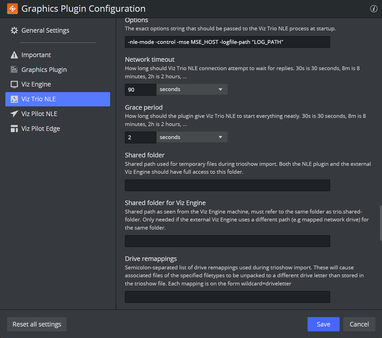

Viz Trio NLE
Host: Sets the hostname or IP address of the Viz Trio renderer.
Executable: Name of the editor's executable file. Can be changed if a different filename is in use. Default value is trionle.exe.
Options: The exact command line options string passed to the editor’s process at startup. For more information on command line options, see the Startup Variables section.
Network timeout: Controls how long connections to Graphics Plugin Editor wait for replies. This should not be changed unless network data for the Graphics Plugin Editor has been measured. Default value is 90s.
Shared folder: Shared path used for temporary files during import of Viz Trio shows. Both the Graphics Plugin and the external Viz Engine should have full access to this folder.
Shared folder for Viz Engine: Shared path as seen from the Viz Engine machine, must refer to the previous setting. Only required if the external Viz Engine uses a different path (such as a mapped network drive) for the same folder.
Drive remappings: Semicolon-separated list of drive remappings used during import of Viz Trio shows. These will cause associated files of the specified file types to be unpacked to a different drive letter rather than stored in the *.trioshow file. Each mapping is in the form wildcard=driveletter.

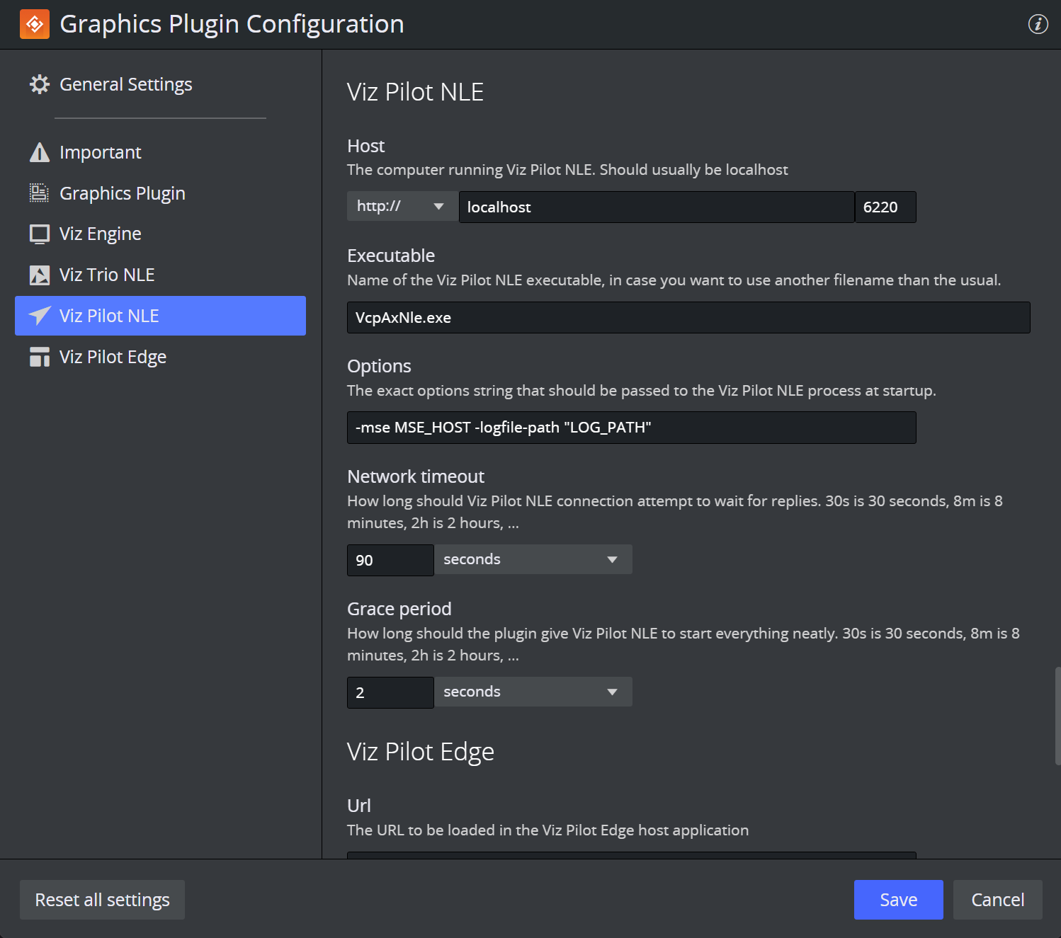

Viz Pilot NLE
Host: Sets the hostname or IP address of the Viz Pilot NLE renderer.
Executable: Name of the editor's executable file. Can be changed in case another filename is in use. Default value is VcpAxNle.exe.
Grace period: Controls how long Graphics Plugin waits for the editor to start everything without interruptions. Default time is 2s.

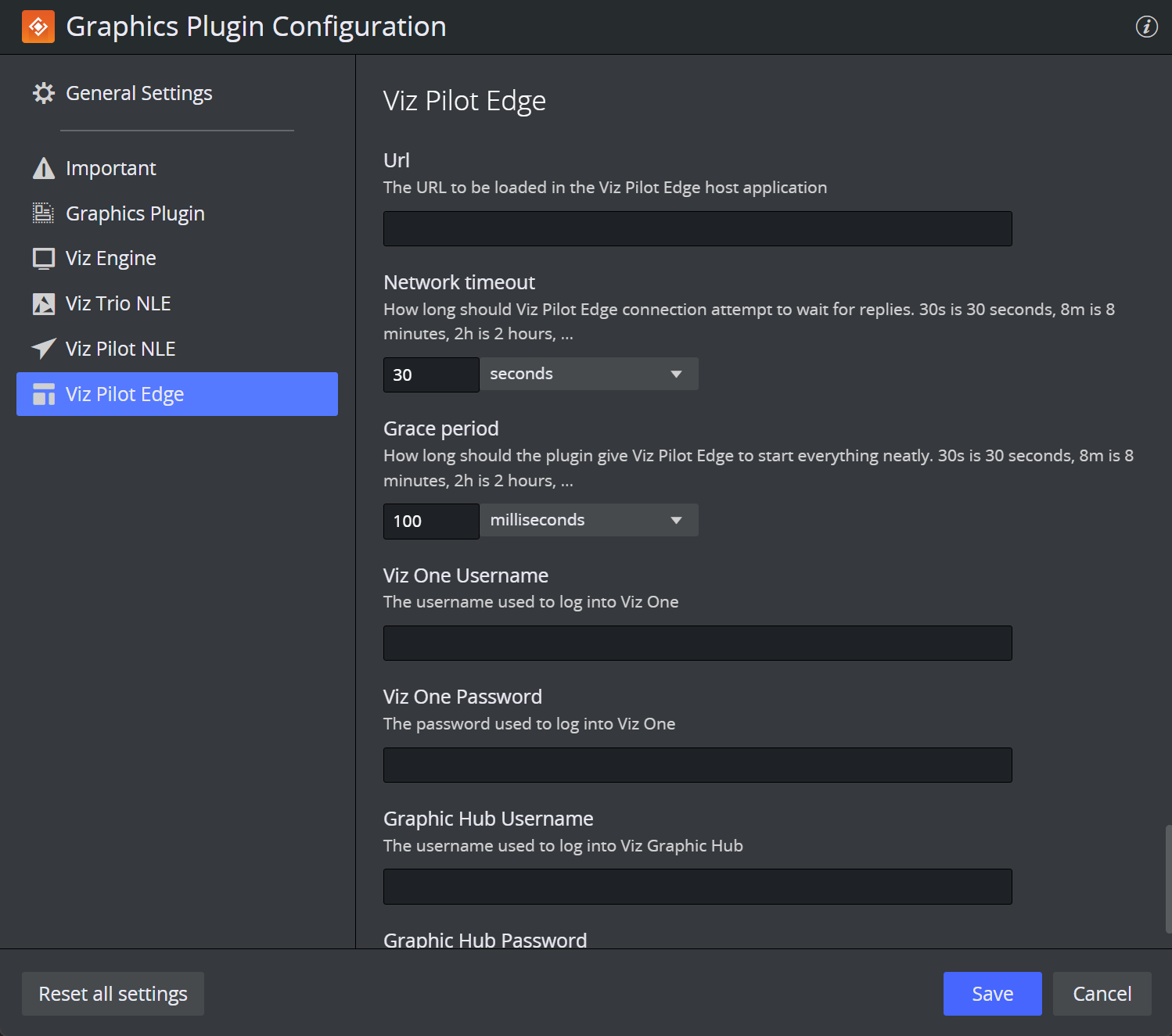

Viz Pilot Edge
Host: Sets the hostname or IP address of the Viz Pilot Edge renderer.
Executable: Name of the editor's executable file. Can be changed in case another filename is in use. Default value is payload_editor.exe.
Viz One Username: The username to log in to Viz One.
Viz One Password: The password to log in to Viz One.
Graphic Hub Username: The username to log in to Graphic Hub.
Graphic Hub Password: The password to log in to Graphic Hub.

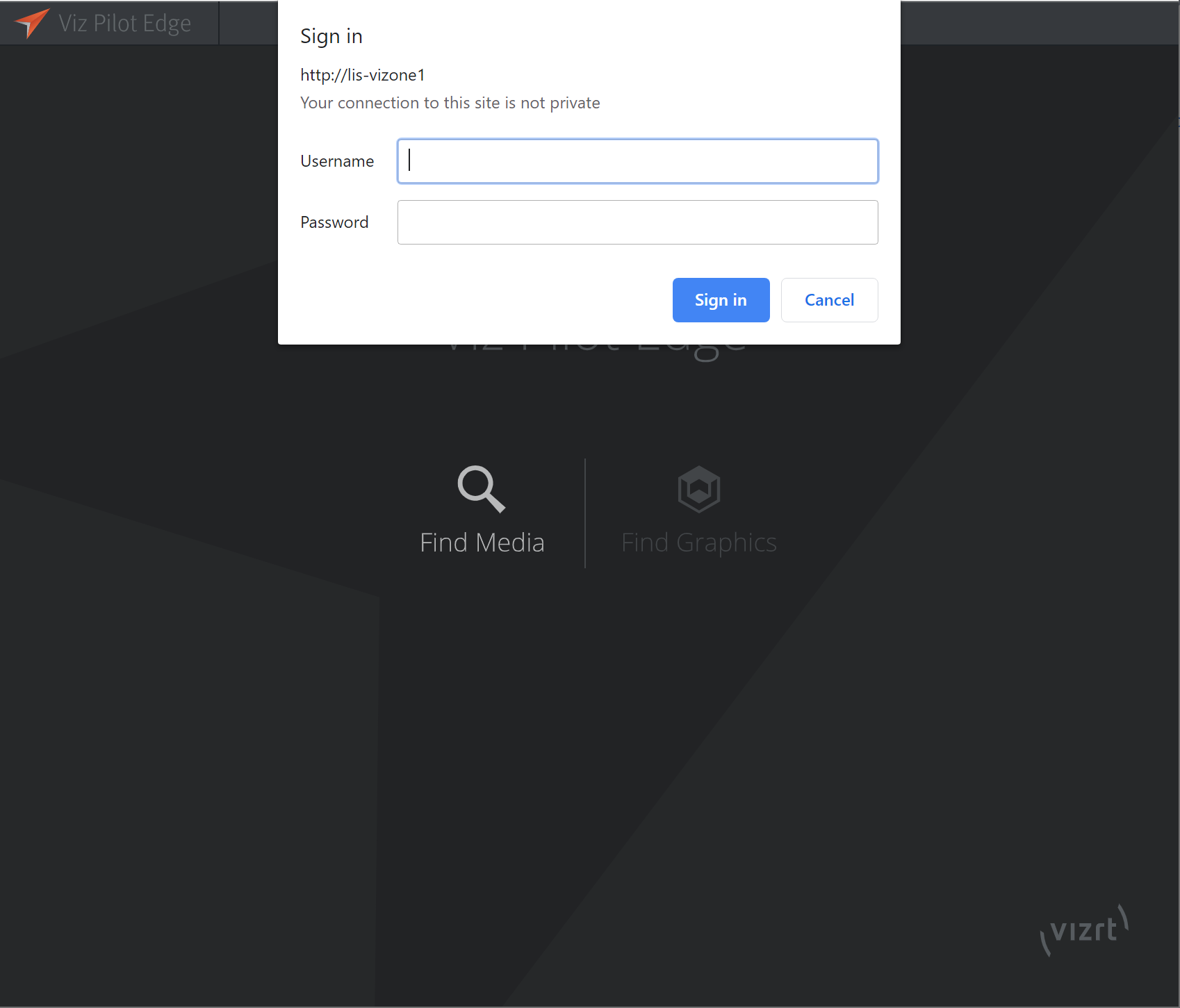

When using Viz Pilot Edge in a Regular Browser (Chrome/Firefox/IE)
The popup below appears if Pilot Data Server is configured to use a Viz One server, or you have manually specified a Viz One server via URL parameters (by appending ?vizone=hostname to the end of the URL), but no default password has been configured in Pilot Data Server settings. If the username and password are not entered, the server's media is unavailable for the duration of the session and it is not visible while browsing Viz Pilot Edge.
Note: As the pop-us are not shown when Viz Pilot Edge is used via the NLE Editor, any authentication requests fail silently. This can be fixed by filling in the Username and Password fields. If the server requests additional authentication for either Viz One or Graphic Hub, the above fields are used. However, if the server does not request Viz One or Graphic Hub credentials, either because valid credentials already exist in the server side, or because no Viz One or Graphic Hub is configured, these fields are silently ignored.

Startup Variables
Options are used as variables for the actual value set for the plugin. The options can be used as part of an editor’s startup options.
The following options are available and configurable:
MSE_HOST: References the active Media Sequencer host.
Example: -mse MSE_HOST
LOG_PATH: Refers to the currently used Plugin log directory.
Example: -logfile-path "LOG_PATH"
Note: The startup options are only valid for NLE editors on Windows.

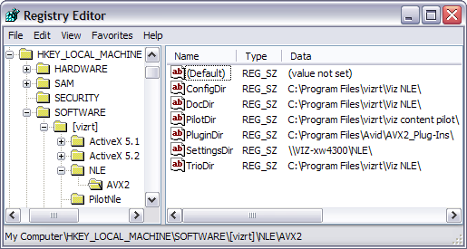

Shared System Settings
This section covers the shared settings feature that is available to Windows users in the system registry.
The system stores the settings in a per-user directory, for example under C:\Documents and Settings\<username>. Placing the same file in a shared directory allows multiple users to use a standardized setup overriding per-user settings.
Note: Shared settings do not apply to Mac users.
By adding a Windows registry entry with a path to the master configuration file, the settings in that file take precedence over the default values for the various settings, but the individual settings that the user changes in the Graphics Plugin configuration tool take precedence over the master configuration file.
HKEY_LOCAL_MACHINE/SOFTWARE/[vizrt]/NLE/AVX2/SettingsDirGiven a particular setting, the following rules apply:
If a setting is set using the Graphics Plugin configuration tool, that value is used.
If it has a value in the master configuration file, that value is used.
The default value for the setting is used.
Adding a Shared System Setting
Start the Graphics Plugin configuration tool.
Configure Graphics Plugin using the configuration tool.
Save and exit the configuration tool.
Find the file vizplugin.xml in the current user's Application Data folder.
Copy the file to the designated shared location.
Set up the SettingsDir registry entry to point to the shared directory location where the copied file was placed.
