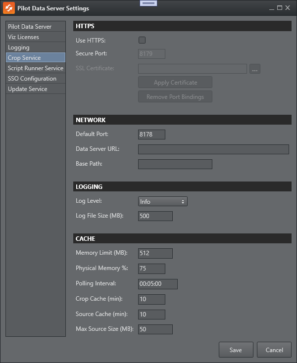

Configuration via Launcher UI
The Launcher UI is the authoritative way to configure the Crop Service. Each field maps directly to a key in the INI file.
HTTPS
Used to configure secure communication and certificate binding.
  • Use HTTPS: Check this option to enable HTTPS.
    UseHttps=True | False
    • If True service listens on SecurePort.
    • If False service listens on DefaultPort.
  • Secure Port: The default port is 8179.
    SecurePort=<port>
    It is recommended to:
    • Keep 8179 unless your environment requires a different port.
    • Ensure the port is open in host and network firewalls.
  • SSL Certificate: Used to select a certificate from the Windows certificate store.
    • Click Apply Certificate to bind the certificate to the HTTPS port.
    • Click Remove Port Bindings to remove existing HTTP.SYS bindings.
Info: The Launcher manages HTTP.SYS bindings. Do not use manual netsh commands unless explicitly required.
Network
  • Default Port (HTTP only): The default port is 8178. Only used when UseHttps=False.
    DefaultPort=<port>
  • Data Server URL: Set the URL to the Pilot Data Server service document (this must be an absolute URL). The Crop Server retrieves the Pilot Data Server settings to extract credentials to pre-authenticated hosts, and reads the croptool_max_image_area setting from the database.
    PilotDataServerUri=<absolute-url>
  • Base Path (Reverse Proxy Support): This setting is only used when the Crop Service is published under a sub-path behind a reverse proxy.
    BasePath=<path>
    For example, the public URL is https://proxy.company.com/vizrt/cropservice. Therefore, the base path value can be set to vizrt/cropservice. In most modern deployments, BasePath should NOT be needed.
    If your reverse proxy forwards standard headers and preserves the full request path, the Crop Service can derive the correct public URL from headers.
Logging
Controls log verbosity and file size.
  • Log Level
    LogLevel=<level>
    • Debug
    • Info
    • Warning
    • Error
  • Log File Size (MB): Maximum size before log cycling.
    LogFileSize=<megabytes>
Cache
These settings control memory usage and caching behavior.
  • Memory Limit (MB): Total shared memory budget across crop result cache, and source image cache. The default is 512.
    [Cache]
    CacheMemoryLimitMegabytes=<mb>
  • Physical Memory %: Hard upper cap based on system RAM. The default is 75.
    [Cache]
    PhysicalMemoryLimitPercentage=<0-100>
    This prevents the service from exhausting system memory even if Memory Limit is set high.
  • Polling Interval: Frequency of cache resource checks (hh:mm:ss). The default is 00:05:00.
    PollingInterval=00:05:00
  • Crop Cache (min): Retention time for processed crop results. The default is 10 minutes.
    CropResultCacheMinutes=<minutes>
  • Source Cache (min): Retention time for downloaded source images. The default is 10 minutes.
    SourceImageCacheMinutes=<minutes>
  • Max Source Size (MB): Do not cache source images larger than this threshold. The default is 50.
    MaxSourceImageCacheSizeMegabytes=<mb>
