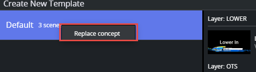

Creating a New Combo Template

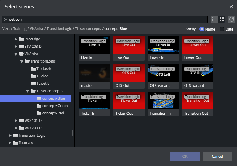

Create a new template and add transition logic scenes. The following example use Blue and Green concepts.
  • Select scenes and click OK.

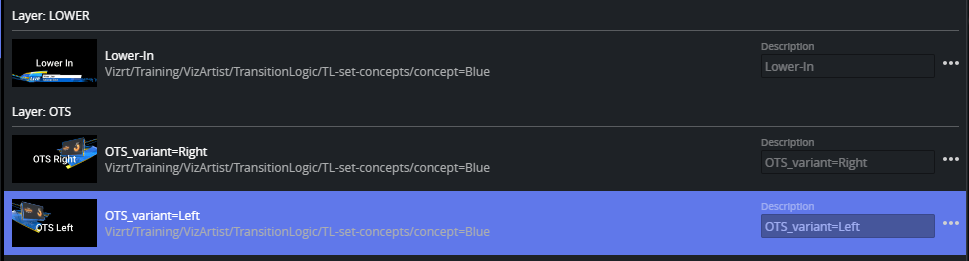

  • The new template contains transition logic and two layers, it is therefore, a combo template:
  • Right click the Default concept to replace it with a new one:

  • Click the +Add Scene button.
  • Select the scenes with the same set of control objects as those you selected for the first concept.
  • In the Fill-in form, you can now see that the template contains two concepts and two layers.
