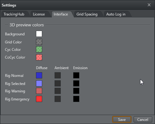

Interface Configuration
To adjust the colors to a users need, open the Settings window in Tools. In this window, the user can adjust the render colors for the visible objects in the preview panel. Click in a drop-down list to open the color selection window. The RGB and Alpha values can be adjusted for all colors by clicking the Advanced button.
images/download/attachments/145917188/image2021-8-16_12-2-53.png
For the Background, Grid, Cyc and CoCyc colors, only diffuse color can be selected. These objects are rendered without lighting.
  • Rig Normal: Shows colors used when the Rig is not selected. The user can define Diffuse, Ambient and Shininess colors.
  • Rig Selected: Shows colors used when the Rig is selected in the Rig Editor.
  • Rig Warning: Shows when a connected Parameter service reports a problem which is handled by the system (interpolation of missing packages).
  • Rig Emergency: Shows when a Parameter service reports a problem which cannot be handled by the system, and immediate action from the operator is needed.

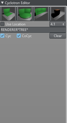

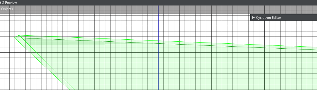

The new Cyc Editor is located in the top-right corner of the preview panel. It can be expanded by clicking the arrow on the left side.
images/download/thumbnails/145917188/cyc1.PNG

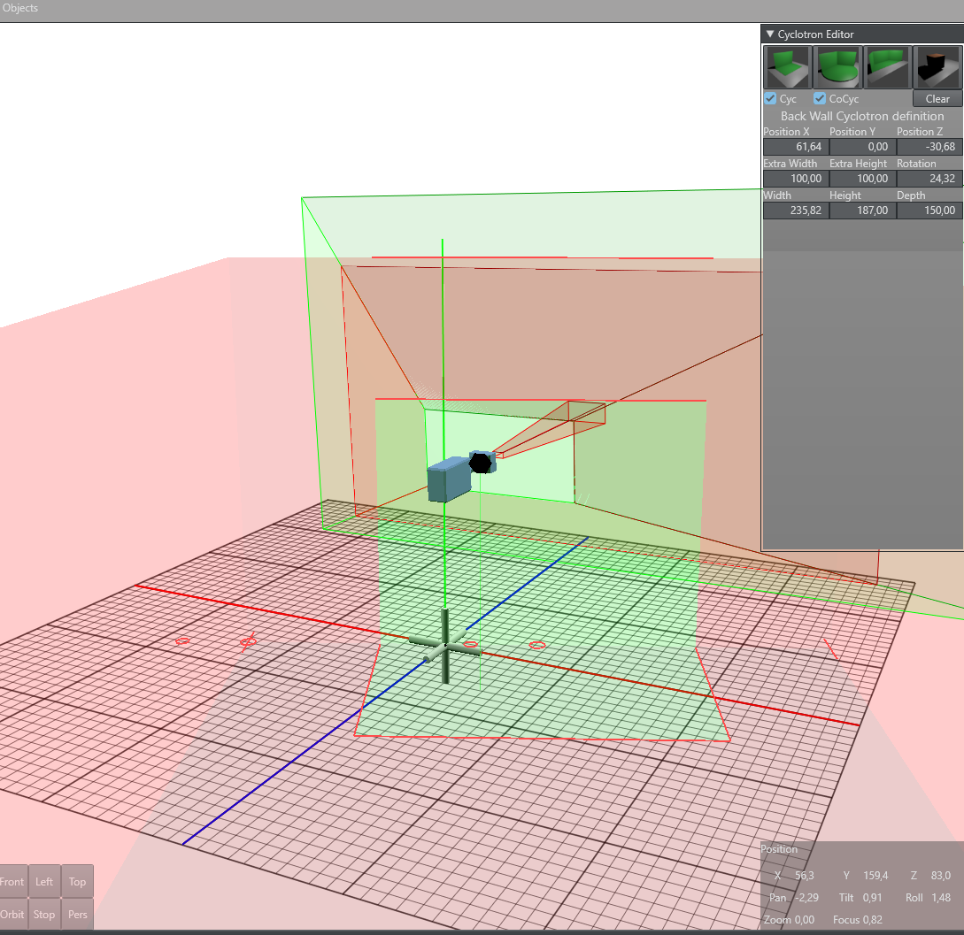

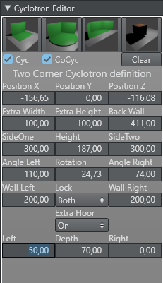

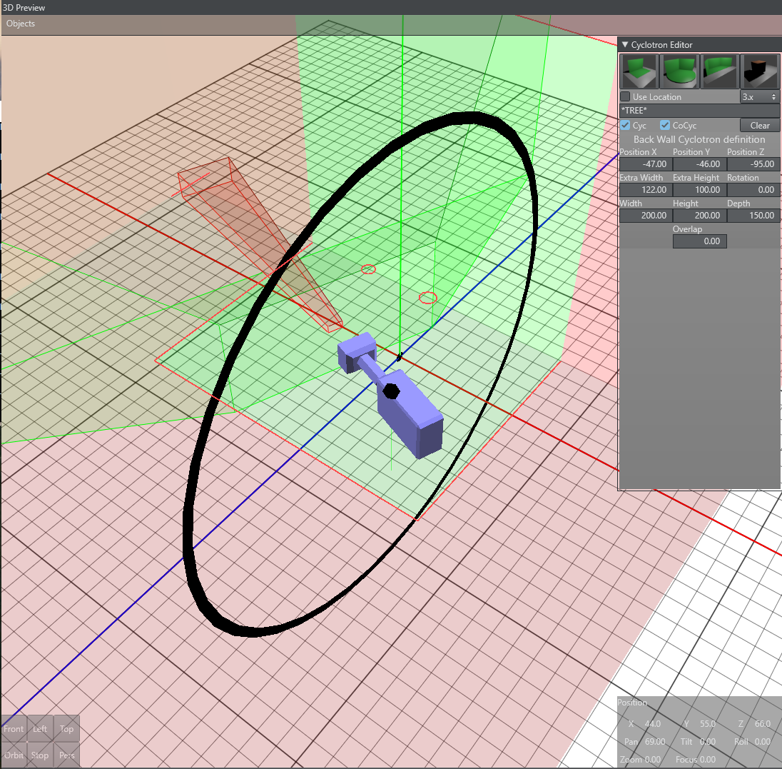

There are three Cyclotron types are available: Back-Wall, One-Corner and Two-Corner Cyc.
Common Cyc-Editor Elements
images/download/thumbnails/145917188/image2018-12-6_12-43-36.png
For every Cyc model, six common parameters can be defined. The position, rotation (Y-Axis), Extra Height and Extra Width. Extra height defines the distance from the top of the Cyc wall to the ceiling of the room. Extra width defines room size around the green wall and floor area.
Back-Wall
images/download/attachments/145917188/image2018-12-6_11-47-16.png
The back-wall Cyc has three additional parameters: These are the width of the green wall, height of the green wall and the depth of the ground area.
images/download/thumbnails/145917188/image2018-12-6_11-48-39.png
One Corner
images/download/attachments/145917188/image2018-12-6_13-6-46.png

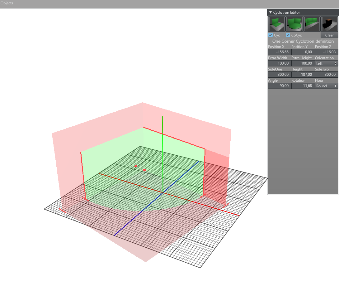

The One Corner Cyc is defined by two sides (side one and side two) and an opening angle. Additionally, the shape of the ground plane can be selected. The user can choose Round, Straight and Rectangular form.
images/download/thumbnails/145917188/image2018-12-6_13-15-2.png
Two Corner
images/download/attachments/145917188/image2018-12-6_13-45-1.png

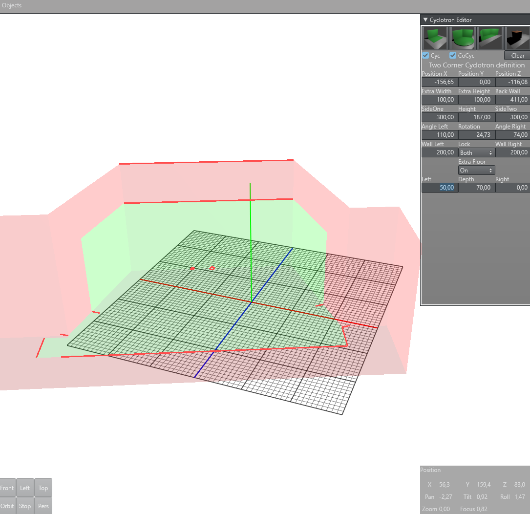

The Two Corner Cyc is defined by the length of SideOne and SideTwo, two opening angles (AngleLeft and AngleRight). It is possible to define the green area of the sides shorter than the side itself. This can be done with the parameters Wall Left and Wall Right. It is also possible to define an extra floor area. This extra floor is added in front of the green walls and extends the shape of the floor.
images/download/attachments/145917188/image2018-12-6_13-48-10.png

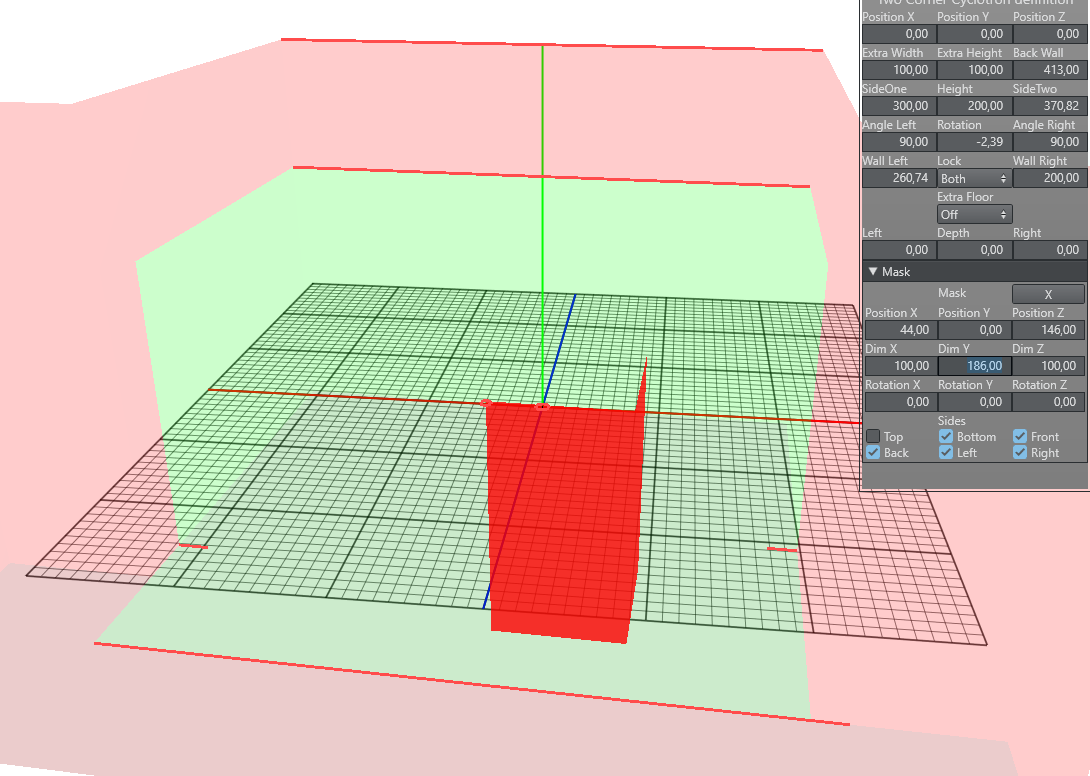

Masks
For any CYC model, any amount of Masks can be added. Masks are elements which will be added to the CoCyc walls. For any mask element the position, scale and rotation can be defined in the Cyc Editor. It is also possible to select for every sides of the cube if it should be rendered or not. In the tracking hub, the amount of masks is not limited.

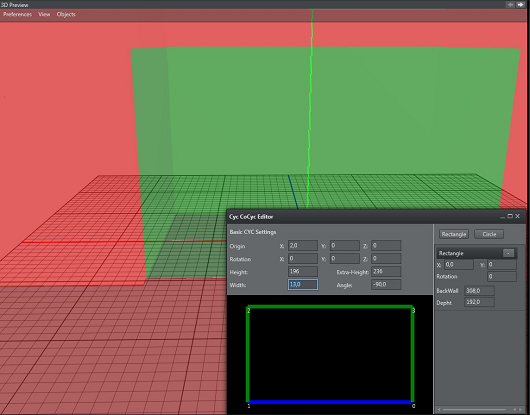

The second option to define a Cyc/CoCyc is described below. Important to know is, that as soon as the user selects the old method, the new definition is deleted and vise versa.

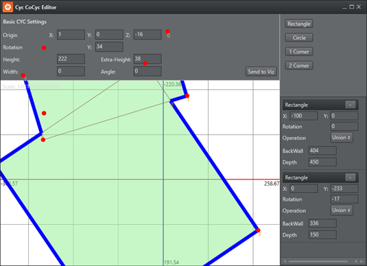

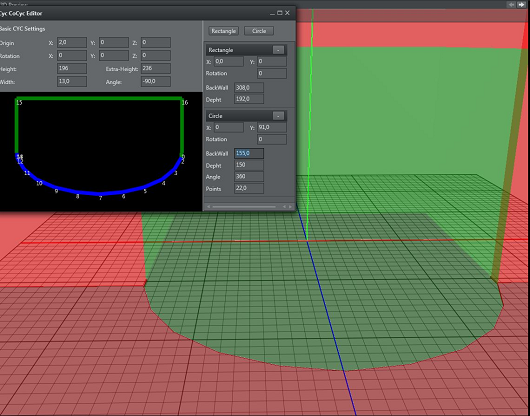

In Tracking Hub and the Studio Manager, a Cyc is defined by basic shapes, such as rectangles and circles, which can be added to a Shape List. All the shapes in the list are united by a Boolean operation which results in a segment list. The segment list is displayed in the segment area. From all these segments, a continuous subgroup can be selected in the editor to define if the segment is part of the green/blue wall or not. Every segment not selected (blue) is part of the floor. Every segment which is selected (green) is part of the Cyc wall. Based on this information, the Studio Manager is able to calculate a mask object which is then sent to Viz Engine.
images/download/attachments/145917188/setup_cyc_cocyk_editor.png
The Cyc Editor consists of the following Areas
  • Origin: Defines the X,Y,Z offset of the generated cyc with respect to the origin of the Viz Engine coordinate system.
  • Rotation: Defines the X,Y,Z rotation offset of the generated cyc with respect to the Viz Engine coordinate system.
  • Height: Defines the height of the green wall.
  • Extra Height: Defines the height of the studio ceiling.
  • Angle: See next section.
  • Width: See next section.
CyC Editor Angle and Width
images/download/attachments/145917188/setup_cyc_angle_and_width_overview.png

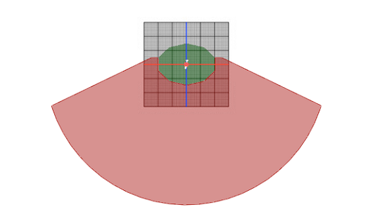

The CYC generation algorithm works as follows:
  1. Find a continuous group of wall segments and mark the start and end segment.
  2. Calculate the normal of the last segment which is not part of the wall group.
  3. Calculate the direction of the first segment, which is a wall.
  4. Extrude the CoCyc for Width cm in the calculated normal direction.
  5. Continue the extrude in direction of the first wall segment plus Angle.
  6. Do the same with the end segment of the continuous group.
  7. Close the CoCyc with a big surrounding circular object.

Shape Area
In the shape area, basic shapes can be added to the shape list. Every list elements shows a dash (-) in the Header line. Clicking on the dash (-) removes the shape from the list. Every shape can have its own origin and rotation about the Y axis. Additionally, every shape has its own parameters.
  • Rectangle
    • Back Wall: Sets the width of the rectangle in centimeters.
    • Depth: Sets the depth of the rectangle in centimeters.
  • Circle
    • Back Wall: Sets the width of the circle in centimeters.
    • Depth: Sets the depth of the circle in centimeters.
    • Angle: Defines the angle of the pie the shape creates, if smaller than 360.
    • Points: Sets the amount of segments the shape consists of.

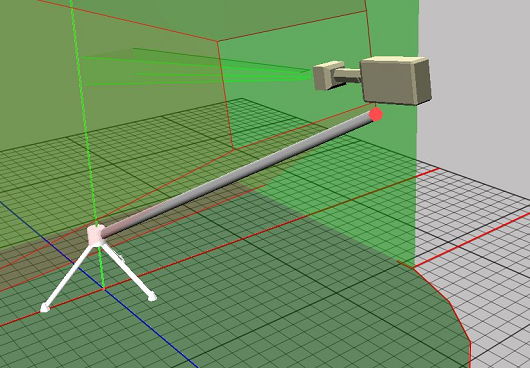

images/download/attachments/145917188/setup_cyc_displaymode_pedestal.png
Crane
The rig is displayed as small jib.
The origin of the base is the X/Z offset of the rig.
The tracked point is a result of offset and height.
images/download/attachments/145917188/setup_cyc_displaymode_crane.png

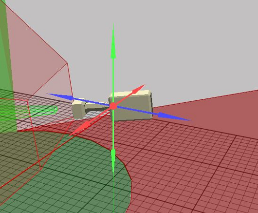

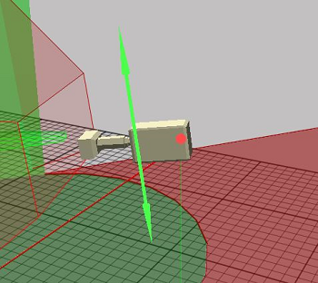

Camera Handles

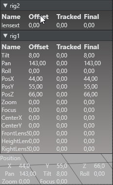

Whenever the user clicks in the rig editor to adjust a specific value, the preview panel displays the values as a handle that can be dragged. Handles can be arrows (position) or disks (rotation). Whenever the user touches a Handle with the mouse, the handle goes from its base color to yellow. This indicates that only this handle is active at the moment. Clicking with the left mouse button and moving the mouse in handle or in the opposite direction modifies the handle's value.
The following list shows all available handles and the corresponding rig values.
Rig Value
Description
Example
Position Offset
Every axis is color coded and only visible if modifiable.
  • Green: Y Axis
  • Red: X Axis
  • Blue: Z Axis
images/download/attachments/145917188/setup_cyc_position_offset.png
