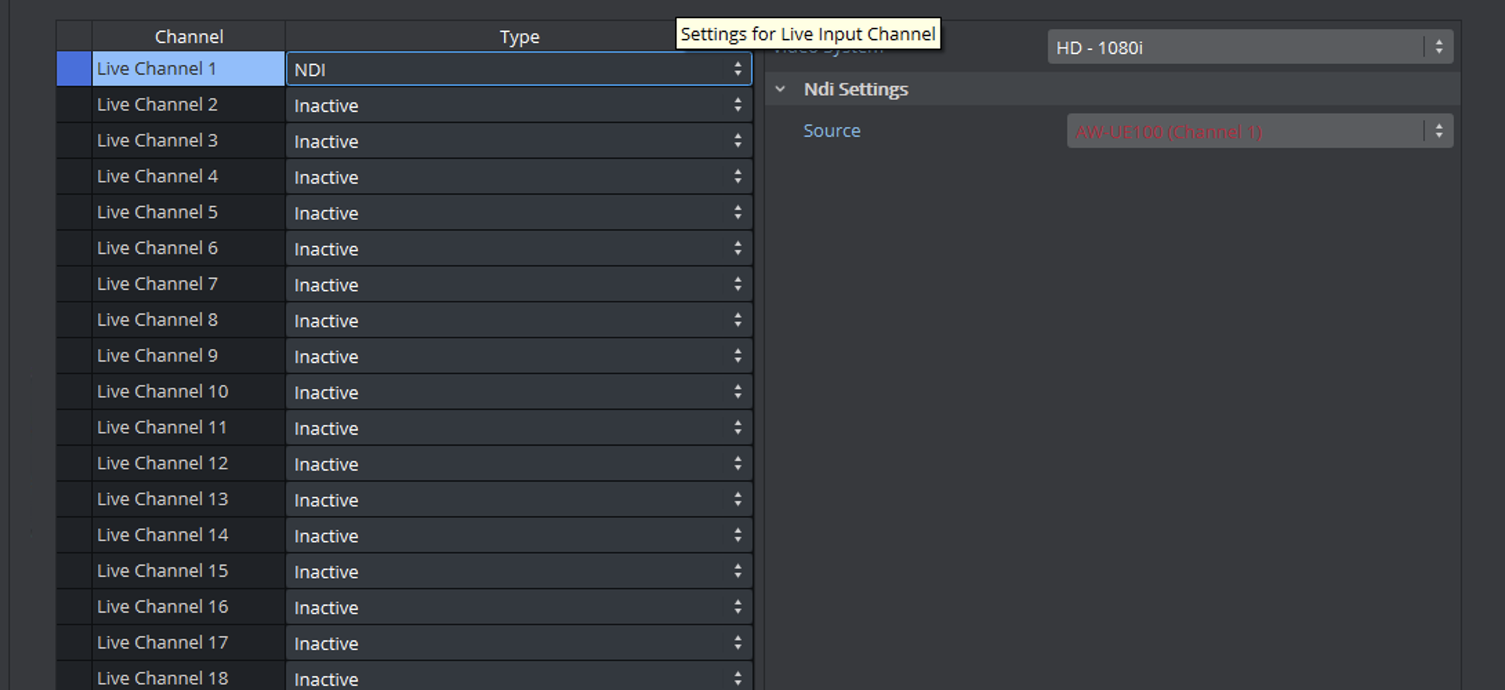

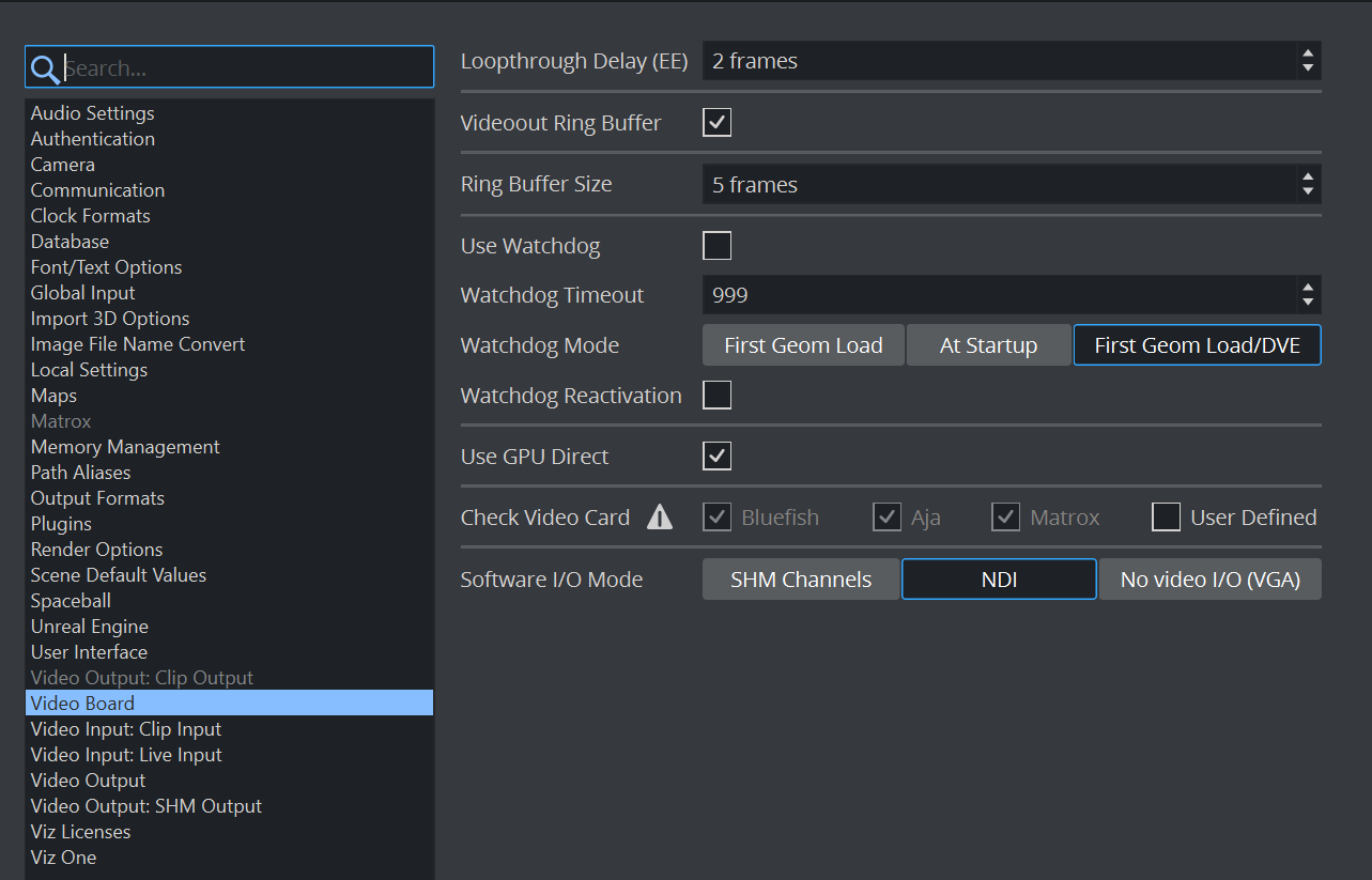

To use NDI in your Virtual Studio, make sure the following conditions are fulfilled:
In the Viz Engine Settings, all video boards must be deactivated and NDI must be selected.
As the Sync source settings are not available after switching to NDI. In the configuration file under the section Genlock, Genlock must be set to
2.
