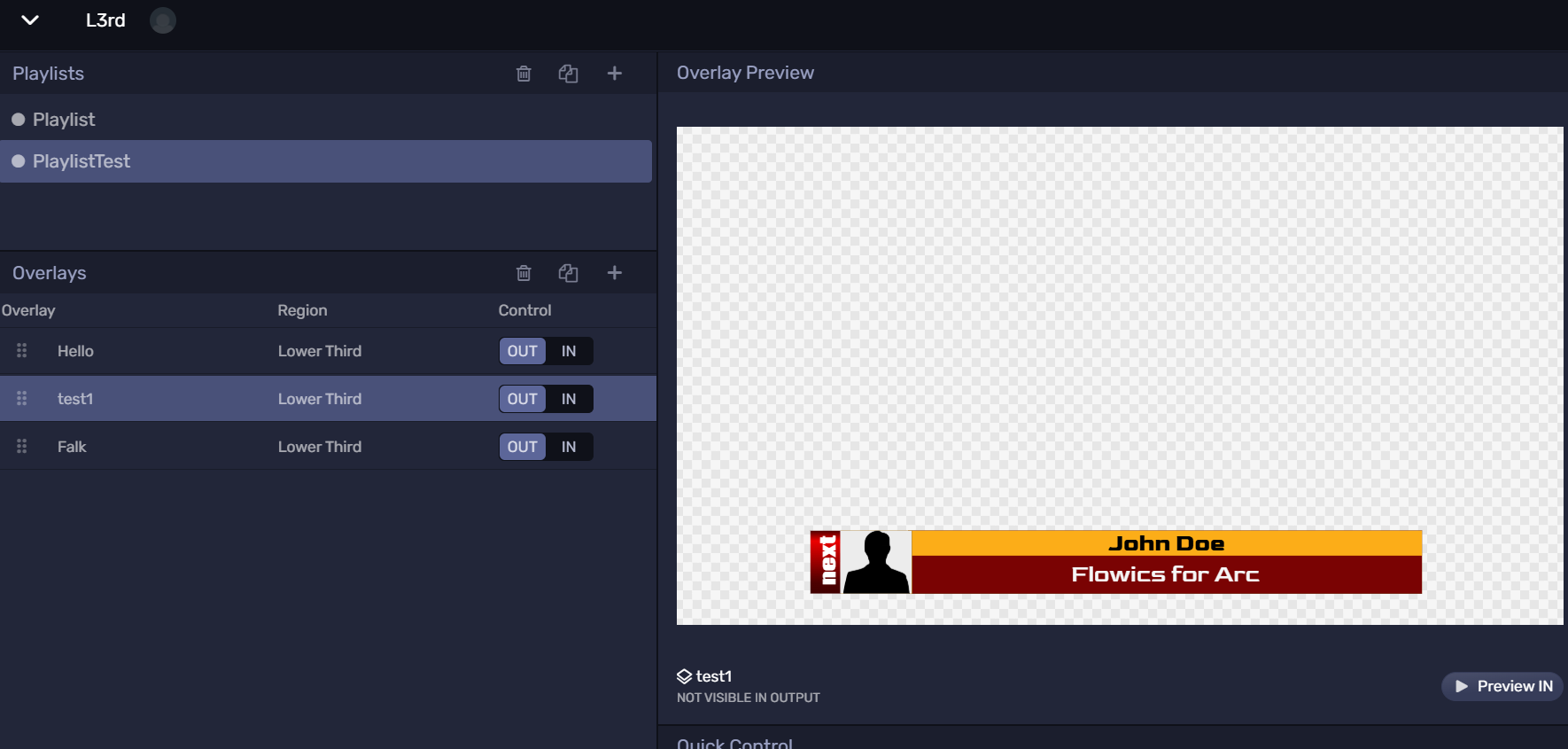

Flowics Playlist

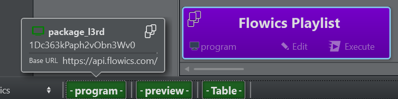

A Flowics Playlist action is used to play out or update a Flowics playlist item. The action can only animate in the playlist element, update it or animate it out. It is not possible to control the content of the playlist items. The graphics package needs to be published as Rundown Control.
Make sure the action uses the correct channel containing the Flowics engine pointing to the respective Package.

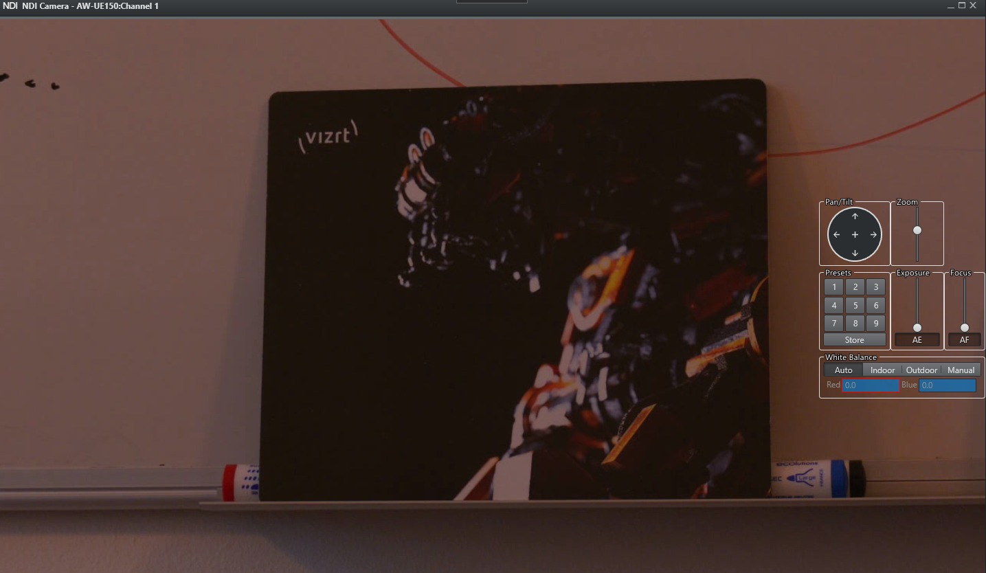

Once a valid source has been selected, the configurable values are unlocked and an UI displaying the connected NDI source is shown. This new interface serves two purposes: to show the NDI source identification and its status; To allow the user to control linked camera and verify / modify its presets.
Clicking on the Cogwheel button next to the connected NDI Source opens up a new Window with the NDI Source output and controls that can be used to interact with the camera.
Move the camera (Pan/Tilt), change zoom, exposure (Manual or Automatic), Focus (Manual or Automatic) and white balance, and set and store presets:
When used in conjunction with monogram's ORBITER module, the camera can be operated through the orbiter.

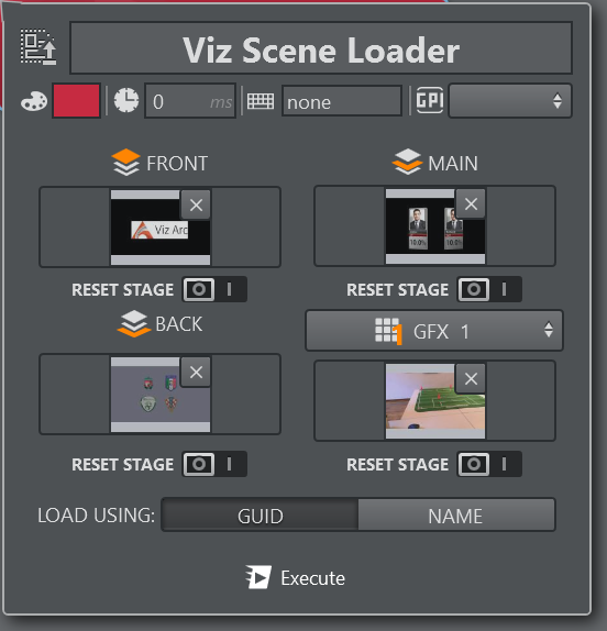

The Scene Loader lets you configure whether to load a scene in the FRONT_LAYER, MAIN_LAYER, BACK_LAYER and in one of the MATTE or GFX channels (from 1 to 16) at the same time. It's also possible to select the RESET STAGE option to load a scene initialized in frame 0.0 on stage. To remove a single scene, press the X icon at the top-right of the selected scene. Select CLEAR LAYER if you want to explicitly clear a specific layer. Select whether to load the scenes using the GUID or the NAME.
When a scene was selected belonging to a Concept and an engine in the selected channel has a different Concept configured, the scene loader loads the corresponding scene belonging to that concept.

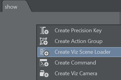

Create Scene Loader by right-clicking on the desired scene in the panel on the left:
This automatically adds the action to your active action area:
As an alternative, an empty scene loader can be created from the context menu on the action canvas:

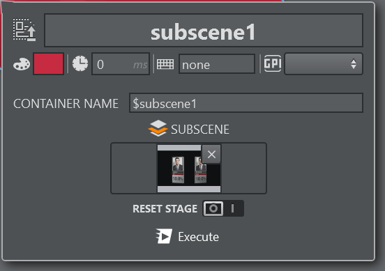

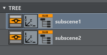

Viz Engine 4 introduces the concept of SUBSCENES where entire scenes can be loaded into a container in the scene tree. When loading a scene containing a SUBSCENE plugin, it is displayed in Viz Arc's the tree view.
Drag and drop the subscene icon onto the action canvas to create s subscene loader action.
The scene loader can be used to load different scenes in the subscene, clear the scene and reset the subscene director's on load. Under CONTAINER NAME the container path of the subscene can be changed manually.

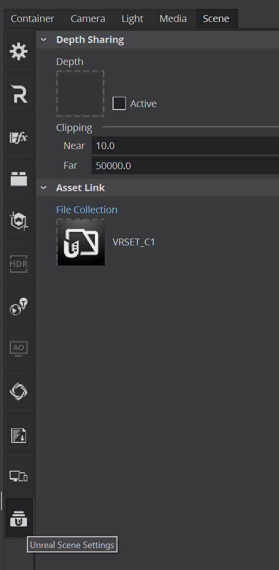

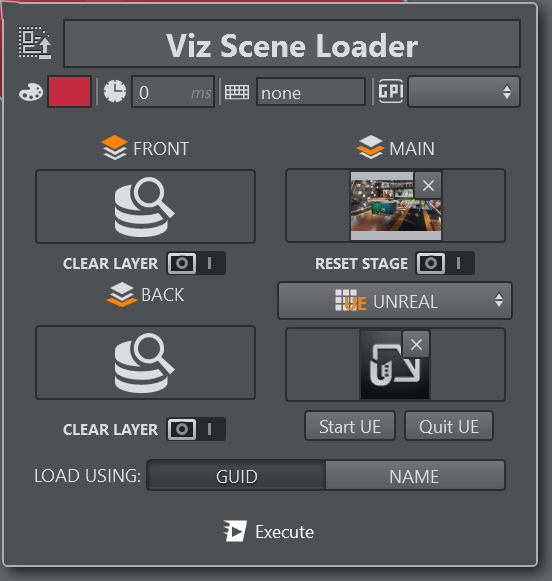

The scene loader can also set the Unreal File Collection associated to a Viz Engine scene

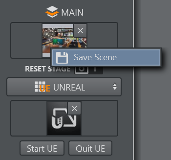

From the drop down menu select the UNREAL item and select a File Collection browsing the Graphic Hub. When changing the File Collection, make sure to close the Unreal Engine using the Quit UE button, start the new File Collection using the Start UE button.
Important: Please note that the Viz Engine will automatically launch the File Collection that has been saved with the scene. Make sure you save the Viz Scene when you want to permanently change the File Collection within a Viz Scene.
In case the respective scene has been loaded in the main layer and it is associated to the scene loader, you can use the context menu to save the scene.

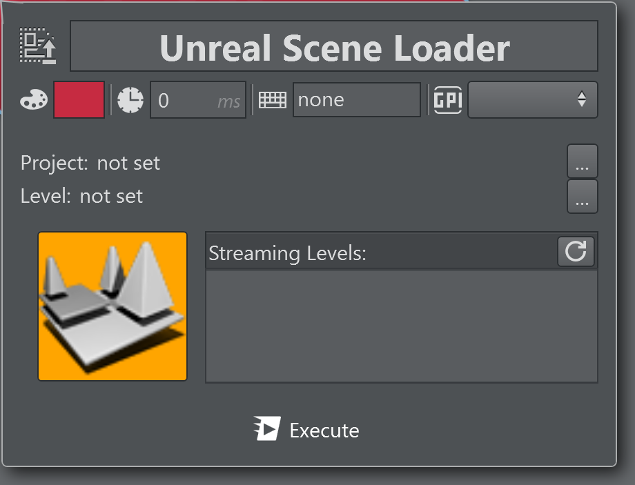

The Unreal Scene Loader allows you to load a specific unreal map in a given project. The loader can be created either by using the context menu on the action canvas or through the context menu on the scene tabs.
The Project indicates the Unreal project while the Level indicates the name of the level to be loaded.

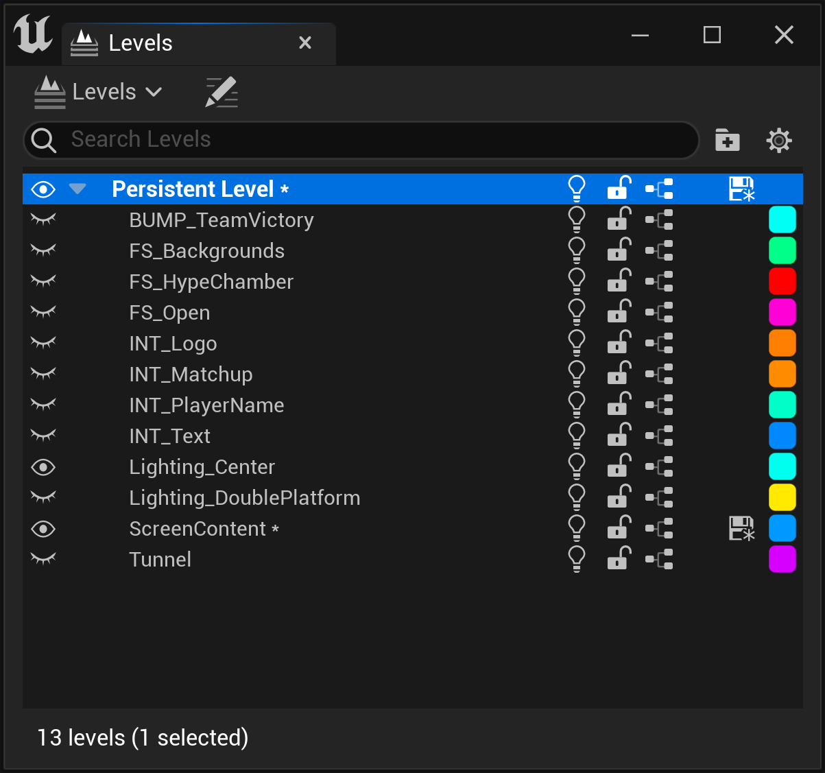

The Streaming Levels show a list of the streaming levels that are shown when the scene loader executes.

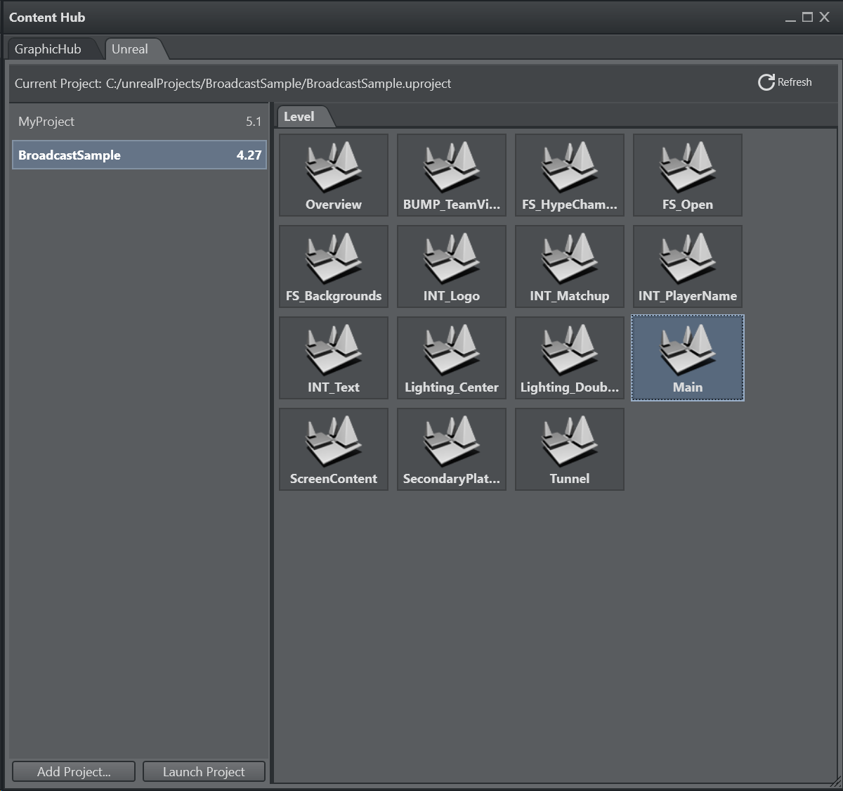

When creating a scene loader from the action canvas, click on Select Unreal Level to open the browser.
Either browse the unreal project and level browser to manually select the .uproj and .umap files or click the map icon use the Unreal browser as shown in the screenshot below. Make sure to select the project location before selecting the map level as the map is a location relative to the project.
Note: Manual selection of the project and map files implies that the project are stored on a file system that is reachable by the local machine.
The built in browser allows you to browse the content of of the Unreal editing engine which may run on a different machine.
Use the Add Project... button to add a project browsing on the local filesystem. The selected project is added to the list of available projects.
Selecting a new project loads it into the Unreal Engine and displays the available levels. This process may take some time depending on the complexity of the project.

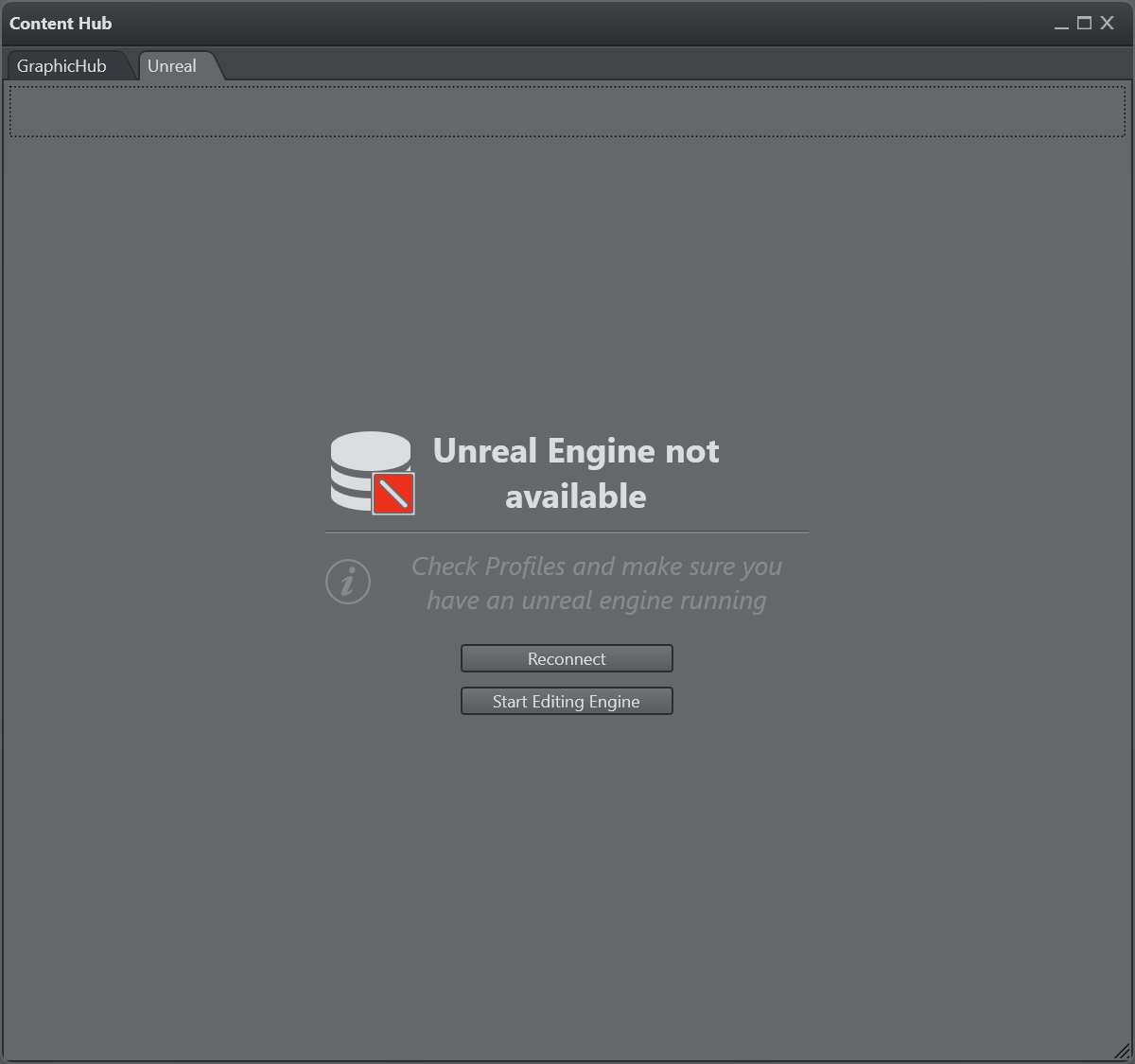

In case the editing Unreal Engine is not running when the browser is opened, you can launch it by clicking the Start Editing Engine, this launches the editing engine through the Viz Unreal Launcher. Once the engine is up and running it automatically displays the available projects and levels.
Info: The browser only works when the Unreal Editing Engine is in game mode.
Using the Browser to Select a Project
By double clicking a project, the Unreal Engine is restarted with the respective project. The browser only shows the levels of the currently loaded project.
  • Click Refresh to refresh the layers when the Unreal Engine has been restarted with a different project.
  • Double click on one of the layers to confirm the selection.
Note: The unreal scene loader requires the Unreal Loader Service to be properly installed and configured. Whenever a level is loaded that is not part of the current project, the Unreal Engine is restarted.

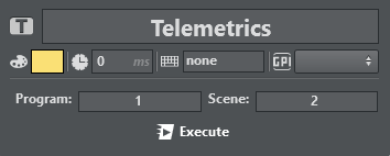

Telemetrics lets you control a robotic camera using the Telemetrics protocol.
Program and Scene determine the desired shot position of the robotic camera.

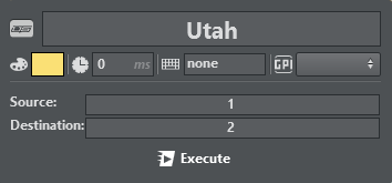

Utah is used to route SDI video signals through a Utah Scientific router.
Source and Destination determine which source ID is to be mapped to which destination ID.

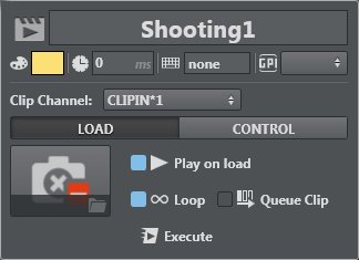

Viz Clip
Viz Clip is used for managing Viz Engine’s ClipIn channel; it has two working modes:
In the LOAD menu, you can select which clip to play (Local file system or Media service) and play options (Play on load, Loop and Queue Clip).
Queue Clip lets you set the selected clip to the pending position. It then plays as soon as the currently playing clip finishes.
Use the CONTROL menu to START, STOP, CONTINUE and PAUSE the clip.
If a Viz One server has been configured, the Clip Action can also browse for clips on Viz One.
The Viz Engines inside the selected channel need to be configured as Engine endpoints in Viz One in order to transfer the clips on the Engines. A progress bar on top of the action indicates the transfer progress.

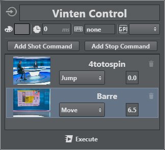

Vinten Control
Vinten has it’s own software and service for controlling cameras. You can use the joystick to move cameras and save the shot. It's useful for broadcasters to have the same opening camera animation easily available on a TV program.
Shots are the saved camera movements in Vinten Automation Services software.
Once you have created and saved a shot in Vinten, it's possible to import it into Viz Arc using the Vinten Control menu. There are three timer controls:
  • JUMP TO: The quickest way to switch from the selected shot to the next shot.
  • MOVE TO: Configures a time in which it does the shot animation; if the time is too early, it does the animation in the minimum time requested.
  • STOP: Stops the selected shot.
To Import a Vinten Shot
A step-by-step procedure for importing a Vinten Shot into your Viz Arc project follows below:

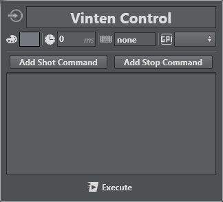

Select Create Vinten Control Action from the context menu to make the panel on the left appear. The shot list is empty.

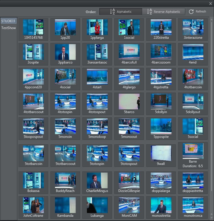

To add a Vinten shot, press the Add Shot Command button . A window containing all of the shots saved in the Vinten software (Vinten Automation Services) is displayed.
It's possible to reorder shots alphabetically or reverse and refresh by pressing the respective buttons at the top right of the window.
Select your desired shot, and it is automatically added to the action box.
You can now assign a time mode between JUMP or MOVE.
It's possible to import multiple shots into the same action box and create a list or keep every shot in a single box.
It's also possible to add a stop command by pressing the Add Stop Command button.
To remove any shot or stop, press the Trash can icon  next to the desired element.
