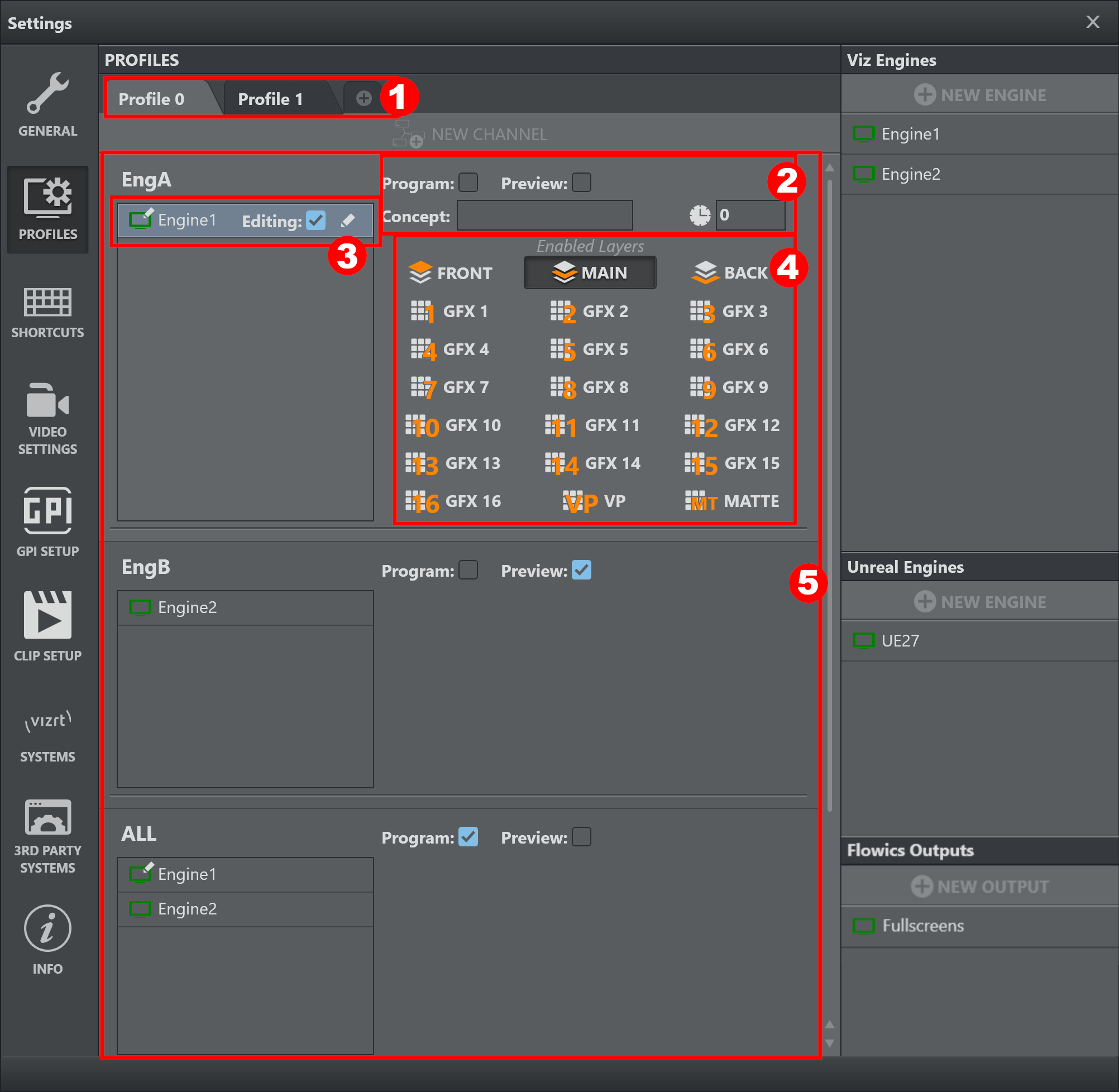

Profiles: Used to configure the different groups of Viz or Unreal Engines available for control by the user; these groups are called Channels.
Engine and Channel Settings: Used to configure Program/Preview, the concept and an execution delay each Engine.
Engines list: Viz Arc is capable of controlling more than one Viz Engine at the same time. For example, when working with multiple tracked cameras. This menu contains all the Engines assigned to a given channel.
Enabled Layers: Layers enabled in the Scene Tools when selecting a channel and selecting into which layer a scene is loaded.
Channels: A channel is a group of Viz Engines (or Unreal Engines) that receive the same commands at the same time. For example, when executing actions or loading a scene.

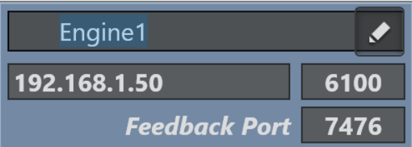

Add a Viz Engine
Press the NEW ENGINE icon on the right of the window or the add iconat the top of the Viz Engines list.
Enter the display name, host/IP and port in the box that appears.
The Feedback Port is the
command_feedback_portas configured on the VizEngine (default7476).Press ENTER.

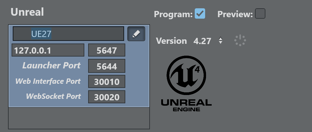

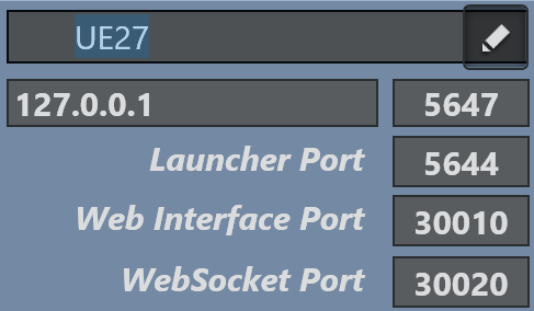

To Add an Unreal Engine
Press the NEW ENGINE icon on the right of the window or the add iconat the top of the Unreal Engines list.
Enter the display name, host/IP and Viz Arc Unreal Engine plug-in port and the Launcher Port in the boxes that appear.
Press ENTER.

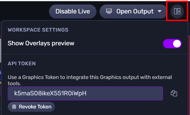

To Add a Flowics Output
Press the NEW OUTPUT icon.
Enter the display name of the new output and enter its API token. The API token can be found on Flowics output control page, under the settings panel:

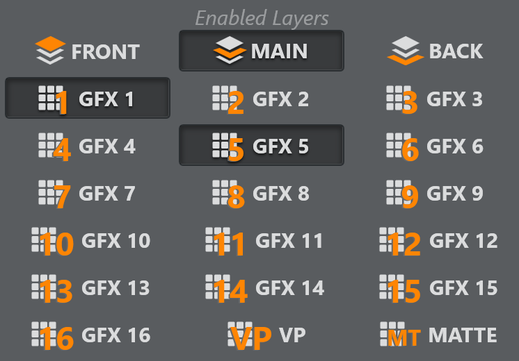

To Enable Available Viz Layers
Select one or more layers by pressing them in the Channel menu.
Note: Layers let you send scenes and commands to different output levels within Viz Engine. The main layers are FRONT LAYER , MAIN LAYER and BACK LAYER. graphics are usually sent to the MAIN LAYER. If you want to view a graphic On Air you need to have at least one layer enabled.

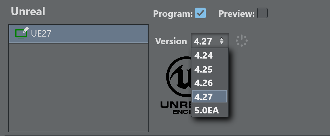

To Select Unreal Engine Version
If the channel consists of one or more Unreal Engines, the Channel menu looks like this:
For each Engine, select the Unreal Version to be used by selecting it from the drop down menu. The adjacent start/restart button starts the respective Unreal version.
Note: The Launcher Port must be configured properly and the Viz Arc Unreal Loader service must run on the target machine. See Unreal Loader for more on setting up and configuring Loader service.
Host/Port: The hostname or IP address running the Unreal Engine and the port on which the Viz Arc Unreal plug-in is configured to listen to.
Launcher Port: The port used by the Viz Unreal Loader service.
Web Interface Port: The port where UE exposes the Remote Control API (UE Version >= 4.26 only).
WebSocket Port: The web socket port where UE exposes the Remote Control Web Interface (UE Version >= 4.26 only).
WebSocket Port and Web Interface Port are only relevant when the UE Preset actions are used.

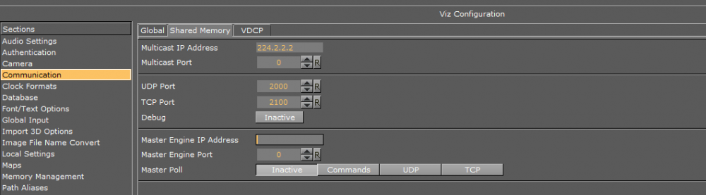

Click on the small triangle at the right of each Engine to see more details about the current Engine configuration. The first two entries show the shared memory communication port settings, which can be used with scripting or SHM. To configure the Shared Memory ports on Viz Engine, go to Viz Engine configuration under Communication > Shared Memory where you can configure UDP and TCP ports for Shared Memory updates.
