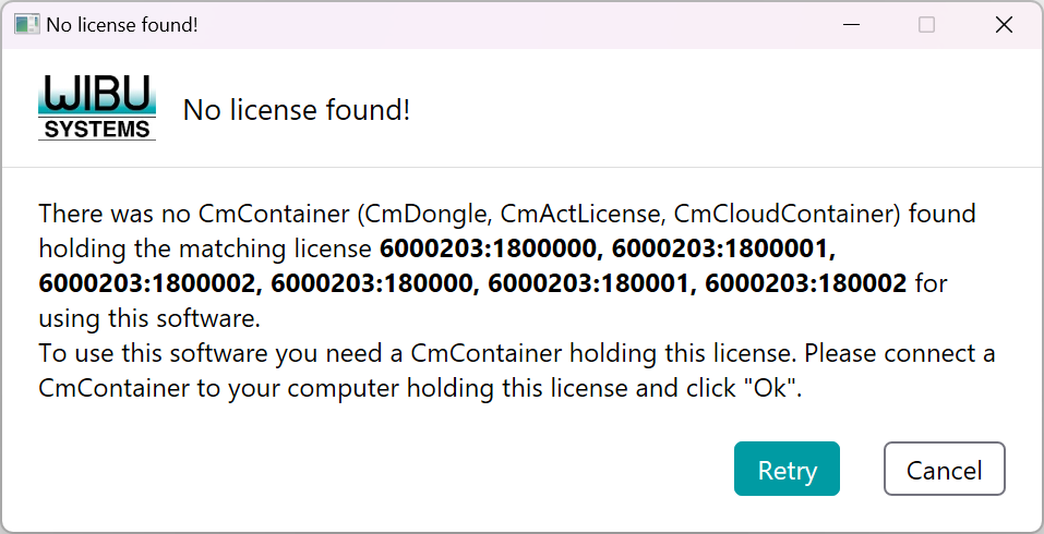

Once you've installed Viz Arc, you're ready to start using it! If you don’t have a license yet and the system cannot find any compatible license, the following (or similar) message appears:

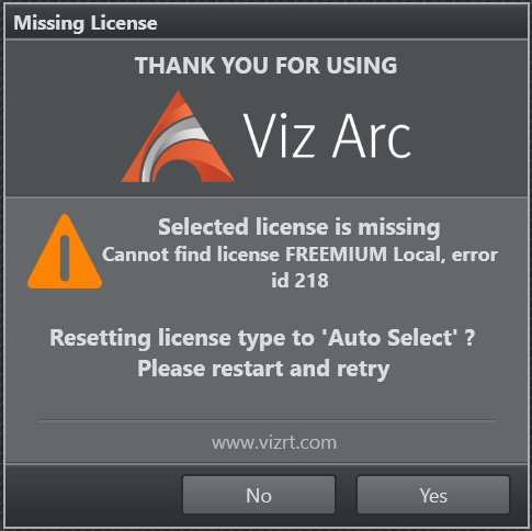

In case a specific license has been selected but it could not be found, the following dialog appears.
Select Yes to reset the license type to Auto, then start Viz Arc again. When the application starts you can try again to select a specific license.
Select No if you don't want to change the configuration. See the Licensing section for more information.
