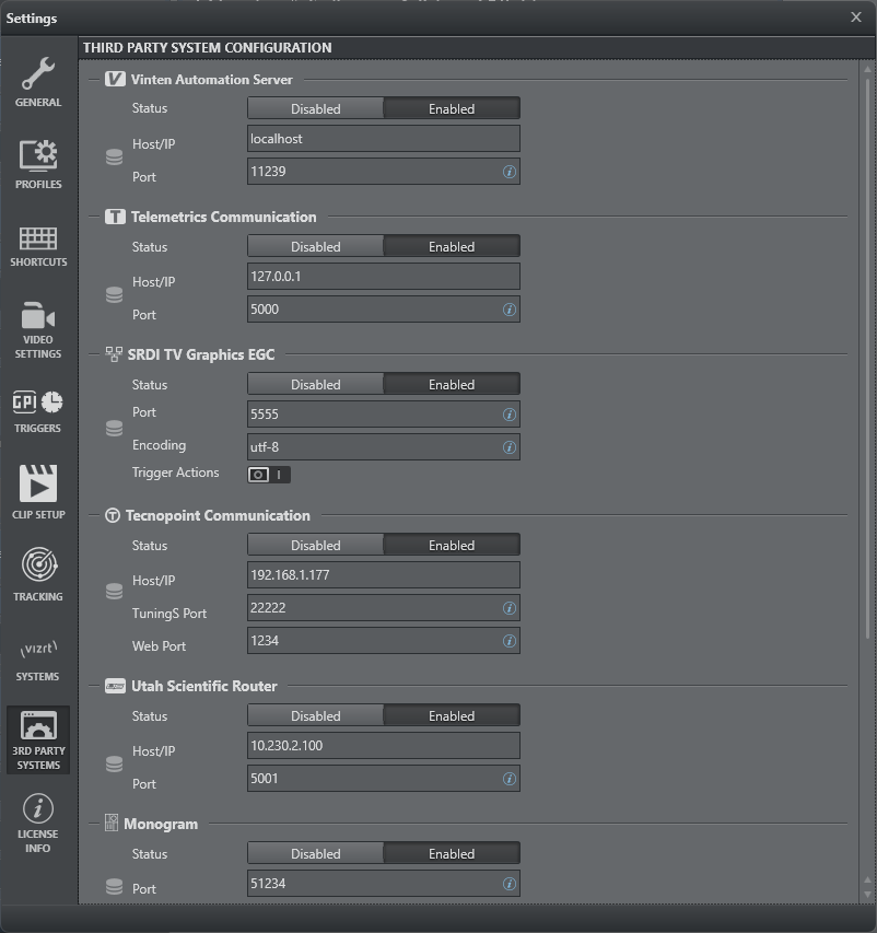

Vinten Automation Server
Viz Arc can be connected to a Vinten Automation Server. Vinten is a supplier of manual and robotic camera support systems.
  • Status: Enables or disables the server.
  • Host/IP: Host or IP of where the Vinten server is installed.
  • Port: The default port is 11239.

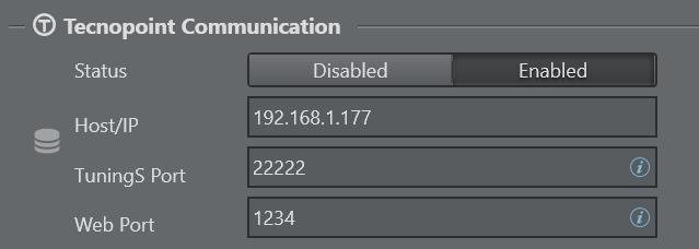

Tecnopoint Automation Server
Viz Arc can be connected to a Tecnopoint Automation Server.
  • Host/IP: Host or IP of where the Tecopoint TuningS server is installed.
  • TuningS Port: The default port is 22222.
  • Web Port: The HTTP port used to fetch thumbnail images, the default is 1234.
SRDI TV Graphics Integration (EGC)
The SRDI integration where Viz Arc acts as a server.
  • Status – enables or disables the listener. When enabled, it starts automatically with Viz Arc; changes take effect as soon as the settings are applied – no restart needed.
  • Port – the TCP port Viz Arc listens on (default 5555). Configure the same port as the CG connection target in SRDI. Viz Arc listens on all network interfaces.
  • Encoding – text encoding of the incoming data (default utf-8). Switch to iso-8859-1 if accented characters look garbled.
  • Trigger Actions – optional: when enabled, each incoming command also executes the Viz Arc action named after the SRDI page (see Triggering Actions below). Off by default – the data is stored in the Data Map either way.
Telemetrics Automation Server
Viz Arc can be connected to a Telemetrics Automation Server.
  • Host/IP: Host or IP of where the Telemetrics server is installed.
  • Port: The default port is 5000.
Utah Scientific Router
Viz Arc can connect to a Utah Scientific Video Router.
  • Status: Enables or disables the router.
  • Host/IP: Host or IP of where the Utah router is installed.
  • Port: The default port is 5001.
Monogram
Viz Arc supports monogram consoles.
  • Status: Enables or disables the console.
  • Port: Sets the UDP port to listen for device input.

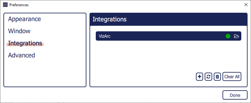

To configure monogram to work with Viz Arc, go to Monogram Creator > Preferences and add the Viz Arc integration.

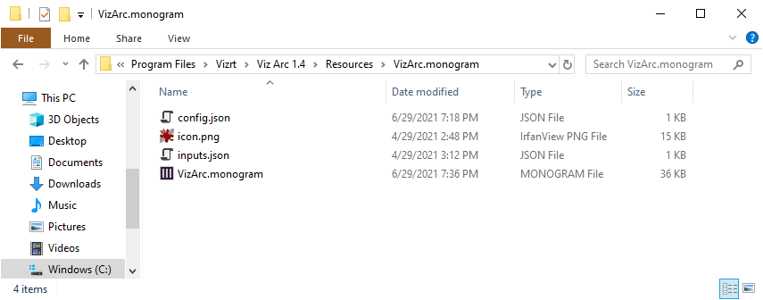

A predefined integration can be found in the Viz Arc program-data folder under Resources/VizArc.monogram.
In the config.json fille, the port can be changed to something else than the 51234 default port.

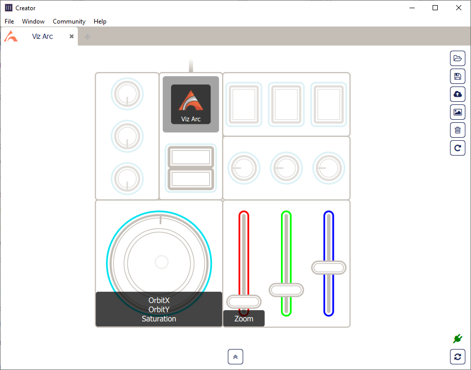

When used with an ORBITER module, the integration can be used to control an NDI PTZ camera using the NDI Action.
A sample of connected monogram modules including an ORBITER module.

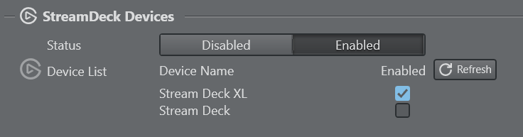

Stream Deck
The Stream Deck Devices section lists all Stream Deck devices connected to the system.
  • Status: Enables or disables Stream Deck device usage.
  • Device List: Lists of all currently connected devices. Use the Refresh button to refresh the list in case a device has been connected or disconnected after starting Viz Arc. Uncheck any device you do not want to use in Viz Arc.

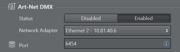

Art-Net DMX
The Art-Net section is used to configure the listening port and interface for Art-Net DMX lighting data.
  • Status: Enables or disables Art-Net listening.
  • Network Adapter: The network interface to listen on for Art-Net messages.
  • Port: The port to use to listen to the messages, the default port is 6454.
