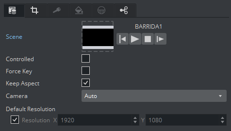

GFX Properties
By default, a GFX Channel automatically inherits the camera settings of the Scene it is applied to. In addition to the common Media Asset properties, GFX Channels also have the following properties:
Scene: Drag a scene, which should be rendered in the GFX channel.
Play Controls: Controls the animation of the set scene.
Controlled: Controls the GFX Channel animation using the main or parent Scene animation controls if active. For example, if the animation in the main Scene starts, it triggers the start of the GFX Channel Scene.
Force Key: Renders the entire Scene as keyed if the Scene does not have any keying information. If a GFX channel is rendered as Texture, it is in RGBA. Therefore, the Scene needs to have keying information for an alpha channel (the key scene setting is set to auto key or a key plug-in is used in the Scene Tree).
Keep Aspect: Renders the GFX Scene with its own aspect ratio (undistorted) if set to
Onin DVE mode. The Scene is scaled to fit the GFX channel size if set toOff.Camera: Selects the camera view of the GFX Channel Scene. Auto means that the current camera setting of the loaded scene is used (may also change due to animations within the loaded scene).
MAIN_SCENE: Inherits the camera from the main scene.
AUTO: Uses the camera from the local scene and supports animations in the local (nested) scene.
1-16: Overrides camera view (fixed).
Resolution: Defaults the GFX Channels to the resolution configured for the current Output Format in the Viz Engine configuration. To change the current resolution, click the Default Resolution button to make the Resolution X and Y fields available for input, and enter the desired resolution setting. Clicking the Default resolution again resets the resolution for the GFX Channel, as well as disable the Resolution X and Y input fields. If the Default Resolution button is in a pressed state, and the Resolution X and Y fields are dimmed, the default resolution is in use.

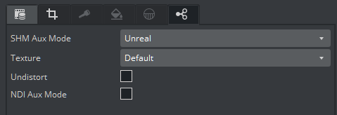

Shared Memory Output for GFX Channels
Shared Memory (SHM) output is now supported from one or multiple GFX channels with configurable output resolutions (different than overall output format), Alpha, and 16-bit textures.
It is possible to send the output of the GFX channels to Shared Memory to exchange data with third party applications using Viz Artist.
SHM Aux Mode: Which mode to be used to exchange data with third party applications.
Send: General mode for any third party application.
Unreal: Defines the behavior when used with Unreal Engine. The texture (either the default resolution or the original size) can be distorted or undistorted.
You can get the related output using Aux Key. The default value for aux key is: viz_<instance_id>_gfx<channel_id>_aux (for example, viz_01_gfx1_aux).
Note: DVE mode is not supported.

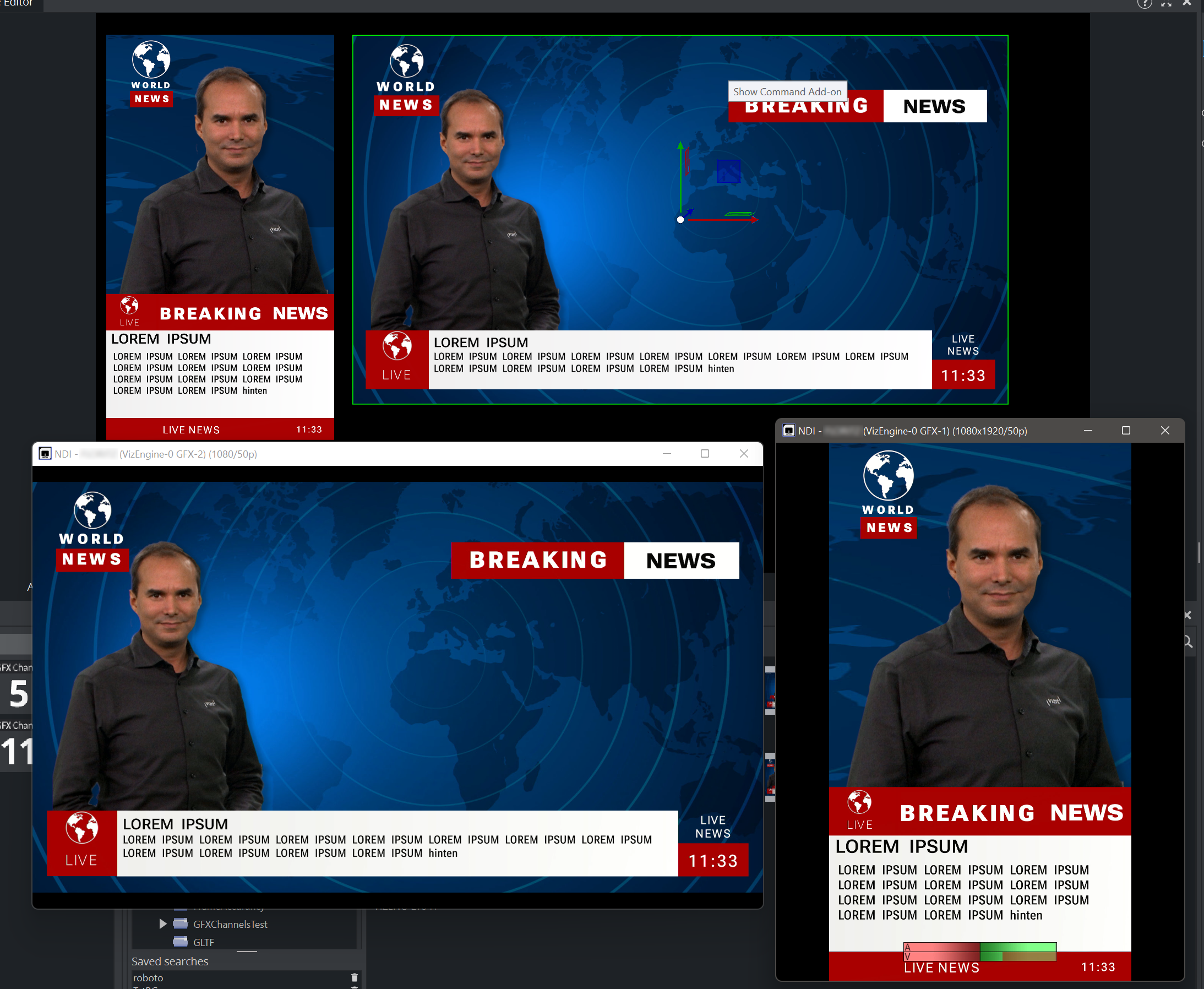

NDI Output for GFX Channels
To support multiple outputs, the content of any GFX channel can also be broadcasted into an NDI network. The name of the NDI stream is then <engine-instancename> GFX-n (for example, VizEngine-0 GFX-1).
For more details see NDI Output from GFX Channel in the Viz Engine Administrator Guide.

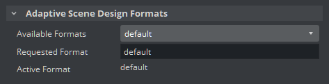

Adaptive Scene Design Formats Support for GFX Channels

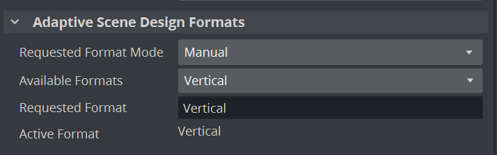

GFX channels can be set to render a certain format using the command or Viz Artist:
There are several options available for Requested Format Mode:
Manual: Renders a given format. Can be set using Available Formats.
Inherit from Main Scene: Uses the format of the GFX Channel Master scene.
Use Aspect Ratio: Selects the format automatically based on the width/height, and therefore, the aspect ratio of the scene. The first matching format is applied. Only works for DVE.
#<sceneID>*GFX*1*REQUESTED_FORMAT SET <name of format>#<sceneID>*GFX*1*REQUESTED_FORMAT_MODE SET <mode> // options are MANUAL, INHERIT_FROM_MAIN_SCENE or USE_ASPECT_RATIOYou can have one scene with two GFX Channels, one rendering in 16:9 and one in 9:16 portrait mode, and two NDI outputs, one in portrait mode and one in 16:9 mode.
Note: If the requested format is not supported by the GFX channel scene, then it falls back to the default format as active format, and the active format and requested format differ.
