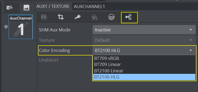

AUX Channels
AUX channels (used to exchange data with 3rd party renderers as Epics Unreal Engine), need to have the correct color space set in the in the Aux tab.

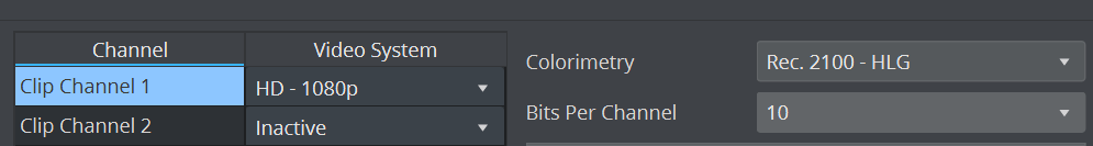

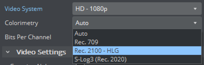

Matrox Clip Player
To use the Matrox clip player for HDR clip playback, the colorimetry needs to be set explicitly in the Viz Configuration:
Note: If you are using DVE inputs, the colorimetry needs to match the output colorimetry.

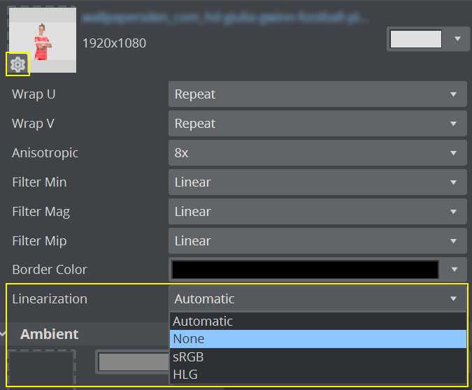

Images (or Textures) within any scene, are automatically linearized into the scene's color space, if they are located on Graphics Hub. This happens automatically while loading a scene, if the option Automatic Image Conversation in Viz Config, is enabled: .
As images require embedding metadata to interpret content correctly, images from other sources (a local file storage) might require a manual setting of the linearization method.
The linearization method can be set to sRGB or HLG within the texture options of several plugins (PBR, Phong, Texture Slot, etc.).

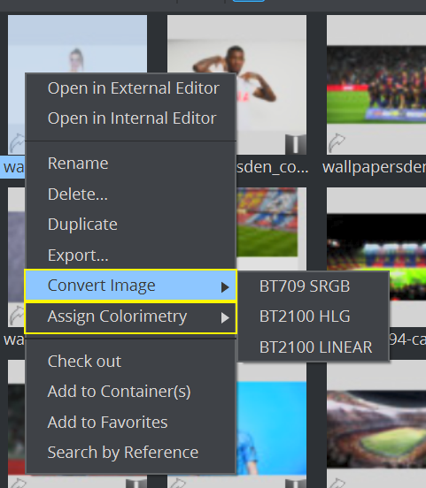

You can also reassign the colorimetry on existing images, or convert images from one color space to another. In Asset view, right click on an image to either re-assign, or convert to a different color space.

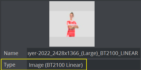

Images with correct metadata for HDR are labelled in Asset view, and more details are shown in the properties panel:
Info: To provide a fallback to SDR versions, you need to tone-map HDR images (to avoid clipping or washed-out colors).
