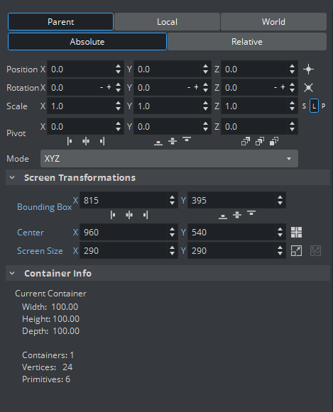

Transformation Editor Properties
Parent / Local / World: See Transformation Principles.
Absolute / Relative: See Transformation Principles.
Position: Sets the position of the object along the X, Y, and Z axis.
Center Camera: Clicking this button centers the Container to the camera.

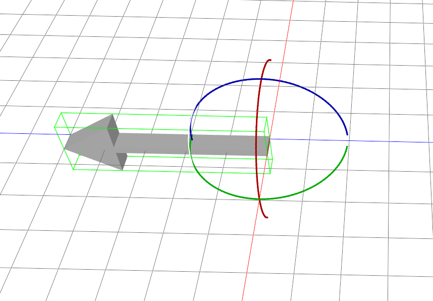

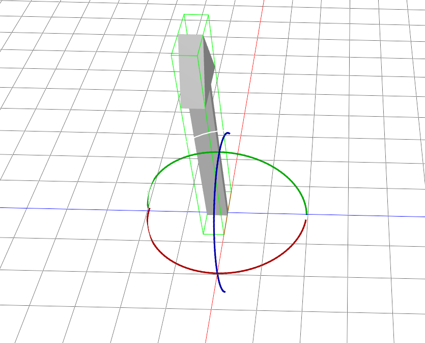

Rotation: Rotates the object according to the X, Y, and Z axes. With the bounding box option enabled, the rotation axes are visible as three lines; X is red, Y is green, and Z is blue. To rotate in steps of 45 degrees, use the buttons labeled 45 and +45.
Face Camera: Changes the rotation in such a way that the object faces the camera.
Rotation Order: Sets the order of rotation the three angles X, Y, and Z, are applied to the Container. If multiple Containers are selected, the order buttons are disabled.
When rotating around each of the three axes, the order in which the rotations are executed matters. Performing a rotation around the axes in the order x, then y, then z will produce different results than performing the same rotations in any of the other five possible orders.
Given a cone with rotation X=90°, Y=90°, Z=90°
Rotation Order XYZ | Rotation Order ZXY |
The object is rotated in 90° in X, then 90° in Y and 90° in Z direction | The object is rotated in 90° in Z, then 90° in X and 90° in Y direction |
Note the colors of the handles in the sceneeditor: | |
Scale: Before changing the scale values of the Container, make sure to set the preferred kind of scaling:
(S) Single: Scales each axis by itself.
(L) Locked: Scales all axes at once, so that X, Y, and Z have the same value.
(P) Proportional: Scales all axes at once, so that the values remain proportional.
Pivot: Sets the origin of the object. The rotation axis of the object is visible in the Scene Editor if the Bounding Box option is enabled.
The origin can be set to left, center, or right on the object’s X axis by clicking on the related icons.
The origin can be set to bottom, center, or top on the object’s Y axis by clicking on the related icons.
The origin can be set to back, center, or front on the object’s Z axis by clicking on the related icons.
When a group is selected but certain Containers in it are not visible, clicking Pivot with the middle mouse button defines the axis center only for those Containers in the group which are visible.
Transformation Settings
Sets the screen position along the X and Y axis for images and some objects by specifying pixels instead of the regular positioning which do not use pixels as input values. The Screen Position option is only available if the image or object faces the camera. To achieve this, click the Face Camera button. When changing the Screen Position values, the values for the regular positioning also changes. Set the screen position to left, center, or right by clicking on the related icons.
In Viz Artist, position calculations are always from the upper left corner and based on the current Z value for the Container and camera views. For design purposes, it may sometimes be desirable to position an objects center. Therefore, screen positioning of objects can be defined by either:
Bounding Box: Defines the position of the object upper left corner, or
Pivot: Defines the position of the object center
Both are calculated from the upper left corner of the current view.
Example: Setting an object's screen position Bounding Box values to X=0 and Y=0 places the object in the upper left corner. Note however, that if the Z position changes the object no longer aligns to the viewpoint corner. The pixel values must be set to zero again to reposition the image or object.
Align to Pixel: When using the normal positioning editor to position an image/object that is facing the camera head on, it can occur that the image/object is off by fractions of a pixel. This can happen because of rounding errors in the screen size and face camera functions. This can produce visual artifacts in some cases on some graphics cards. When the image/object is not aligned to the screen pixels, the Align to Pixel button turns red. Clicking the button adjusts the image/object to be moved to the nearest matching whole pixel.
Screen Size: Makes it possible to scale an object/image based on pixels. The Screen Size option is only available if the object/image faces the camera. To achieve this, click the Face Camera button.
Scale to Screen: Scales the object/image to the size of the output format.
Scale to Image: Scales the image to the original pixel value.
Container Information
This information includes parent Containers plus all visible child Containers.
Width, Height, and Depth: Shows the real size of the object in units (not pixels).
Containers: Shows the number of Containers that are selected. If the selected Container holds Sub-Containers, all Sub-Containers are counted in addition to the main Container. A Container that holds geometry is counted as two.
Vertices: Shows the number of vertices that are rendered within the selected Container, including the vertices in all Sub-Containers.
Primitives: Shows the number of primitives in the Container including the primitives in all Sub-Containers.

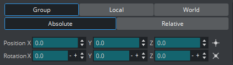

Containers can be manipulated in several contexts:
Parent/Group: Refers to changes that can be made to the Container or Containers in its Parent or Group coordinate system.
Note: Multi selected objects: When more than one object is selected Group shows and a bounding box covers all selected objects.
Local: Refers to changes that can be made to the Container in its local coordinate system.
World: Refers to changes that can be made to Containers in their world coordinate system.
Absolute: Refers to changes that can be made to Containers in absolute values.
Relative: Refers to changes that can be made to Containers relative to current values.

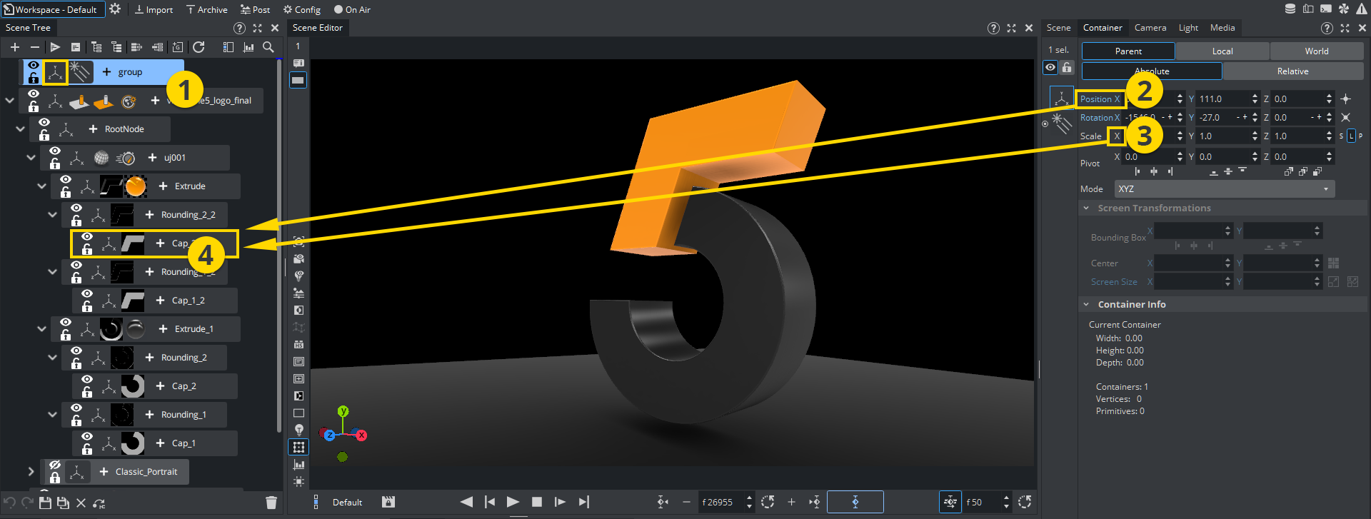

Copy Transformation Properties to Another Container
If a Container has certain settings, for example position or rotation, and another Container in the Scene should have identical settings, it is possible to drag transformation properties from one Container to the other.
All transformation properties can be copied to another Container, either the whole property (for example, Screen Size), or just one axis of a property (for example, X of Screen Position).
To Copy Transformation Properties to Another Container
Open the Transformation Editor by clicking on the Transformation icon of the source Container (1).
Drag the desired property to the target Container (4):
Drag the whole property (2), or
Drag a sub-property (3 (X, Y, or Z))
Tip: Transformation properties can also be dropped on multiple Containers in a single mouse drag. Drag a selected property to the Scene Tree as usual, but keep the left mouse button pressed. Tap the right mouse button on the desired target containers to apply the same property to multiple containers.
